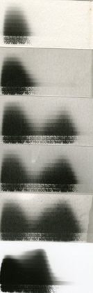

Ok, here goes. Here is an AgBr emulsion, doped and then spectrally sensitized. I have since reduced the fog. This is about equal to MGIV in sensitivity and speed and about 1.5 - 2.0 in contrast.
PE

Alright!
The top is the raw emulsion. The next is the doped emulsion, which became more foggy. I have since controlled the fog. #s 3 - 5 are levels of ortho sensitizing dyes and the bottom item is Ilford MGIV at the same exposure level to show relative speed.
These exposures were using a Bausch and Lomb monochromator in a device called a spectrosensitometer. It is used to measure the H&D curve as a function of spectral sensitivity. I have one on loan in my DR right now.
PE

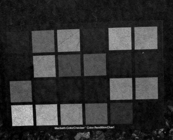

This is from a 2 1/4 x 3 1/4 paper negative shot in a Polaroid holder in a Polaroid back in my RZ 67.
PE
