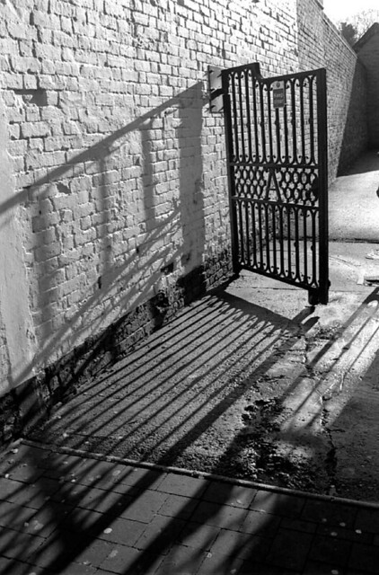

I was given about 10 cassettes of Agfa Scala 200 together with a load of Fuji Sensia 100 and Sensia II --- NO DATE so I guessed and rated it at 100 ASA and tried home-made ID11 formula 1+1 for 12 mins and got a perfect result and won and award for this photo at my Club printed on Ilford Multigrade IV Glossy ---
Scala 04 by Peter Elgar, on Flickr
