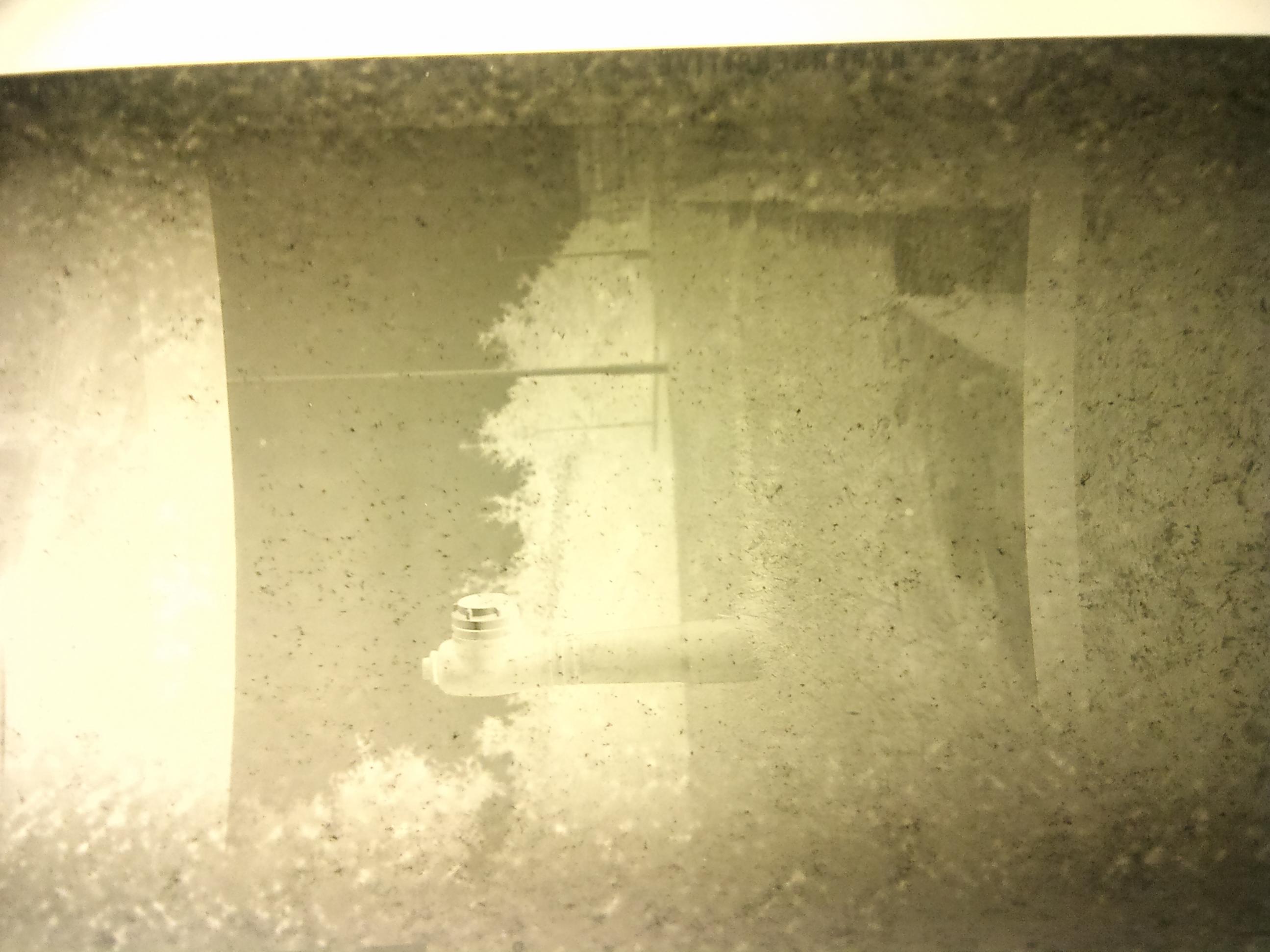

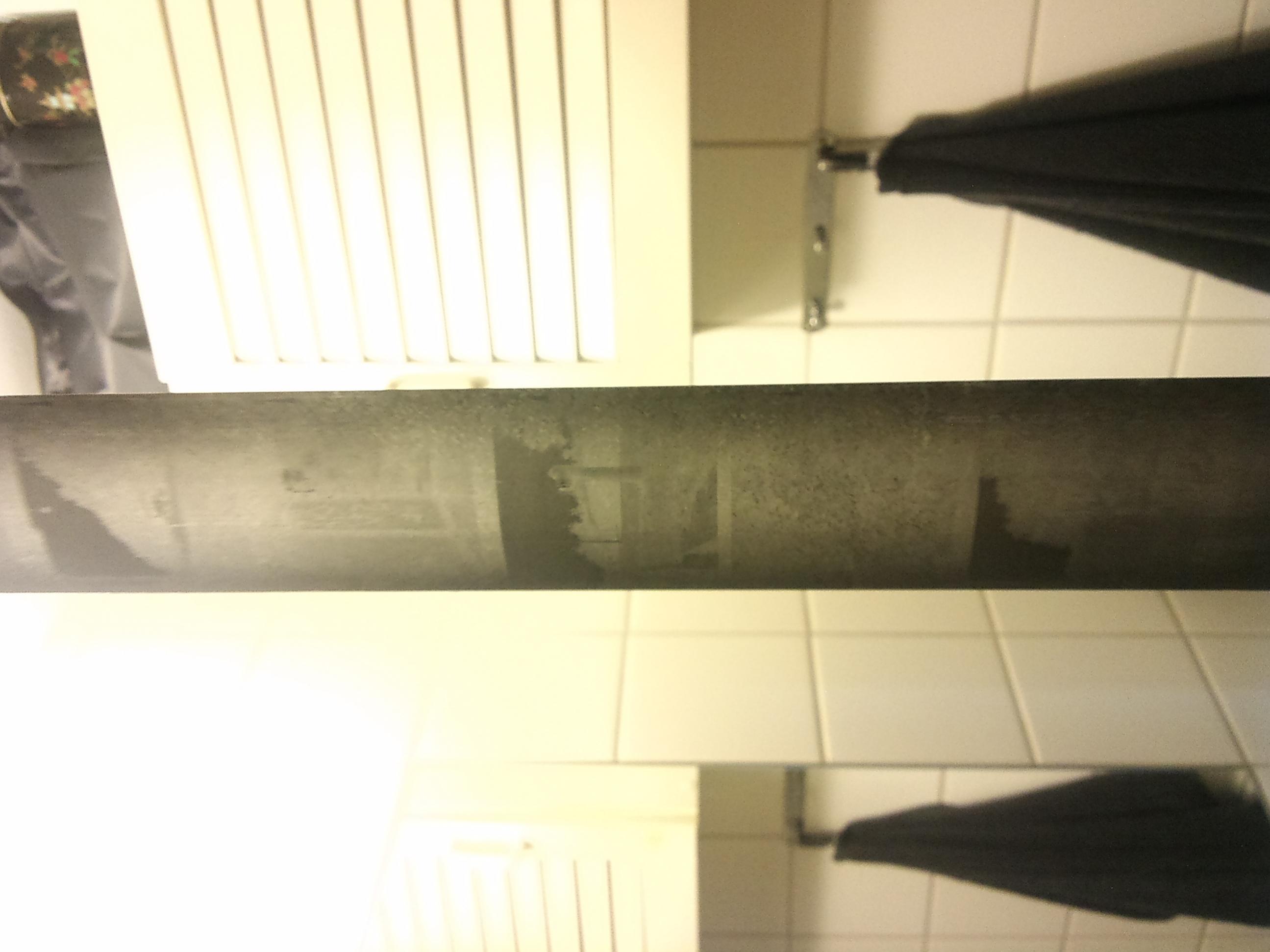

Thanks to everyone for making suggestions on how to do this.
I ended up trying hpulley's suggestion.
The results was pretty much as I expected.
HORRIBLE! :smile:
But I don't mind that. As I said, that was what I expected!
One funny thing though, is that it seems the emulsion is sort of peeling off the film!?!
I guess it has been stored in a drawer or something like that for probably around forty years or so, resulting in this strange phenomena.
Of course, I knew when I loaded the camera, that this film might not turn out at all!
So I didn't use it for anything important, just a fun little experiment.
Still I think I'm going to making a print or two, just to see how it will be!
Another little challenge in the darkroom!
Here's a few pictures of the film (taken with my cell-phone..) :
Simon R Galley
Nov 2, 2005
2,034
Cheshire UK
Dear..Dear...
Just caught up with this thread...
This film could well be over 40 years old, I see you got something off it so well done.
As always the advice was good I would have said rate it at 100 iso and dev for 12 mins in ID11 / D76
As you say it was just a bit of fun...so fine...
Simon

Thank you!
Actually I rated it at 400 to start with, but then someone here suggested that I rated it at 100 instead which I'm sure has a lot to do with the presence of an image at all!
