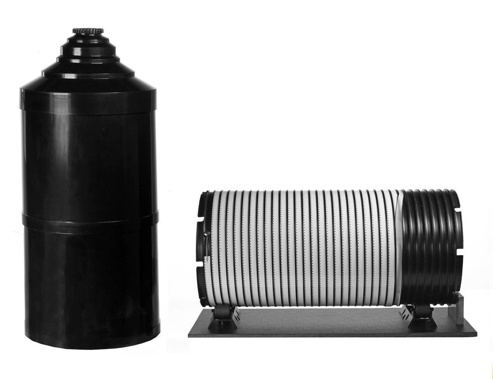

I've been developing my own film for 48 years. In that time, the most evenly processed negatives to come out of those efforts were sheet films in Jobo Expert Drums. No matter what method I use (except letting a lab employ its dip-and-dunk system), my 120 results have never achieved the same degree of uniformity, a shortcoming very evident in areas of even tone such as sky.
Jobo now offers a Super 8 Expert Drum kit (shown below) that triggered an idea. Would anyone be interested in a similar item that was designed to process 120 film? Based on a crude mockup, I don't think the outer drum would need to be much larger than Jobo's existing 3006. Please share your thoughts. Thanks in advance.

If you or knowledgeable others have the time, can you say what it is about the Expert Drums that ensure this evenness which the conventional 120 Jobo drum and reel does not?
I know we have seen threads recently that have been deliberate challenges. This is not one of those. I am trying to extend my knowledge of what Expert drums do.
Thanks
pentaxuser

...can you say what it is about the Expert Drums that ensure this evenness which the conventional 120 Jobo drum and reel does not?...
Jobo's explanation was always that Expert Drums' performance with sheet film is a result of completely random continuous agitation. I have no basis to agree with or dispute that reasoning, only experience with sheet film that empirically demonstrates the result.
I have 120 Jobo reels/drums from both the 1500 and 2500 series, Paterson and Jobo tanks, as well as Kindermann stainless tanks along with Kindermann and Hewes reels. With all that equipment, no matter the protocol followed, be it rotary on a processor, inversion (many, many variations), fill through the light trap, drop loaded reel into developer in the dark, pre-soak or no pre-soak, nothing approaches how even sheet film in an Expert Drum is developed. Only commercial processing in a dip-and-dunk line has achieved similar uniformity for me with 120 film.

Thanks Sal. How does Jobo achieve this random continuous agitation? Does random mean that there is a programme that ensures that the number of backward and forward turns alter continuously as opposed to my Jobo CPE2 which has a backward and forward cycle but this is a set number of turns each time or are the back and forth cycles set but some structure within the Expert drum somehow sloshes the developer randomly around the drum?
I am having difficulty getting my head around this.

Sal Santamaura
Nov 21, 2005
7,535
San Clemente, California
...How does Jobo achieve this random continuous agitation? Does random mean that there is a programme that ensures that the number of backward and forward turns alter continuously as opposed to my Jobo CPE2 which has a backward and forward cycle but this is a set number of turns each time or are the back and forth cycles set but some structure within the Expert drum somehow sloshes the developer randomly around the drum?...
There is a set number of turns in each direction; that's not what 'random' refers to. Rather, the hydrodynamics of liquids inside an Expert Drum apparently sets up random flow over each sheet, probably due to movement within and between the chambers. Here's what it looks like:
To reiterate, randomness was Jobo's explanation. I'm only vouching for the results, not the mechanism. :smile:

pentaxuser
May 9, 2005
20,328
Daventry, No
Thanks Sal I wasn't aware of the video although I have to say that even at slow motion it wasn't clear to me how the liquid's flow was really different to the kind of flow I envisage in a 120 or 35mm Jobo tank but if that is anyone's fault it is mine and not yours.
pentaxuser
pentaxuser
May 9, 2005
20,328
Daventry, No
Think directed flow around and through the reel, including its core, radial parts and channels. Distinctly non-random.
Thanks, that explains it well. It wasn't apparent to me this was happening but I can at least see how it works in my mind's eye compared to a reel inside a drum.
pentaxuser

Also, the way the expert drum holds each sheet of film almost against the outer diameter while using almost no lip on the edge that runs full width means that there can be no surge between the spokes of a reel, for example.
I think that this would be very difficult to duplicate with an entire roll of 120 without using a tube as long as the film itself, or to corkscrew the holding edge and make loading the thing a nightmare.
