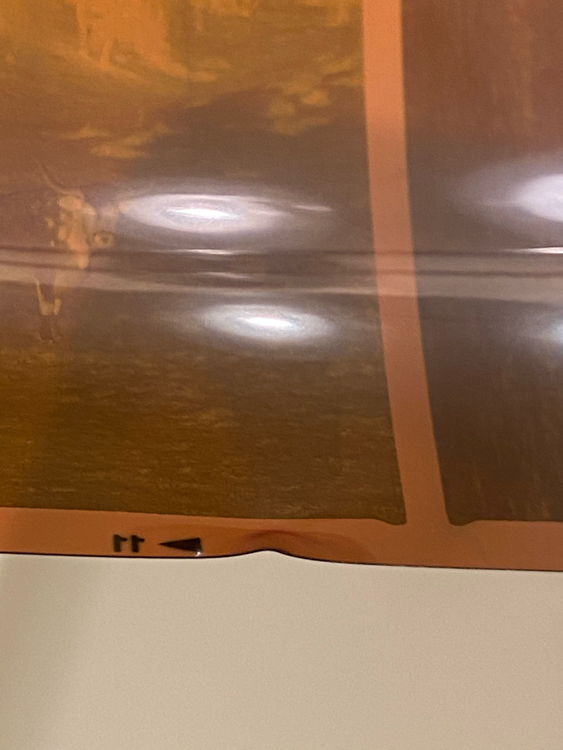

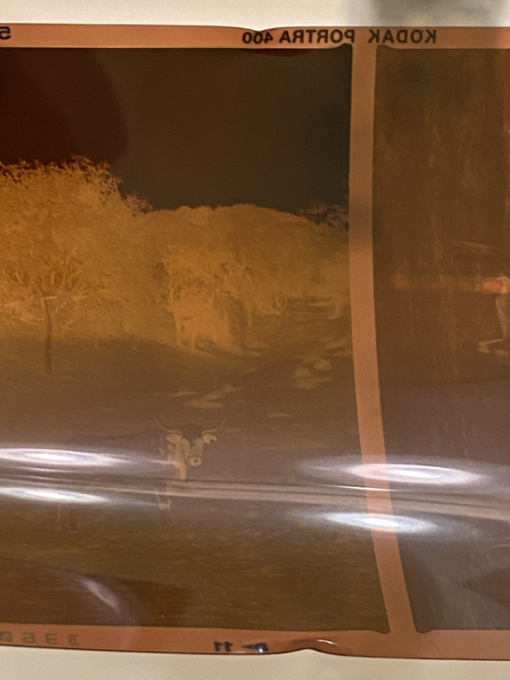

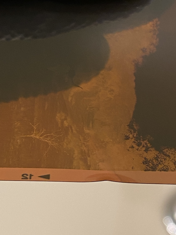

Hi all. Another question about hand processing color in my 32 ounce stainless steel tanks (mainly using Arista Press Kits at the moment).
I've been experiencing these deep dents in the film with every roll. I'm practicing constantly with my rolling as one commenter suggested a week ago but not seeing what I could be doing wrong to cause the issue. The rolls go on with no problem, don't seem to stick together to block development, or anything like that, so wondering if it's something else I'm doing wrong.
After agitation, do you all tap/bang the tank to get rid of air bubbles? In the instructions with the press kit there's no mention of this, and in the video tutorials I've watched they didn't do this, either. But there were invariably comments in the comment section criticizing them for not doing so. I have been using the polished concrete floor to tap the bottom of the tank. I'm not slamming it aggressively or anything like that, but film being gelatin heated up to 102º loaded onto a stainless steel reel, I'm wondering if my tapping it may be causing the damage.
Any advice on whether to tap or not to tap? Is it necessary? Could that be the culprit? Would skipping that step lead to air bubbles in my chemistry?
Thanks!

Tap for air bells [air bubbles]. The dents have something to do with the film getting caught in the grooves. A suggestion: As you wind the film on, if you feel the edge of the film on one side is a little higher than the other rounds, you have something wrong with the way the film is sitting on the reel, then unwind and rewind until the edges of the film is even. You should be able to smoothly pull the film forward and back.

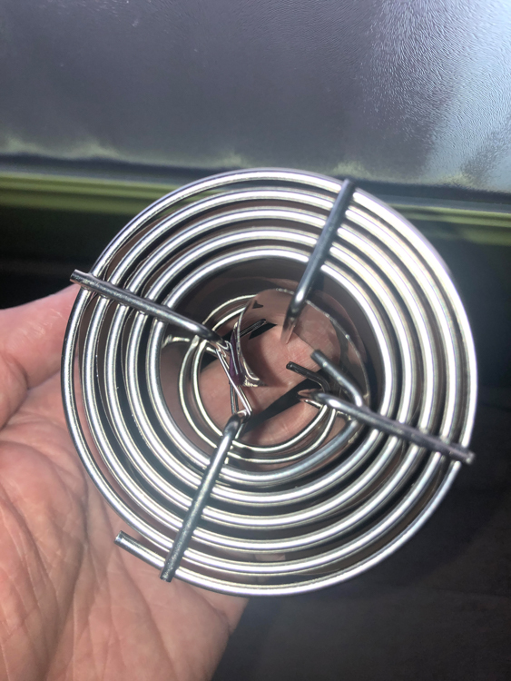

Can we see a close-up of your reels, both empty and with some film in them?

I cannot see how tapping on the bottom of a SS tank can cause what you are seeing. I can see no way you can tap the tank hard enough to cause an issue with the emulsion. Tapping as you have discovered eliminates the possibility of air bubbles sticking to the film thereby stopping developer getting to a small part of the emulsion and is a precaution that is IMO well worthwhile
It does look as if the loading is the problem but quite what you are doing when loading I cannot suggest. Unless you are an experienced SS reel loader then I'd practice with a film you are prepared to waste and check carefully while you do this what is happening with the film

It always feels like it goes in, no problem, and there's always that little "shuffle" back and forth if I give it a little tug to make sure it's not snagged somehow. Can't figure out what the heck I'm doing wrong. Going to add more photos now.

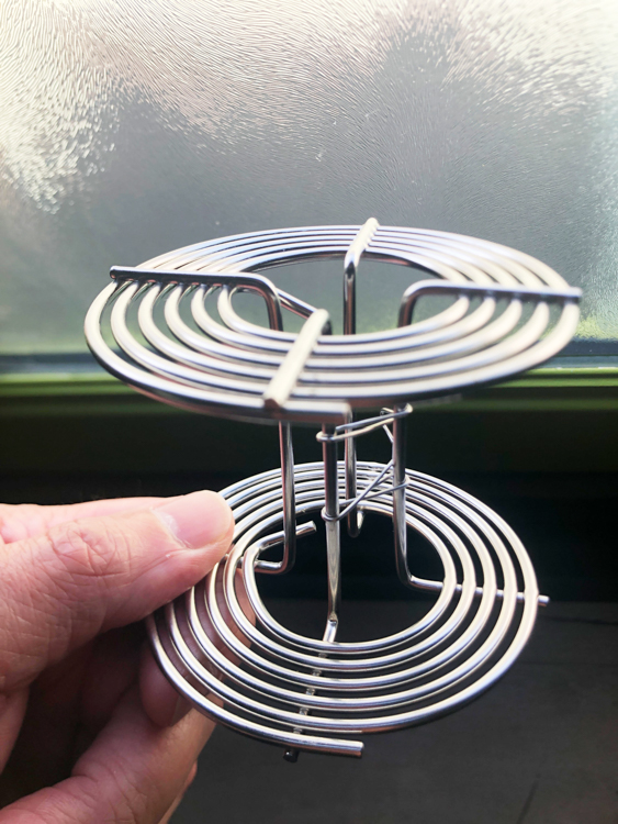

I can see that it's the crossbars that run along the top that the film is crimping over, but that seems to be the way all stainless steel reels are designed, so not sure why these would be different? You can easily see the film bending at the crossbar. Not sure what the story is.

I'm using Arista reels - maybe I need to upgrade to Hewes.
If you got them from FreeStyle, have the receipt and it has not been too long, they will give you your credit for them to trade for the Hewes reels.

I'm wondering if your reels are bent. The film should fit between the straight side spokes and barely contact them.

Oh, okay...I wonder. These are definitely making contact, and when I flip them over they are making contact in that way on both sides. If you look at the one shot that shows the full neg you can see it's dented on both sides, otherwise I'd just chalk it up to being inexperienced and jamming it too far to one side and it not sitting evenly between both.

Make sure the film is gently cupped length-wise as you load it in, that will help. If you feel resistance, back up (pull some out) then continue.
I had similar issues with one stainless reel, and it turned out it was very slightly bent. It was very difficult to see - it wouldn't roll straight and I also confirmed with a straight-edge. Just a little bit caused it to bind after a few wraps of film.

I ordered some Hewes reels, there's a lot more play from left to right and I realized the Arista ones were definitely bent. Super cheap and flimsy.

I just got some much sturdier, higher quality Hewes reels so we'll see how it goes.
Truzi
Mar 18, 2012
2,656
I have a few different brands of reels. If straight and true, all are serviceable. However, the Hewes are great - they practically load themselves, and are quite robust. I still use plastic reels on occasion. It took a bit of practice to get the hang of loading the steel ones, but then I started to prefer them.
