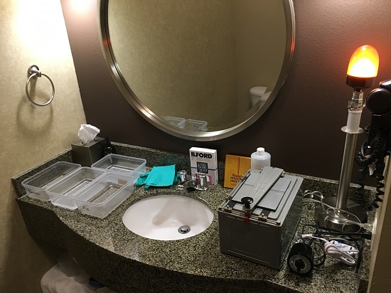

I have developed a lot of film in hotel rooms, I've even turned the bathroom into a darkroom to make contact prints. One of the main reasons I came up with my recipe for Beerenol was for developing in hotel rooms. All of the Beerenol ingredients are usually available locally, the hardest to find is ascorbic acid powder but I can easily take that with me.
The hardest part is the fix. I even tinkered with fixing in saltwater but that just takes too long. As Relistan mentioned above, the ADOX powdered fix is a good option. There are also the Tetenal Super Fixer Tabs. One that I have used is the Ilford Simplicity Fix. It comes in 100ml liquid pouches that are small and easy to pack. It makes 600ml of fix that can be used for several rolls of film. Taking the whole Simplicity Starter Kit with you would be a great option. It has developer, stop bath, fix and wetting agent all in a small package.

Here's my hotel darkroom setup for making contact prints. I drove to this location so I was able to pack a bit more than I would flying.
