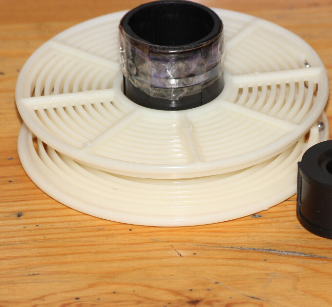

I used a Yankee developing tank, it's reel can stuck in between 35mm and 16mm only need strip- I didn't break it.
