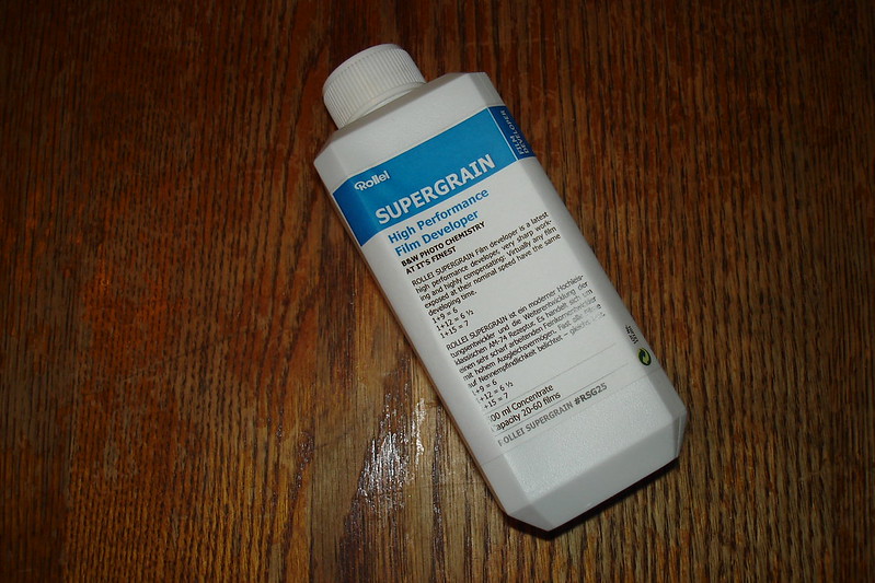

I processed this film in Rollei Supergrain dev that I got from Freestyle.

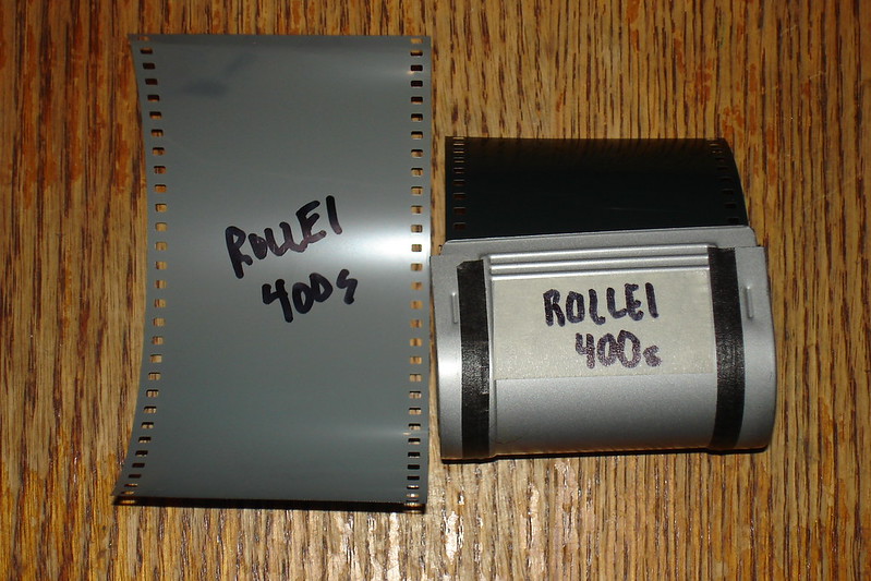

Two rolls of 70mm Rolle 400s. Arrived to me from Maco in Germany
Hi Gorbas,
No it is fresh 70mm Rollei 400s film stock, but you must order it from Maco Direct in Germany. I just ordered a couple of rolls and it cost me about $100 per roll including shipping. Each 100 foot roll will yield about 500 6x6 exposures. Shipping to me in the USA was amazingly quick. They tell me they have several hundred rolls in stock. If you have a camera that takes 70mm film I would load up if I were you.
