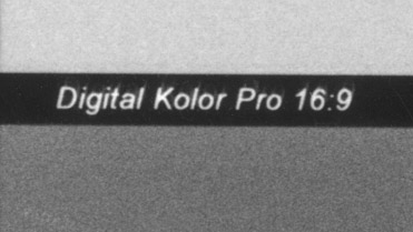

I've been returning to the darkroom after 10+ years away, and processing 120 for the first time ever.
In the days of film the B&W printing was more of a "utility" thing for me, my work was all commercial stuff, E6 for the most part. Now I'm shooting a lot of test charts, trying to settle on film, developer, time, & ISO for a project where I want some grain. 35 has been fine, but the 120's been a little challenging.
Here's a scan from a 1-hour stand (couple inversions at 30:00), a process many people have posted as their go-to. I got some odd streaking in areas of high contrast:
(I've enhanced that a bit). I understand this to be (insert technical word for "you didn't agitate it enough"). That's fine, the negs from stand have looked a little flat and the blacks were pretty weak, at all the reasonable brackets. Moved on to standard processing times, agitation and temps.
I'm seeing this though, on the negs and the prints (so it's not an enlarger issue). It looks like it could be camera shake, since it's real specific... these were shot at 1/30th with an old RB proS.
If you look at the "D" and the "P", the open spaces in the letters are open in the ghost image - seems like streaking from processing would be less distinct? Or in this image, the shape of the white box is very distinct, as are the straight lines on top:
Could that be processing or something mechanical? I'm thinking of running a pack of polaroid through at various shutter speeds - may be too small to see in that case though, but that would be pretty quick and FP3000 does hold some good detail.
Other than that, I've found a speed & processing setup that's giving me a wide gamut, deep blacks and a good tonal range - on the negative. I'm using a digital color test strip (all I have right now - it has 11 chips from black to white).
On the negs, every square has a distinct tone, from solid black to pure white - on paper (grade 2) the last two whites are coming out the same (that is, the 2 brightest tones are both printing as white - does paper simply have less tonal range than film? At this point I'm trying for a full tonal range on test cards with a grade #2 filter.
Paper: Ilford MGIV RC (Because it's cheap - I seem to be blowing through a lot of paper & film...)
Film: HP5+
Dev: Rodinal
Thanks guys, for any thoughts.

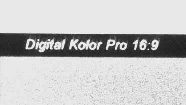

Thanks guys - but to clarify -
The first image was 60 minutes, with agitation at 30 mins. - what some people are calling "semi-stand". I've found numerous posts (with scanned examples) where people use this with Rodinal successfully, many of them considering it their favorite process. I've used it on 35 and gotten some nice results. I felt it looked too flat. (And as I mentioned above, I felt the streaking came from lack of agitation). (And for 35, I like how the semi-stand can work to tame contrast). I'm quite willing to try about anything (HP5+ in Dektol paper developer is really kind of cool, for instance).
As I mentioned in the OP, I went to a more "recommended' or standard method - the 2nd two images were done as follows:
Rodinal 50+1, 20c;
11 minutes (film rated 400);
Agitation 1st 30 secs; 5 seconds every minute; and final 30 seconds. 8 seconds to pour.
Agitation:
My tank can take 2 35's or 1 120 reel; I need to make a spacer to keep the 120 reel at the bottom of the tank (so it won't pump up & down). Instead of inversions, I swirled the tank - sort of an almost-complete inversion. That's something I've done for years (when the lid of my older tank leaked too much to fully invert it). I do this for 5 seconds every minute. Though the reel doesn't go fully upside-down, I feel like it's getting plenty of agitation. But no air hits the film this way, as it would with an almost-full tank being fully inverted.
My main question was more of "can processing errors produce something that looks more like a ghost image than a smear". I can't think of a way that it could.

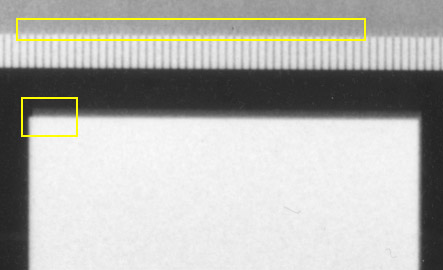

I took a liberty of downloading your second image, import it, enhance the contrast, and manipulate the tones. I can clearly see the letters doubled. It's a shake of some kind.
I am not certain what your first image is showing. But, I can fairly confidently say, your second image is showing camera motion during exposure.

What you have is a classic case of bromide drag. This is the result of underagitation. It can also be caused by the wrong developer for the conditions.
Bromide is an antifoggant and is heavy so it drifts downwards and restrains the development in a path down from dark areas. OTOH, some development byproducts either speed up or slow down development and they too can alter development in ghostly patterns. Agitation disperses any and all of these byproducts and prevents them from causing the marks you are seeing.

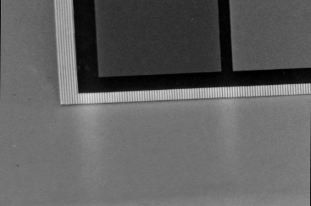

But images 2 and 3 - I had trouble wrapping my mind around bromide drag "printing" such a sharp image. Got out the polaroid back and some FP3000.
That particular lens does indeed have shutter issues that will require hospitalization. Sticking open too long or staying open until the shutter is re-cocked. (Anyone know a good Mamiya repair guy??)

If i was the lens, then redoing the test without stand development should reveal that problem clearly.
If you shoot with another camera and use the same stand method, then if you have the problem it is bromide (or chemical) drag. And yes, it can appear quite sharp, especially with larger formats.

I'd say the first frame I posted, from the stand film, was bromide streaking - and this test was shot with a different lens (90).
My guess is the 2nd two, which were developed "normally" (11 and 15 minutes) were the shutter (a 180 which I hadn't used in a decade and is most decidedly messed up; just ordered another one from KEH). That lens was such a dependable favorite for so long, it took a while for me to consider that.
I've done several rolls of 35 with the same "semi" stand technique and no trouble though; I was impressed with how much separation it gave between the shadow tones; highlights were pretty flat and overall I felt it would have taken a pretty hard filter to print. I wasn't thrilled enough with it to keep playing with the process - but it was a really useful part of trying to build some "second nature" thinking about development and highlights.
