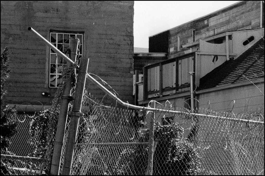

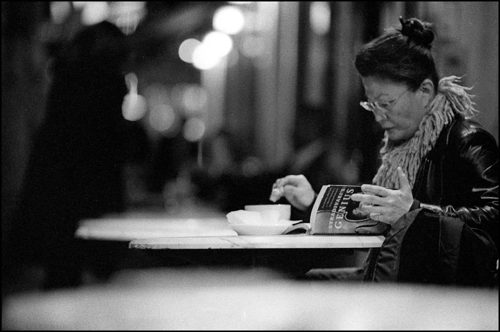

Nothing happened. Everything turned out fine. Can't really tell the difference.
This was a screw around roll, as I don't normally use telephotos, not to mention shoot at EI3200 in the daytime - so I decided to combine D-76 and XTOL and see if it worked. Grain is a given, it's TMZ.
Canon EOS 1V + EF 135mm f/2L, Kodak TMAX 3200
125 ml Kodak D-76 + 125 ml Kodak XTOL + 250 ml tap water.
18.5min @ 20C, 30sec initial, 3/30sec.

TMZ was just what was in the camera I used for those shots (the night ones were taken previously).

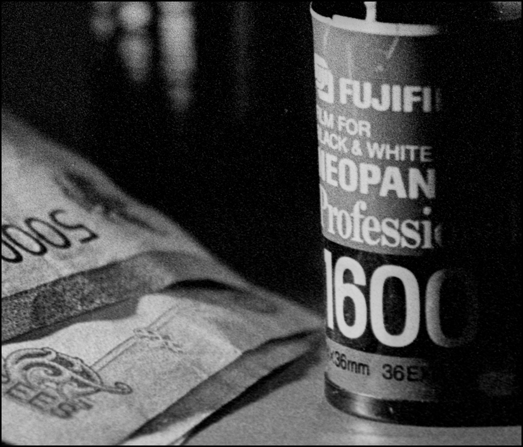

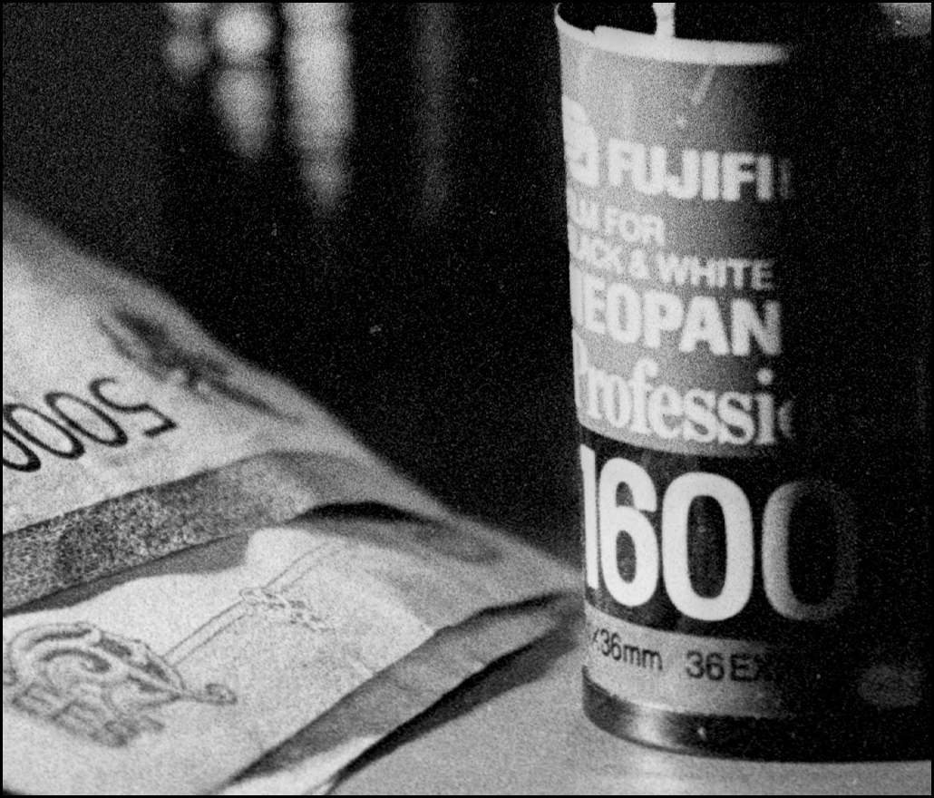

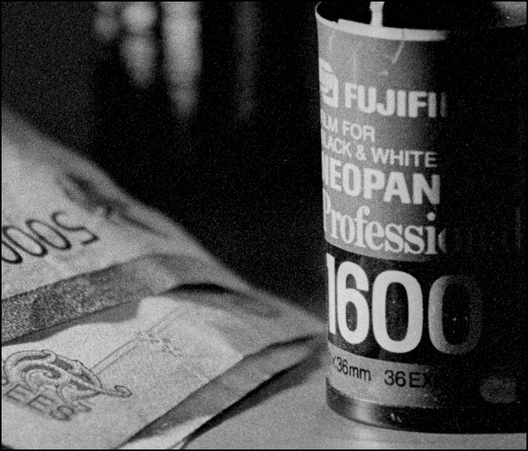

I was able to split a roll into 4 and develop in XTOL 1+1, D-76 1+1, D-76+XTOL 1+1, and D-76+XTOL 1+0 (straight). The only adjustments I made were to shift the black point slightly to bring base fog down, which by the way - and this is notable, was definitely higher with all frames that were processed in XTOL 1+1 and any combination of D-76+XTOL. In fact, D-76 1+1 had lower base fog compared to XTOL processed frames.
All shots were 135mm, f/4.0, 1/200sec. Agitation was continuous in the initial 30 sec and 3 per every 30 sec period. Unfortunately I don't have a tripod on-hand, so subtle softness differences might be apparent.
Some things were reaffirmed: XTOL appears to have more refined grain and sharpness and expose slightly more shadow detail than D-76. D-76 drops off sooner, and at least to my eyes, yields higher contrast (in a pleasant way). The combination of D-76 and XTOL produces something that feels in-between, and the undiluted combination of D-76 and XTOL looked to be similar to the diluted combination. Although the undiluted mix does appear "hotter" one caveat is that while the rest were developed at 19C, the undiluted mixture was developed at 24C (since I didn't chill my chemicals) - so for comparison sake it might just be on it's own.
Process info:
1. Fujifilm Neopan 1600@1600, 200 ml XTOL, 200 ml water. 8:00@19C.
2. Fujifilm Neopan 1600@1600, 200 ml D-76, 200 ml water: 9:30@19C.
3. Fujifilm Neopan 1600@1600, 100 ml D-76, 100 ml XTOL, 200 ml water: 9:00@19C.
4. Fujifilm Neopan 1600@1600, 200 ml D-76, 200 ml XTOL, 0 ml water: 5:00@24C.
Canon EOS 1V + EF 135mm f/2L, Fujifilm Neopan 1600, Kodak XTOL 1+1
Canon EOS 1V + EF 135mm f/2L, Fujifilm Neopan 1600, Kodak D-76 1+1
Canon EOS 1V + EF 135mm f/2L, Fujifilm Neopan 1600, Kodak D-76+XTOL 1+1
Canon EOS 1V + EF 135mm f/2L, Fujifilm Neopan 1600, Kodak D-76+XTOL 1+0

Some 100% crops:
Like I said before, it seems apparent to me that XTOL is technically a better developer than D-76 - but that doesn't mean I'll use XTOL 100% of the time as I like D-76 (especially with 400tx). It also seems very ambiguous to me if the blend is working as a blend or if one is outdoing the other. It does seem like the shadow detail in the D-76+XTOL is somewhere in between D-76 and XTOL (the "Professional" and "1600" writing on the 135 can) but other than that it seems like things are extremely similar in general. I don't normally find a need to break out the scientist suit and electronic microscope, but it's been interesting as an experiment and if anything does reaffirm some XTOL vs D-76 observations.
