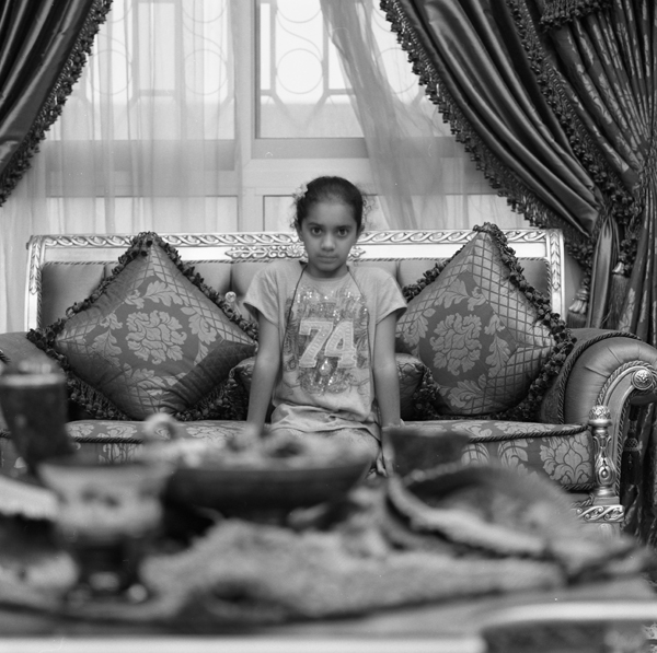

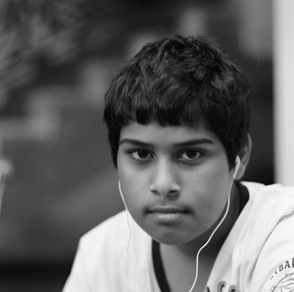

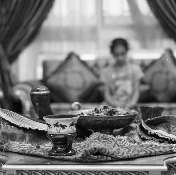

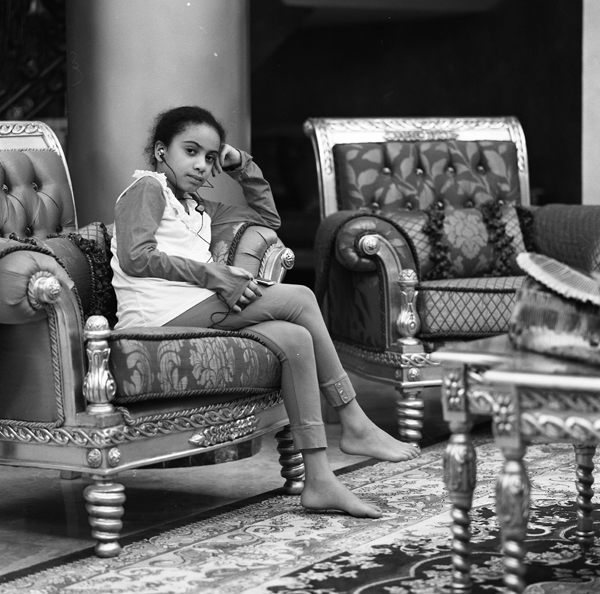

Here are few shots from the roll, direct sc..... no adjustments, what do you think???

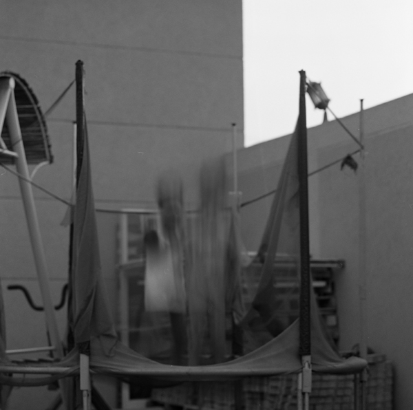

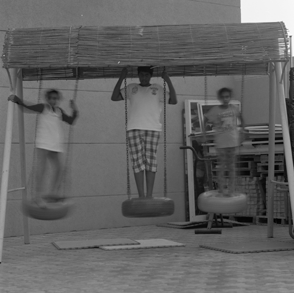

Too bad i did shoot at late time of the noon where i was using slow shutter speed, so blurs are there, also the focusing with Hasselblad is not spot on as with my Mamiya RZ, even GSW690 better in focus and easier than this Hasselblad.
The negatives seem to have scanned well - with maybe a little bit of loss of shadow detail.
The mid-tones look good as does the contrast.
It could be that your developer has lost some of its activity.
I like the photos.
I like the photos.

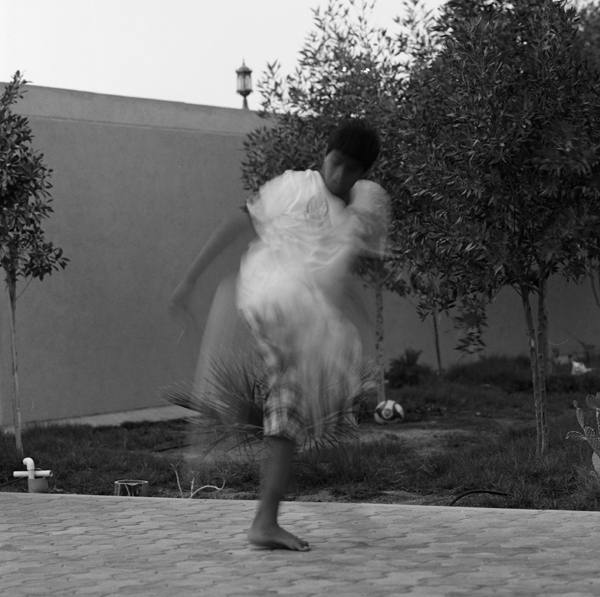

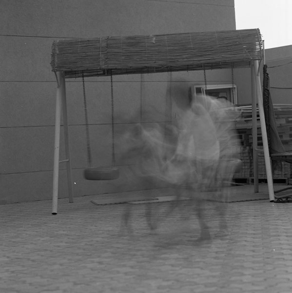

As i said, i didn't adjust the scans, i do adjust for the shadows or highlights, adding sharpness, contrast,..etc, i did nothing, just resized out of the scan and uploaded, if you want i can work on any show of those for better, but i just posted to see if the development/processing went fine and the developer is still working.

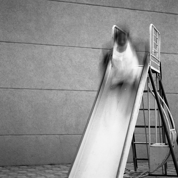

Here are more shots, i excluded 2 shots from the whole roll because not interesting shots, those shots here are outdoor, playground in our backyard of the house, and because i was using slow shutter speeds i thought to show movements of the kids, what do you think about the exposure [direct scan no pp], and does the development went fine? Just wondering why the roll look thin comparing to another rolls!!!
