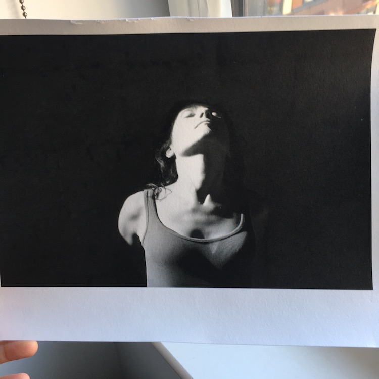

@Doremus Scudder thank you showing your experience. Recently, I achieve the amount of 10 prints before the final one. This is a bit frustrating either for the time and the paper wasted (i have used ilford art 300). The reason was because it has part of high light and dark part, as you can see:
The smartphone doesn't give justice, but behind her there is a wall texture.

What gizmo is going to help with a print like the one you show in #10? Each test strip needs to include part of the highlights...
I haven't adopted the practice myself yet, but I sometimes wonder if just generally printing a little dark and bleaching back isn't the way to go. Could save a lot of paper.

@grain elevator
The photo posted is no yet bleached or tuned by selenium.
If you do a darker print and clean by bleach you are doing a flat and homogeneous work. The print is not just a replica of the reality, is also, a way to express your art.
Obviously I did the test strip print for that photo involving on the same strip high light and shadows. At the start I was wrong to find the correct contrast and exposure, because I didn't want the black shadows close back her.

@grain elevator
I don't understand this part of your reply. Flat and homogeneous? It depends on the bleach, but the most common ones start working from the highlights, so they increase contrast. And more contrast = more art??
I only said, if we follow your suggest, to do a bit darker the print and after to bleach it, it sounds like we are going to do the same process and get the same result. In this terms I used to say homogeneous.
