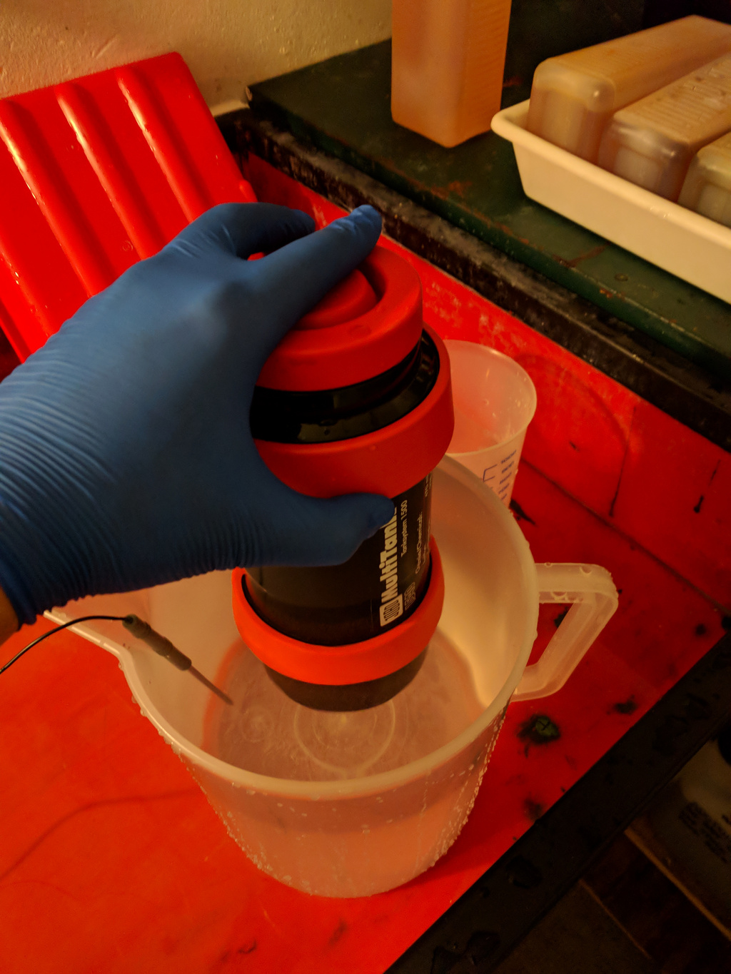

I've been experimenting temperature control without using my jobo processor (which is dead again). My idea is to basically imitate the tempering bath with a big jug of water that I keep at 38 degrees (as you can see from the photo).
I did some tests with E6 and I could not really keep the temperature of the chemicals stable at 38. When measured after pouring out from the tank, it was more between 36 and 36.5.
My process is like this:
* Bring all the chems to temp in a big tray
* Make my 5L jug at 38.3. I stir to make sure the water is not stratified and there are no hot/cold spots
* I keep a recipient full with very hot water, which I drop into the water bath if it drifts under 38°.
* I did the preheat with only water to make sure the tank was at 38
When I'm ready to pour the developer:
* I make a dedicated hot water bath and immerse the bottle. I continuously stir the developer to make sure it is 38.0 spot.
* When this temperature is stable, I pour it into the tank.
* Tank goes in the water bath (which I keep to 38.3) and I agitate following instructions.
When I poured out the chemistry for FB, CD and Blix it was always around 36! Is this the expected outcome? Can the temperature drop so quickly when pouring it out of the tank?
I thought my process was quite fail-proof but evidently is not... and I ended up with 4 yellow films

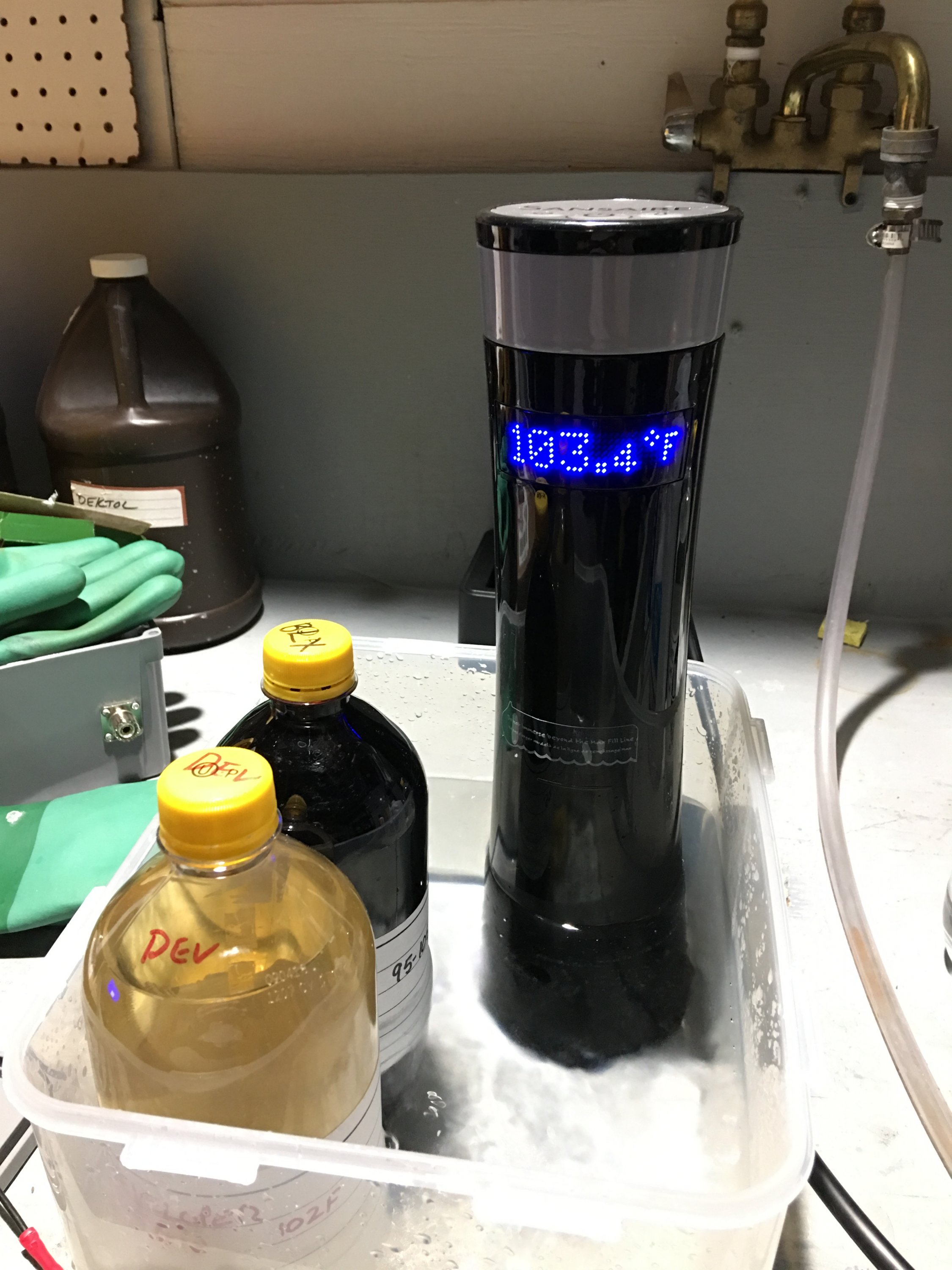

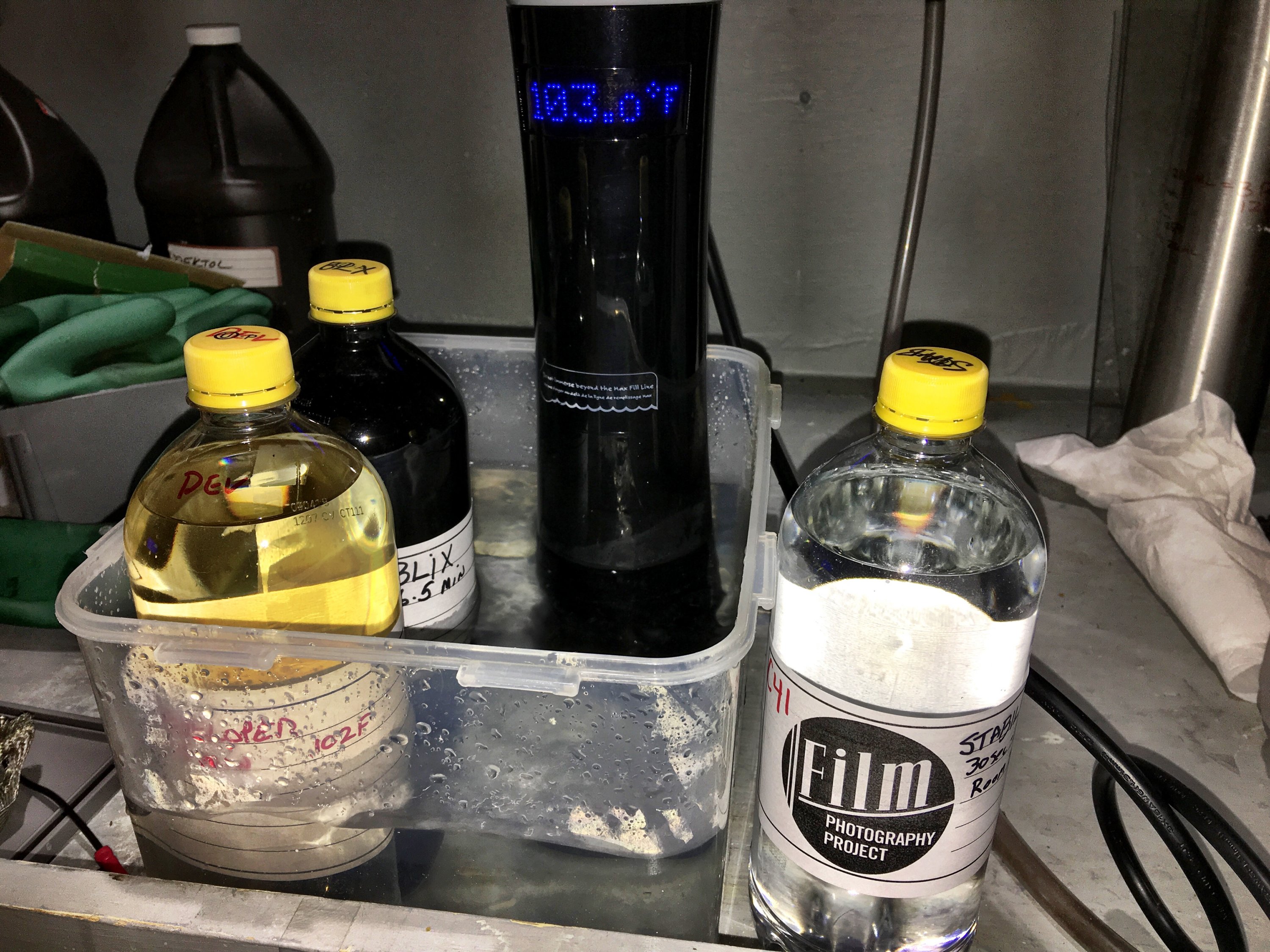

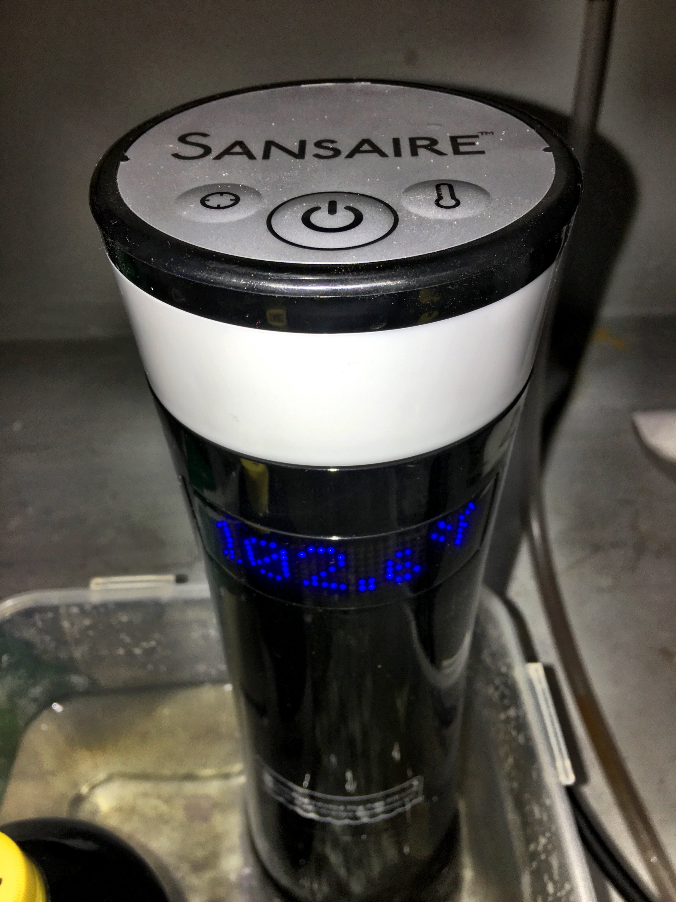

I am using the Sansaire Sous Vide water heater. So far so good. I use to use a bucket of hot water and hoping everything would work.
koraks
Nov 29, 2018
22,612
Europe
OP, your jug looks a bit small. Try a bigger tub so that its temperature buffering ability is larger. With a small jug like you're using you'll see much more temperature drift than with a much larger volume. Try a water jacket with a capacity of one or two gallons instead of something like a quart.
