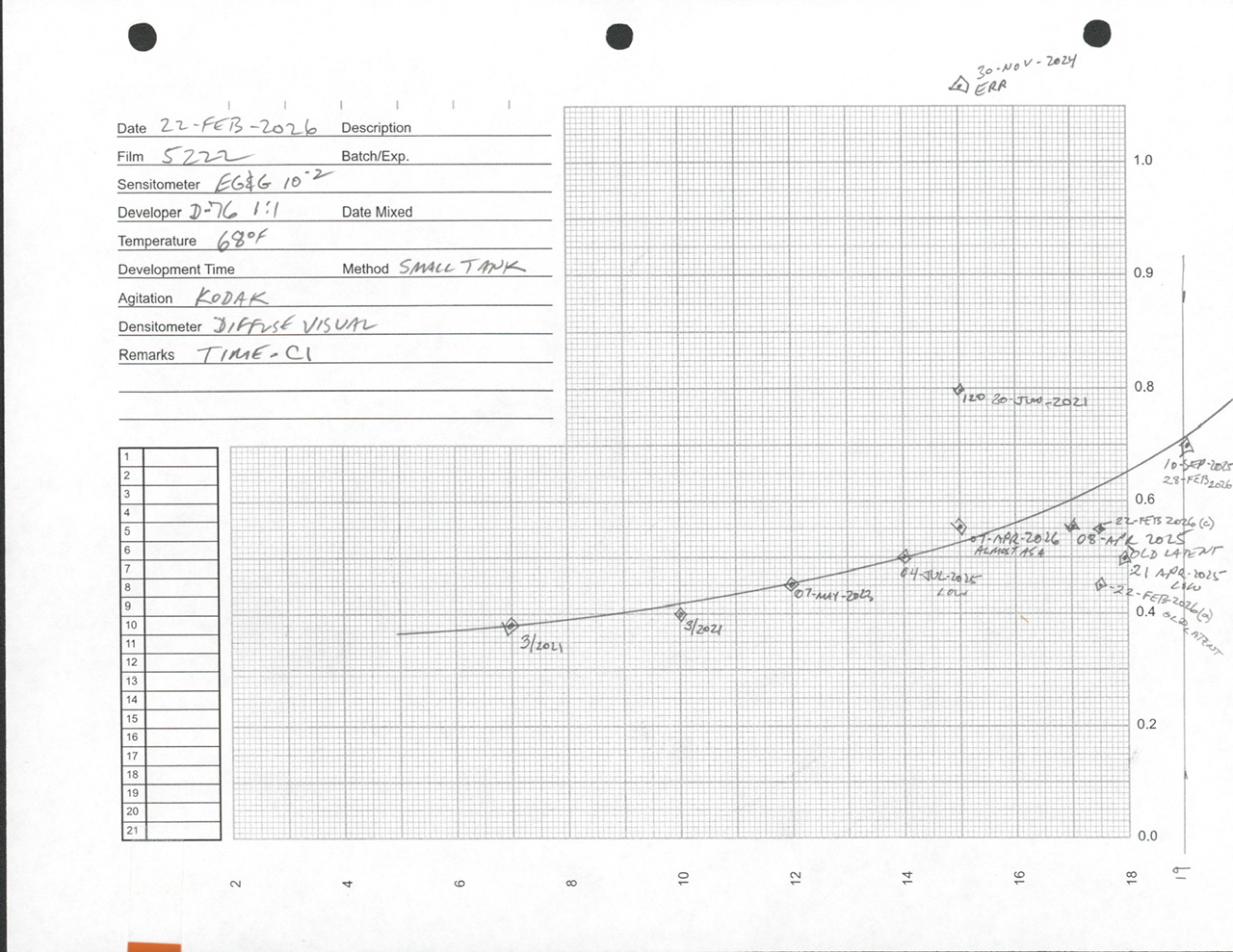

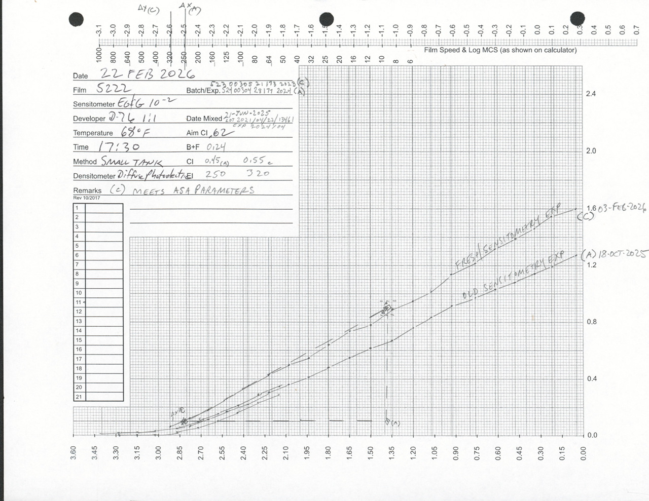

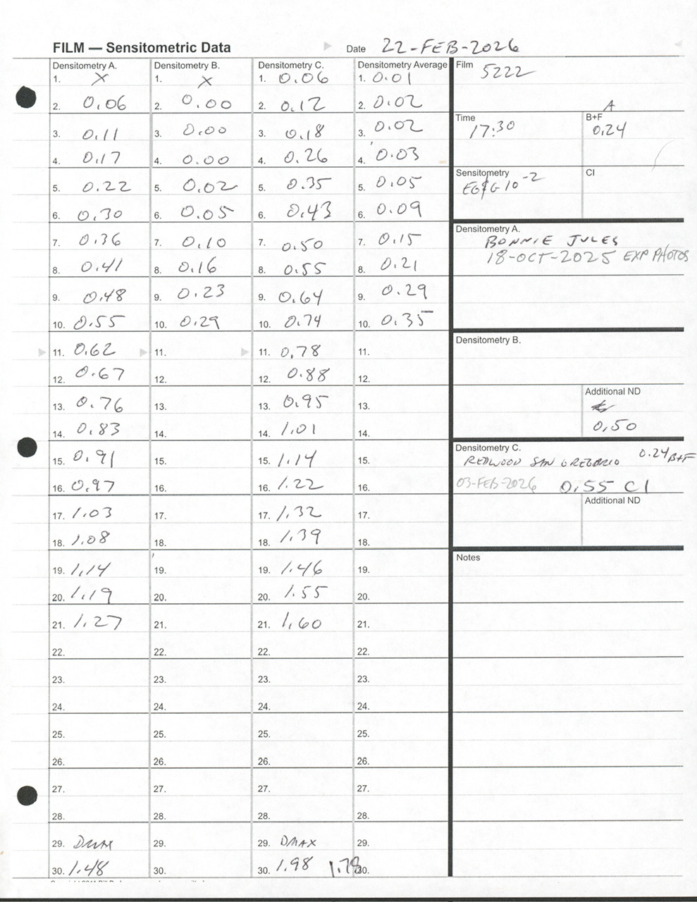

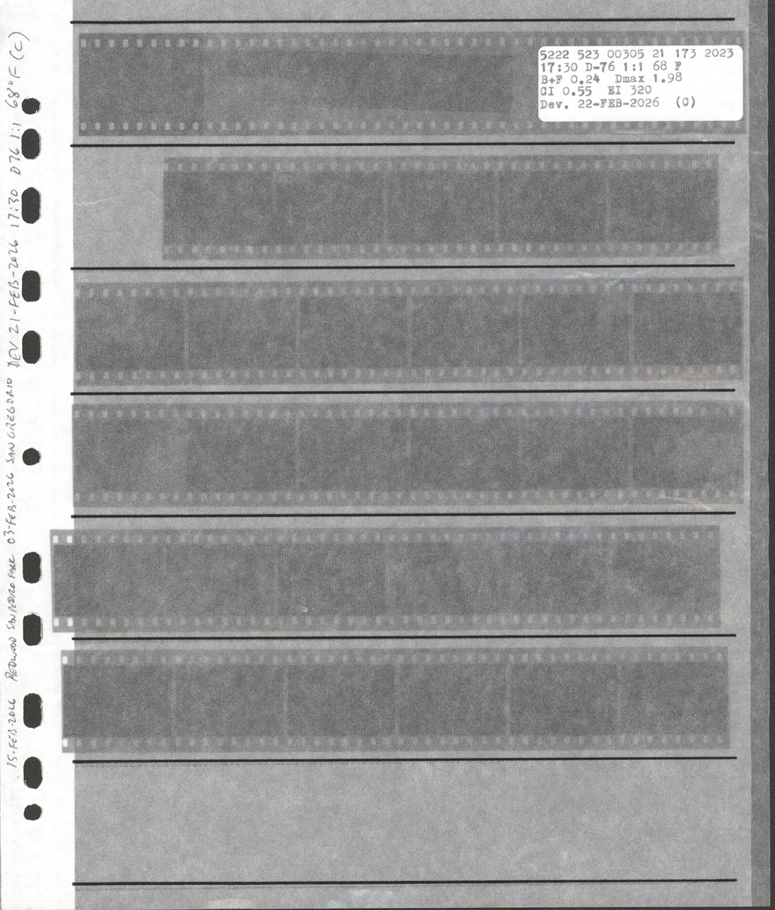

Last month I caught up a year old backlog. I graphed different speed and contrast from the same film developed in the same tank for the same time. I checked old notes and saw the same. Times when I struggled to reach contrast aims, the latent images tended to be older.

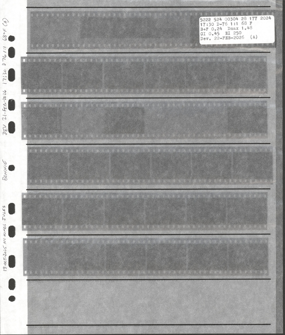

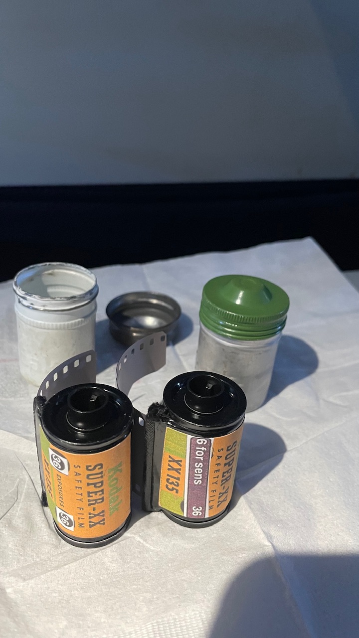

When I load cassettes from bulk rolls, I will place sensitometry exposures on the leader of half the rolls and mark “6 for sens” as a reminder to wind past 6 before shooting (the other rolls will have a full 36 exposures).
Naturally, pre-exposing test strips causes old latent images for sensitometry if you don’t develop promptly.
Sometimes I’ll pull a length from the bulk loader and expose a fresh sensitometry strip to put in the tank. For example when there’s room for another reel because I only have a few rolls to develop, or if none of the rolls has a test strip on it already. These will be fresh.
In those examples a tank can have an old and a new sensitometry strip of the same film and when graphed, will reveal different speeds and contrast.

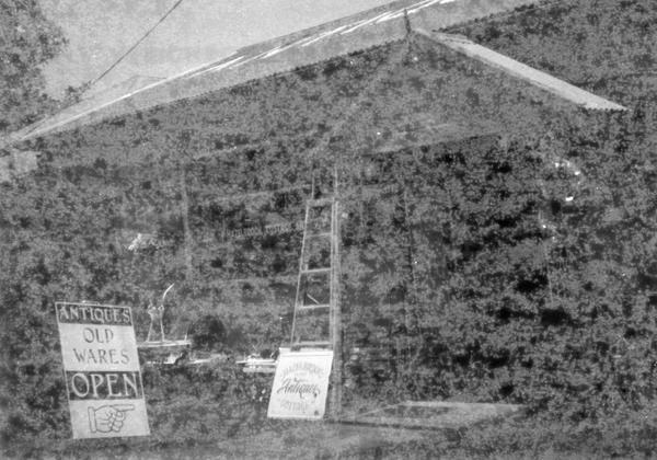

Not just test anomalies. These are real differences with practical implications. Carefully-exposed shots that would be excellent if processed promptly can come out underexposed and flat if you leave the film lying around too long. Too long is about a year.
