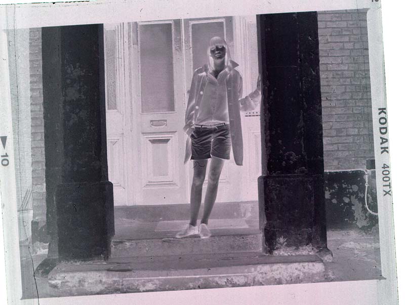

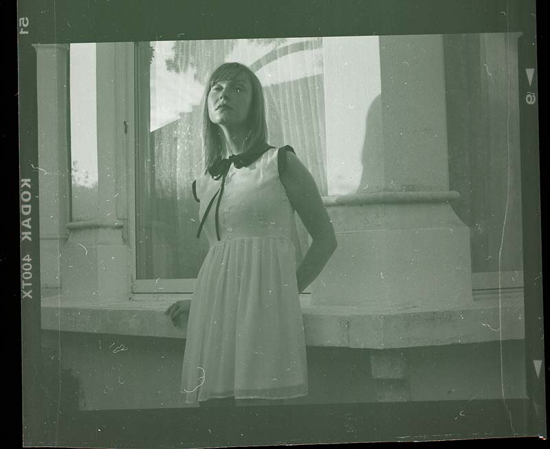

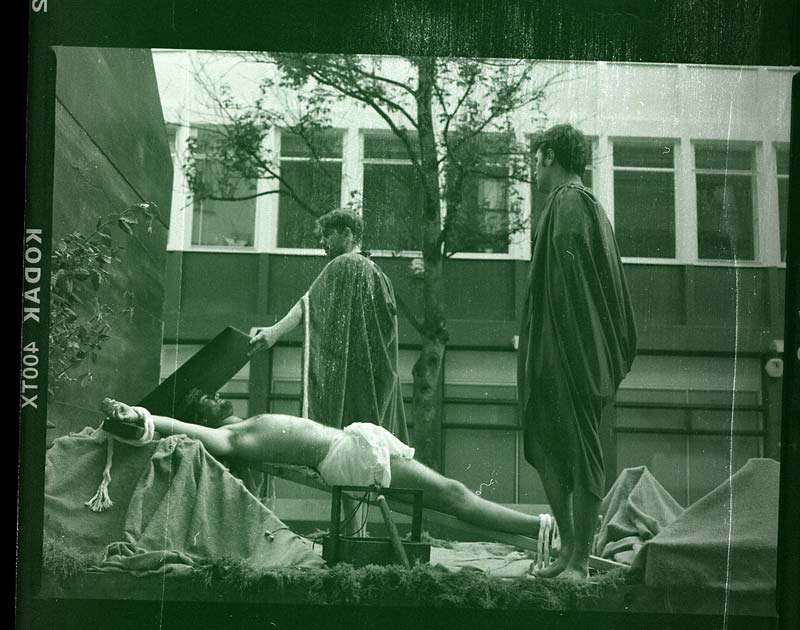

Yesterday I've accidentaly processed a 120 trix in c-41. Expecting a fuji CN 400 I was disappointed with the almost transparent washed out image, but when I realized it was a Tri-x I've felt lucky since the images can still be seen even if most of the shadow details are lost. Could be that some dyes are present in the tri-x ? As far as I know the film should be completely blank
the negative
work done on photoshop levels
no work done on levels
I'll wait to see how they will be hard to print
4min dev 100 F in colortec, 10 min blix .. easily scratched

Two things may be allowing you to preserve an image on TX.
The first is using a Blix. I have warned before that a film Blix is too weak to remove all of the silver. This may just be an illustration of my warning.
The second is that the TX400 may contain a lot of Silver Halide with very high Iodide, and this retards bleaching and fixing.
There are no color formers in TX400.
PE
