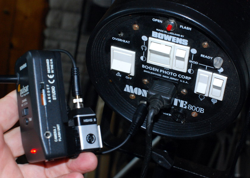

I bought a cheap set of Neewer Wireless STUDIO Flash TRIGGER RT-16 for about $20 off Amazon, but I couldn't get them to work at all, decided to return them.
So I happened to be at Chuck Rubins today and saw they had several types of older radio control units, and bought two Bowens Pulsar (radio trigger system) units- no model number, there's a label in the battery compartment that says "version 5". In the store they seemed to work- pressing the 'test' button on one set for TX will light the indicator light on the other one (set to RX).
But getting home, I still can't get them to work with my old Wein safesync (model HSHS B). The Pulsars are marked 50V max, so I think I will need the Wein safesync. I am placing the Pulsar unit into the Wein hostshoe then connecting the Wein to the monolight via a PC-to-1/4" sync cord. With the Pulsar unit switched on, as soon as I plug into the monolight the indicator light on the Pulsar starts blinking, as though there is something wrong, and in fact pushing the test button does nothing- no flash.
Can anyone help me with this? I can't find a manual for the Bowen's Pulsar online- anyone have one? Any ideas?

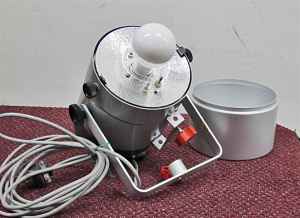

Here is a picture (actually an internet image) which shows what my Bowens units look like:

So today I took the time to measure the trigger voltage on the three studio strobes I have:
Bowens 800B: 153VDC
Bowens Mono 4000: 22VDC
Bogen Monolight 200B: 172VDC
Glad I did that!
I had to look up how to do the measurement: just use a voltmeter set to DC voltage (range 200, or maybe more). While unit is on, measure with positive/red meter probe on the sync center pin, and the ground/black meter probe on the outside sync barrel/connector/ground. This is a constant voltage that will dip somewhat when you trip the flash (as the capacitors charge back up). Mine were easy to measure- since all my units use a standard 1/4" phone connector for the sync, I can simply plug any available standard 1/4" (audio) plug into the sync connector and have easy access to the plug blades/tips/conductors.
