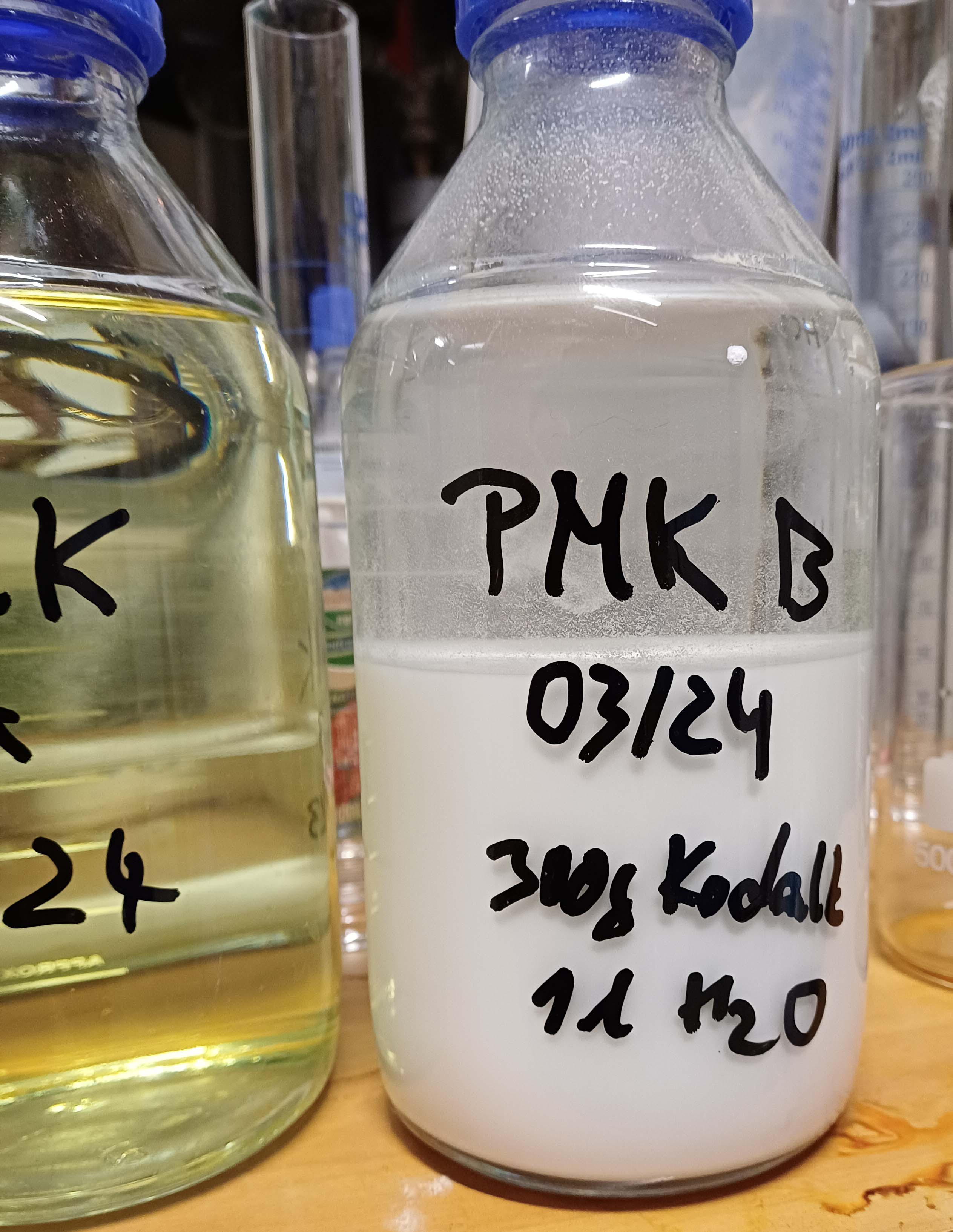

Hi,
I've some problems with solution B of PMK.
Do you have to heat solution B until all Kodalk is dissolved?
What I did:
1.) heat solution B until 300g Kodalk (sodium metaborate tetrahydrate, CAS 10555-76-7) dissolved in water -> 1l
But the solution ‎ precipitate (lot of white crystals) after cooling to room temperatur. Mixing PMK I got the color change but the development times were much longer as expected (30min for Fomapan100@50 for N-development).
2.) as reference I used a older solution B (mixed 1 year ago with different batch of Kodalk) yielding in the correct development times
3.) I mixed solution B without heating. This version of solution B is milky if shaken otherwise half of the 1l bottle contains undissolved Kodalk. With this solution B I don't get a color change.
demineralised water was used
What is going wrong?
Thank you in advance
Oliver

Oliver,
PMK B solution is a saturated solution of Kodalk (sodium metaborate). It is difficult to get it all to dissolve in anything but distilled water. Although, I would imagine that demineralized water would also do...
At any rate, if you're sure that you have the right chemical (Kodalk), then the easy solution (pun intended) is to simply double the volume of the B solution. Everything should dissolve easily in that. Then, just use twice as much B stock solution as normal. You can adjust the total volume of the PMK solution to compensate, but that might not even be necessary.
On the other hand, if the problem is with the chemical itself, then you'll have to get better sodium metaborate. I'm not sure of a way to check the purity of it or to even check if you have the correct reagent.
Maybe one of the chemists here can chime in. Rudi?
Best,
Doremus

I got the chemicals from Fototechnik Suvatlar ... never had a problem till now.

Not too long ago, I also took from Suvatlar metaborate. It is in rather large, very hard lumps. I have some doubts whether it is not too much impurities or whether it is metaborate at all. Unfortunately, I don't know how to test it...

I added 1l of distilled water ro solution B and the chemical did not dissolve.
The pH value is at 8.5 but the pH-meter is a cheap one so I can't coint on it.

You have to make sure that the chemical that you have is actually the chemical that you think you have. It might not be exactly what you think it is. This is particularly important in regards to "Kodalk"-like chemicals. Here is a recent thread about this:
https://www.photrio.com
The sodium metaborate tetrahydrate, CAS 10555-76-7 I purchased some years ago from Fototechnik Suvatlar worked as expected.

I've the impression that I don't got Kodalk from Suvatlar ...

A 30% solution of Sodium Metaborate is supposed to have a pH of around 12 according to borax.com .
A PMK working solution should have a pH of 9.6-9.7.
If it is as low as 8.5, it is not Metaborate and such a pH suggests borax which is a self-buffer around that pH which also explains the solubility issue (less than 100g/L at room temperature)

I had a call with Mr. Suvatlar - he tested the metaborate and agreed that the metaborate contains unsolvable parts (probably because of some reaction with the moisture). I get a refund + 500g working metaborate.
