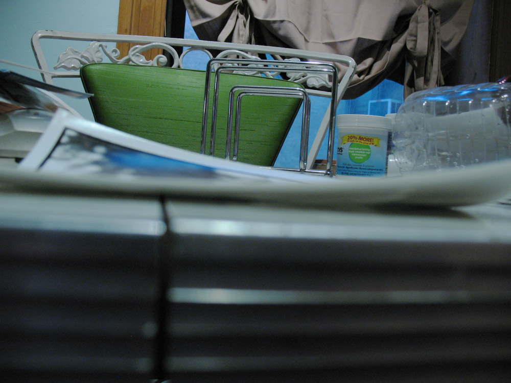

rwboyer: toward the emulsion. I'll try to show some photos.

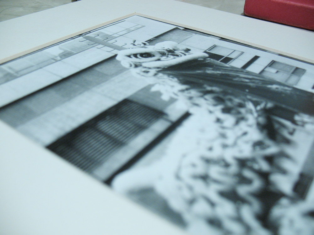

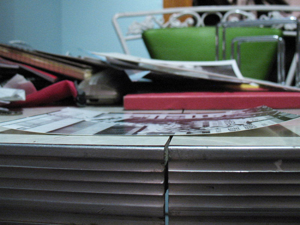

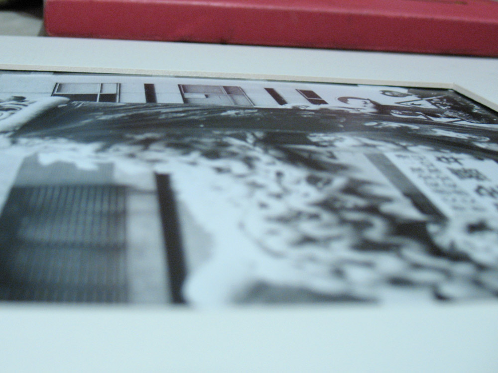

OK, here are some photos. Yes, I know I probably should have cleared some clutter before taking them.
The weight on the mat is not as strong as it would be if pressed against glass in a frame, but again I don't WANT to frame most of these RCs...these should be flat when on their own!

Okay then curling toward the emulsion - how long are they taking to dry to the touch and how fast does the curl appear?

The curl your prints have is not really that bad. Not even RC paper lies completely flat all the time. But winter is probably the big contributor. I just got through with a batch of small prints, and I got much the same results. (Locally, the temperature ranges from about -15 to -3C, and the humidity is essentially non-existent.) Some brands and surfaces of paper may be worse than others, and small prints are definitely worse than big ones. Limiting wet time may not be a real option, since you still have to properly process and wash the prints. Using wash water adjusted to 20-25C temperature can help, however. Really cold water requires longer wash times.

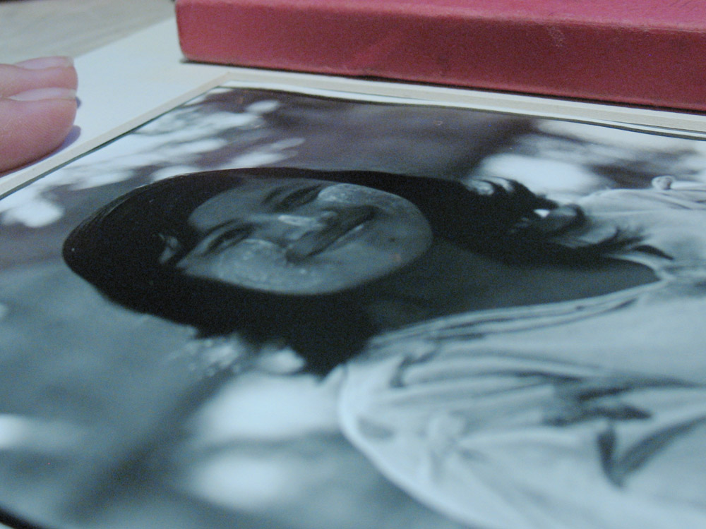

Granted RC perhaps is not truly board-flat, but here are some samples I did 10 years ago. They were done in Chapel Hill, NC while the current ones are done in NYC--but still, they've been living in the NYC environment for many years now and not stored in any special way. The lifted corners are what I think of as pretty normal. Under the mat, even without any weight, there's no curl at all in comparison to my more recent example.
Now I'm also wondering, does humidity affect the curl of unexposed paper? Looking back at these old prints I see I used to print without borders. Now I'm not sure how I would do that...I generally need the easel to help hold the paper down.

Personally I think the problem is that water is penetrating the edges of your RC too much but I could be an extreme case of uneven drying between front and back of the print - this shouldn't really happen to RC prints. My guess not having experienced an issue like this at all with RC ever is that if the curl is happening while the print is drying - like partially dry curl = a little bit, more dry more curl (like a fiber print). If the curl is happening after the prints seem dry on the outside then it is a lot of edge penetration (as in the water inside the paper under the RC takes a lot longer to dry than the outside).

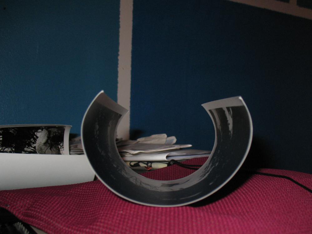

Oh, and just so you can see I'm not exaggerating about the print left on my dresser...
After having printed RC and FB papers of all types for 25 years - this degree of curl from RC is totally forked up. I may be the only one that does not experience this with RC on this thread but I know that I am not the minority in my experience with RC. The whole point of using RC is so that the handling is easy and less critical - faster fix/faster wash/faster dry - done real quick with no fuss.
The point of RC is to prevent the paper base from getting wet and causing all sorts of extra care and work to deal with it. This is a ridiculous situation IMO. If I were you I would get a really small batch of paper that others have NO issue with and process it along side what you are using now to determine if it really is your truly exceptional processing environment or the paper you are using.
Having said all that try slowing the drying down - this is easy. Just dry a print in a much more contained environment like a big plastic back with a couple holes poked in it. or a tupperware with the lid cracked or something.

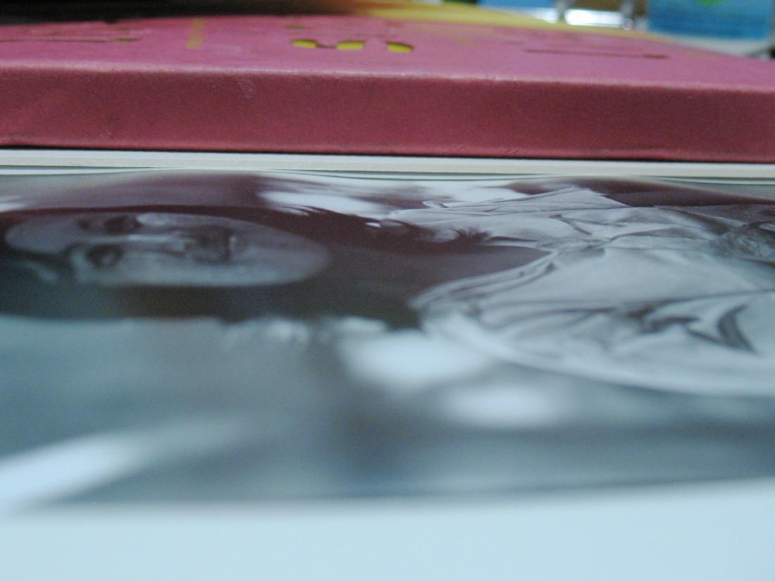

Here is how ALL of the RC turns out ever since I have been using RC for proofs and work prints.
This particular one was processed in a batch of other crappy RC with no particular care and dried with no fuss face up wherever I had room to lay it around. Most likely I jammed it in a tray of water to wait with a bunch of other stuff for final wash - don't exactly remember because I had too much wine. Did it a few days ago with the temp was below freezing and not too humid. My house is forced hot air heat and so dry that the back of my arms are more like alligator skin than human skin in the winter time.
As I mentioned I have never thought of RC as particularly or even remotely sensitive to environmental conditions in terms of drying.
RB
Ps. the curl you see is the exact same curl that came out of the box - very very slight - less than 1/16" at the edge. No ripples - no fuss. The whole point of RC paper. I swear if this was happening to me I would box up a print and send it back with a note that said "WTF ???"
Pss. That is 11x14 paper. Don't ask - I happen to have accidentally ordered a box of 11x14 RC and I am "using it up" I am too lazy to cut it.
