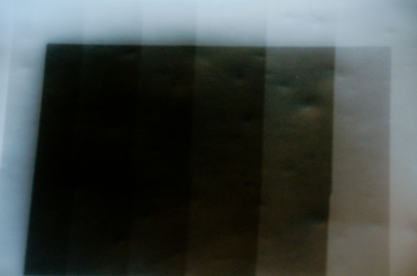

So here is the deal: I set up my own darkroom to play with 35mm for a while and I just haven't had any luck with this enlarger. I'm not used to dealing with Omegas but this was for cheap, practically given away. But there is some fall off toward the edges but the center gets burned too deep. I have provided a test on a Bromoil (Amidol developed, which I had just mixed up) paper to show you what I'm talking about. The blacks don't get black unless exposed for abnormally long periods and at that point the rest of the image just turns into a big blob of garbage with very little contrast and even less details.

I printed a test at 3 second intervals which is attached. You can see the falloff of light at the top and bottom of the strips but a blob of black in the center. And the paper gets exposed beyond the strips as well (something else I'm not used to seeing) which can be seen in the upper left. Please advise me!!!

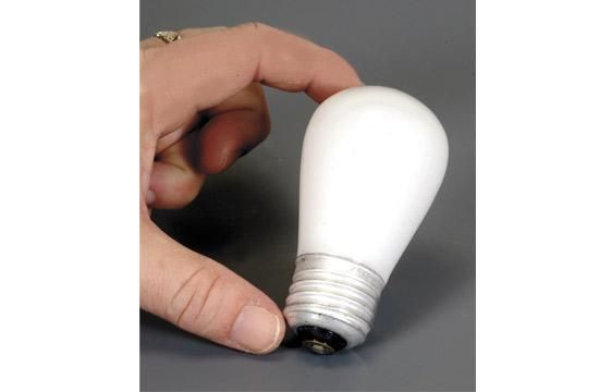

Are you using the correct type of bulb for your enlarger. It needs to have the white coating for even illumination. Regards ---john.bulb.jpg

The exposure extending beyond the "strips" tells me that you have either a light leak on problems with a safelight.
If the lens focuses sharply on the base board it's not likely to be the problem. If it's a Rodagon it's also not likely that you can get a better quality lens.
I'd tend to agree with Mattking and the possibility of fogging.
Is your safelight safe or too close to the work area? You're likely aware of putting a coin on the paper, expose it for a minute or so then processing & seeing an unexposed area. Or not>

I had actually considered the safelight being the culprit before. I'm using those red safelight bulbs that Adorama sells and the one on my dry side is about 3 feet away but over my enlarger. I had started turning it off before i printed the test for Max Black which is shown in tge OP. I will use this coin to test for certainty in a couple days to find out for sure though.

Throw that effing bulb in the trash and buy a real safe light.
Oh, and thats the correct condensor set.
Turn off the safe light 100%. 3 feet is way too close in any case.
I am sure there is a thread here on properly testing the safe light. Do not fall for the coin test as it is worthless almost.
