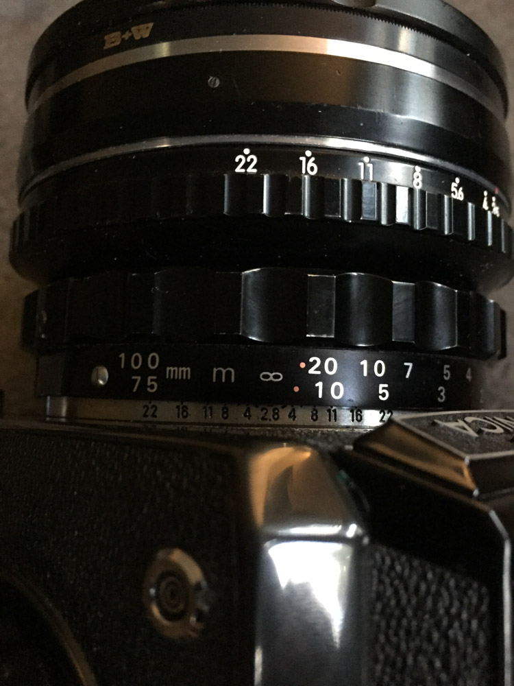

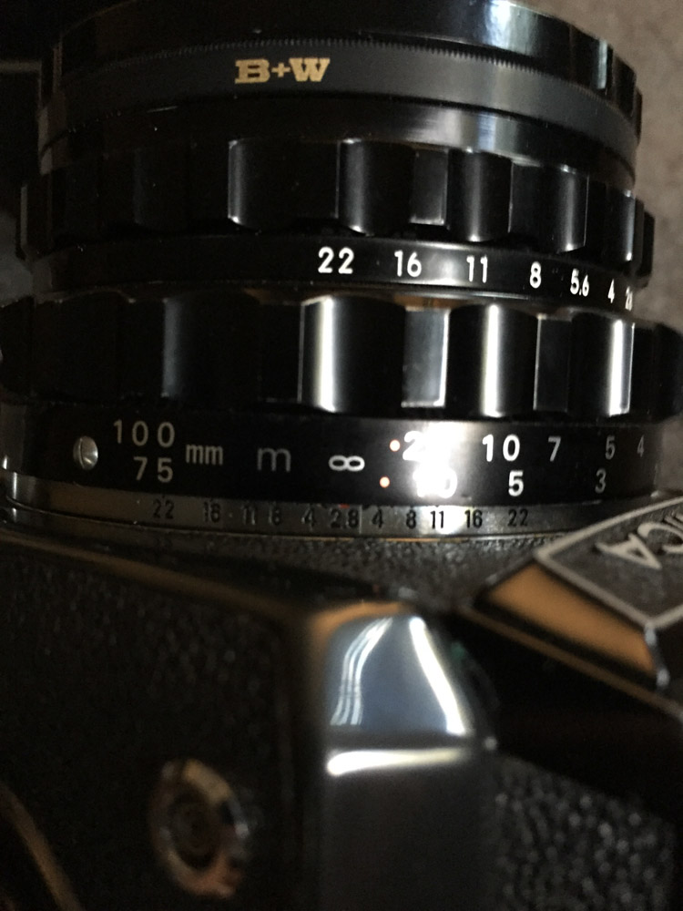

Loud? Having never experienced one before getting it, I was half expecting a thunder clap by the way everyone talks about it...lol Leica/Rolleiflex quiet it is not, but the mirror slap doesn't bother me at all.

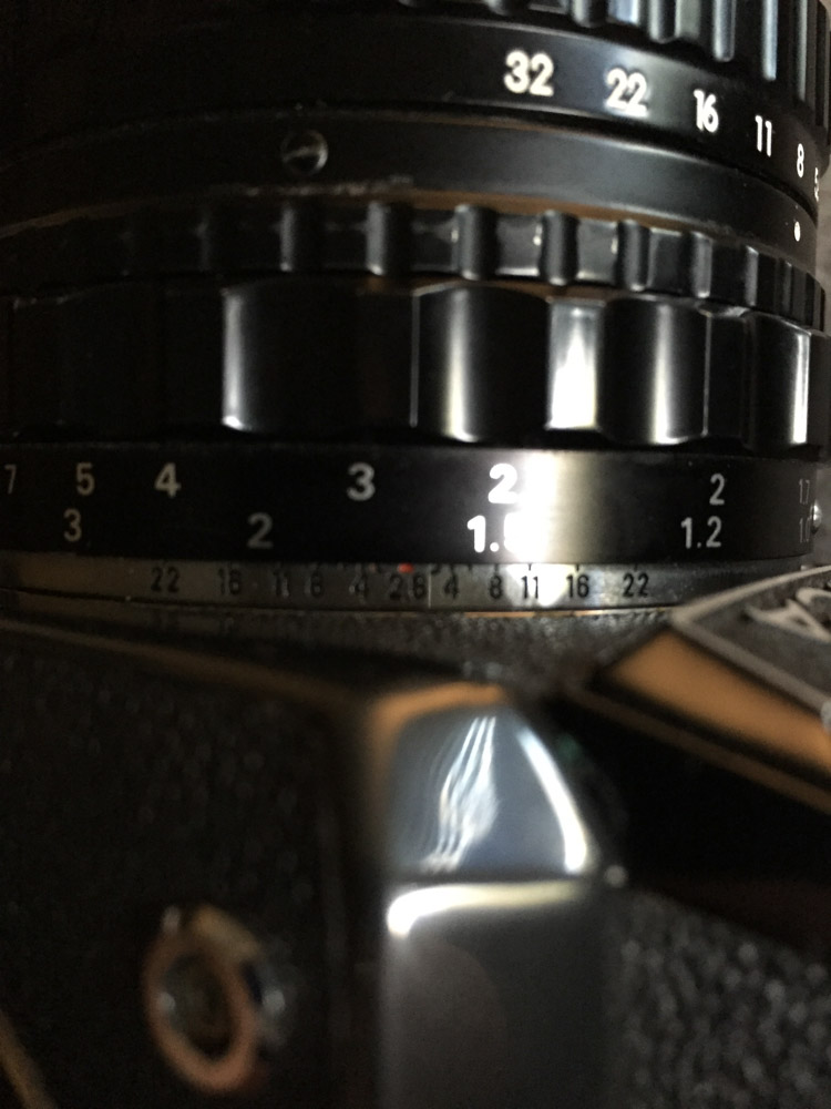

Here are some pics of the 3 lenses focused to infinity. As you can see, the 100 and 50 focus right out to infinity on the scale (and show properly on the ground glass), while the 200 only focuses out to ~3' on the scale and ~20' through the viewfinder. Someone suggested that the lens may have been serviced/disassembled and not put back together correctly, but I can find no signs of the screws being undone.
50mm:
100mm:
200mm

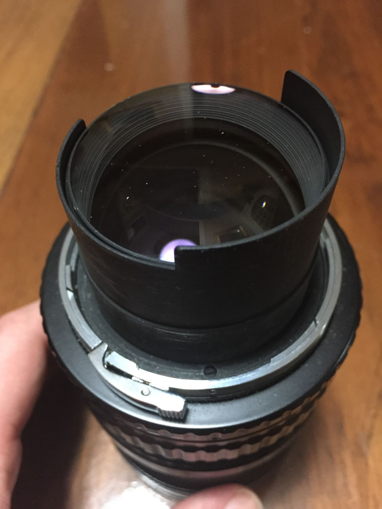

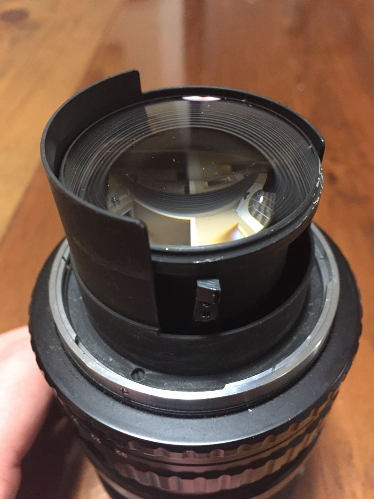

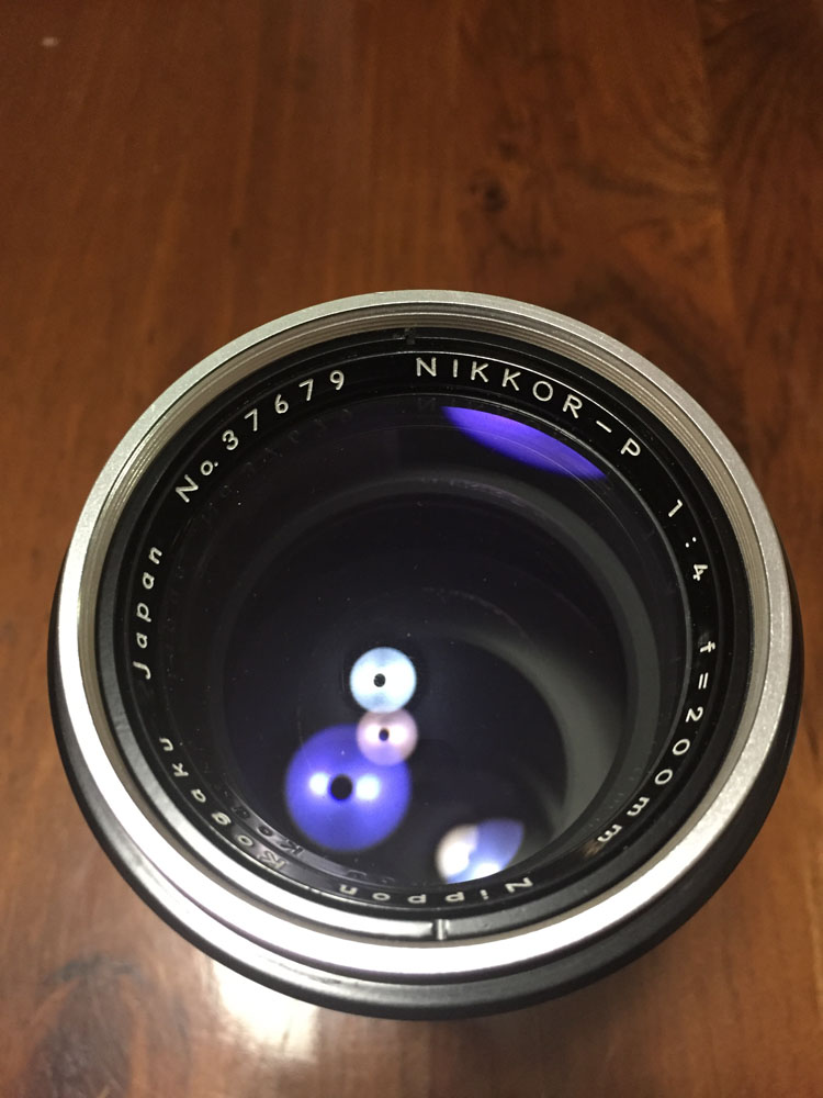

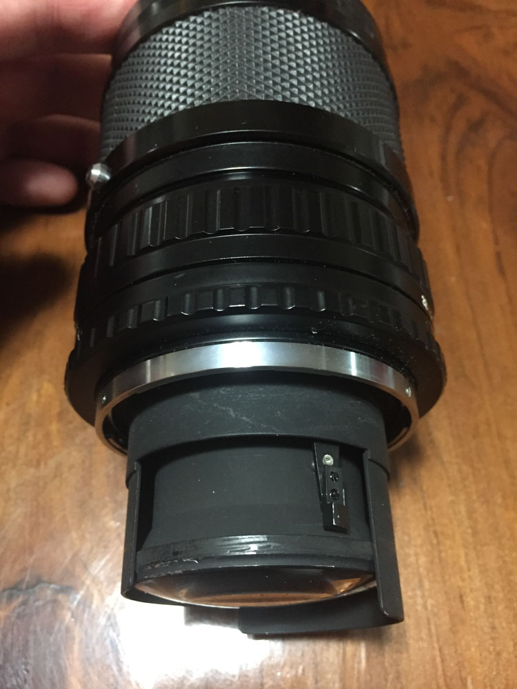

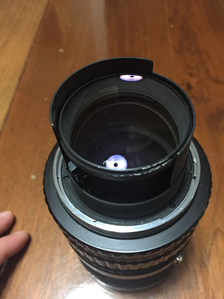

If it helps, here are some pics of my 200mm. The only damage I can find to the lens is you can see some bright marks by the edge of the rear element. This was there when I got the lens and is not from it rubbing in my helicoid or camera body.

N4646W
Jan 10, 2016
20
If I get a chance tonight I will stop by and dig my stuff out again. Your lens looks totally different than mine from the pictures. That said, the marks look as though the back end of the lens housing was impacted. If it was severe enough, it "could ?" have caused a distortion some where so there is an internal bind or misalignment?
Ron
N4646W
Jan 10, 2016
20
Wow! Did not realize how much I had acquired over the years. Any way, I found a 200mm lens that looked like yours, but the serial # is in the upper 600K series. It is an F4 and will focus from infinity to 2.5 ft. and close down to F 32. I ran it through it's full turns on some spare focusing rings (this was interesting, as externally they all looked the same, but internally they all had subtle differences) and it worked just fine. You could definitely feel it come to a definite stop at both ends of it's range.
Have you checked the locking lugs to see if one of them is burred or deformed? It is possible if one is off, you will get a feeling that the lens is locked on. I had a 35mm lens I picked up that had this problem. With a jewelers file I was able to salvage a tele that I picked up for a dollar. There is also a tab in the focusing mech that you can watch as it travels from stop to stop.
