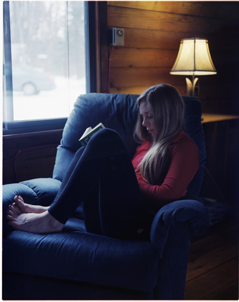

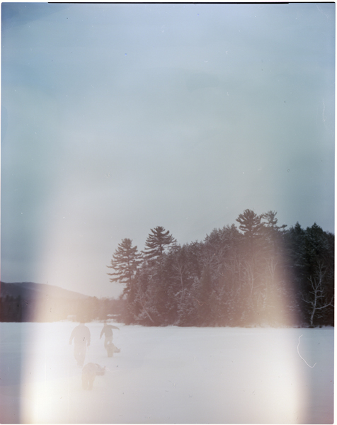

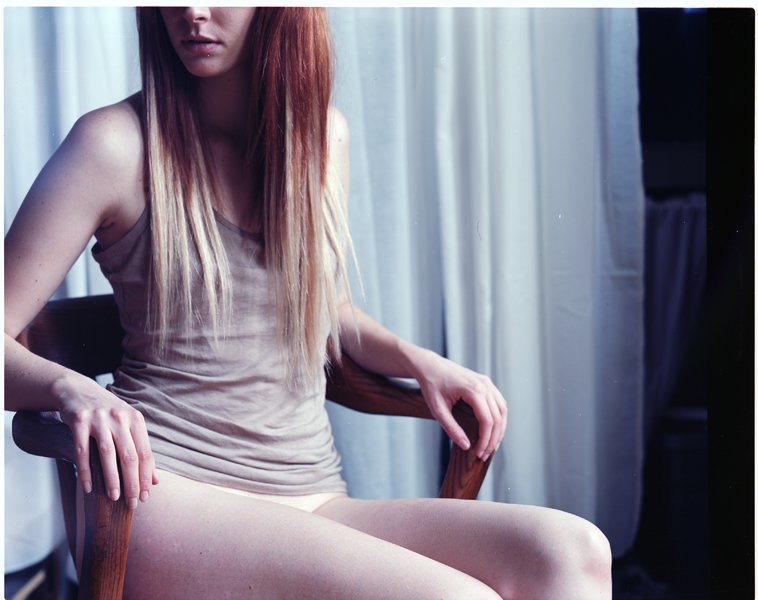

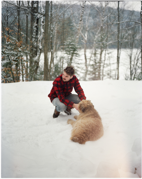

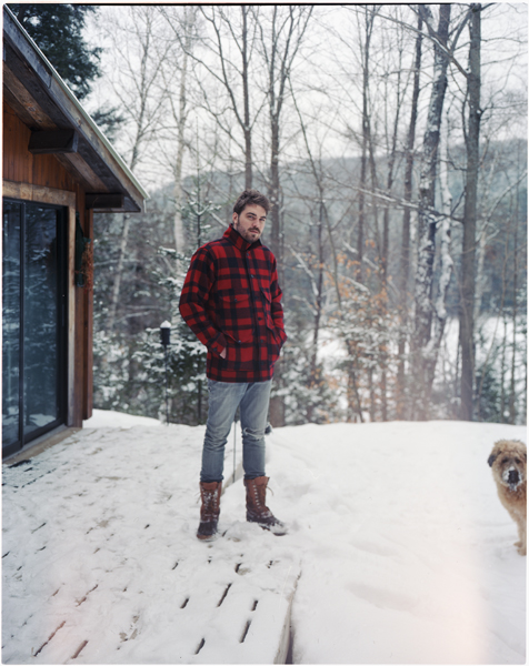

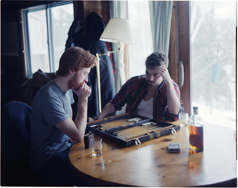

I've recently acquired a Jobo CPP-2 (thanks Shadowtracker!) and a Jobo Expert 3006 tank. I have no previous experience with colour development, but after reading hundreds of threads on how 'easy' it is, I decided to do it at home. I was also advised that the Jobo Expert series is the best way to go with due to it's ease of use and constant even development. Well, after running a couple of sheets through, I find myself really frustrated. I am getting uneven development in the center of some sheets during each run. At first it happened in all 4 sheets I put through. I then did some reading and found out about the importance of leveling the drum before processing and it all made sense, how the part closest to the bottom of the tank didn't the same amount of chemicals. I ran 2 sheets making sure it was leveled and they came out perfect. After that, I ran two sets of 6 sheets each, getting mixed results in both batches. Some come out great, some with the center not properly developed. In some it's more apparent, some are more subtle and some are perfect. I am posting a few quick scans, all sheets are from the same tank, same run. Has this ever happened to anyone? Any clues on what I am doing wrong?

That looks DEFINITELY like a light leak! Test4 is very clear, there is even that distinct, straight edge shadow on the left, which would also mean the light leak happens probably in the camera/holders, not in the Jobo tank.
It would be a very peculiar chemical error. Look, you have no part of image underdeveloped, instead you have a HUGE density increase, and they are not higher in contrast. Overdevelopment would cause that, and further, you would need a huge overdevelopment at those parts. And, overdevelopment does not give even density to shadows and highlights, like you have in the snow vs. forest parts.
Also the fact that the problem seems to happen outdoors points towards a light leak.
The light is coming from the emulsion side of the film as you can see from the neutral color. I would suspect the dark slide etc.
It's definitely a light leak - sorry. Your Jobo and process is fine.

But still, I would vote the holders / dark slide because of the distinct straight line shadow in the light leak.
