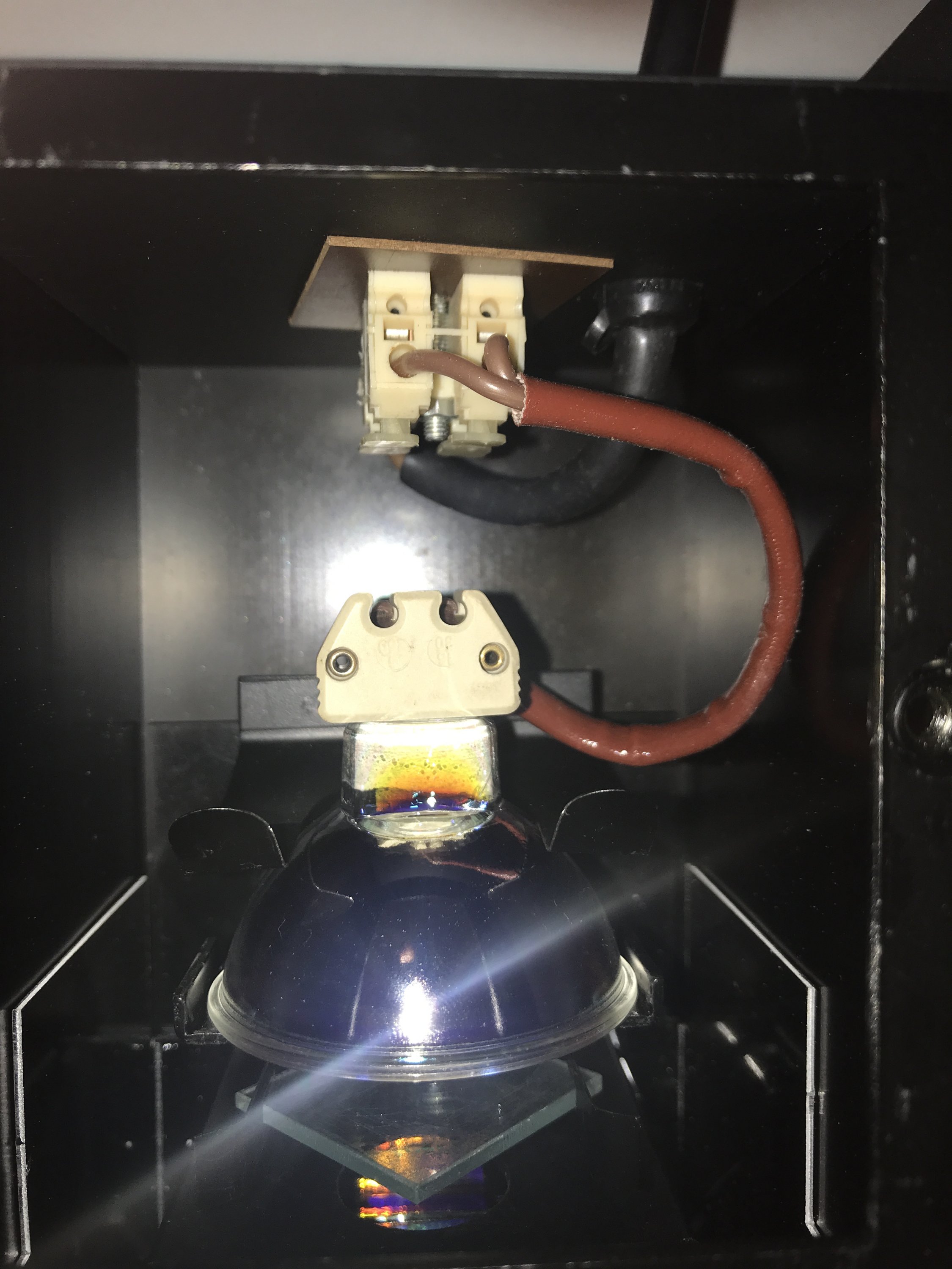

Hi, I'm having a problem with my Durst M670. The light is very inconstant, it keeps shifting its intensity. Something it's almost imperceptible but sometimes it looks like someone is playing with a dimmer switch. And it's ruining my prints.
I already changed the bulb, but the problem continues.
Any suggestions? Here's a picture from the inside of the head.

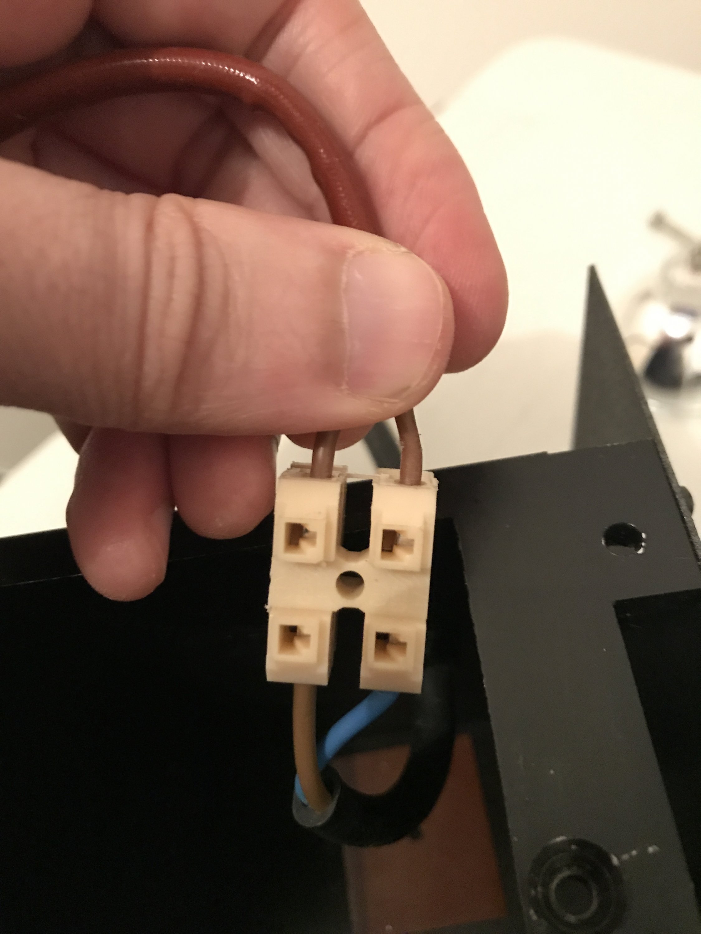

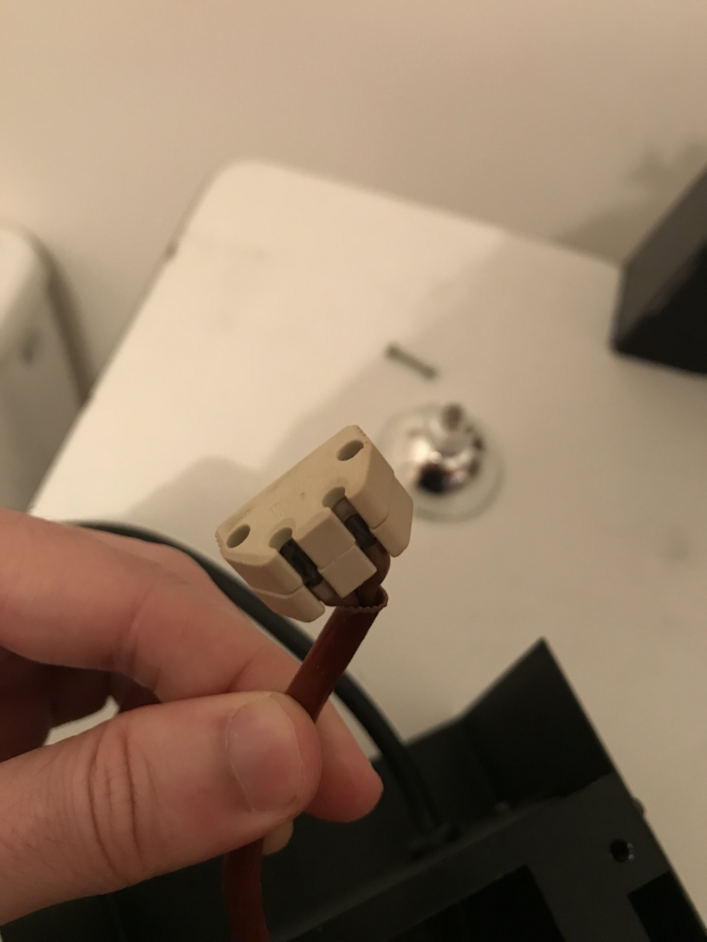

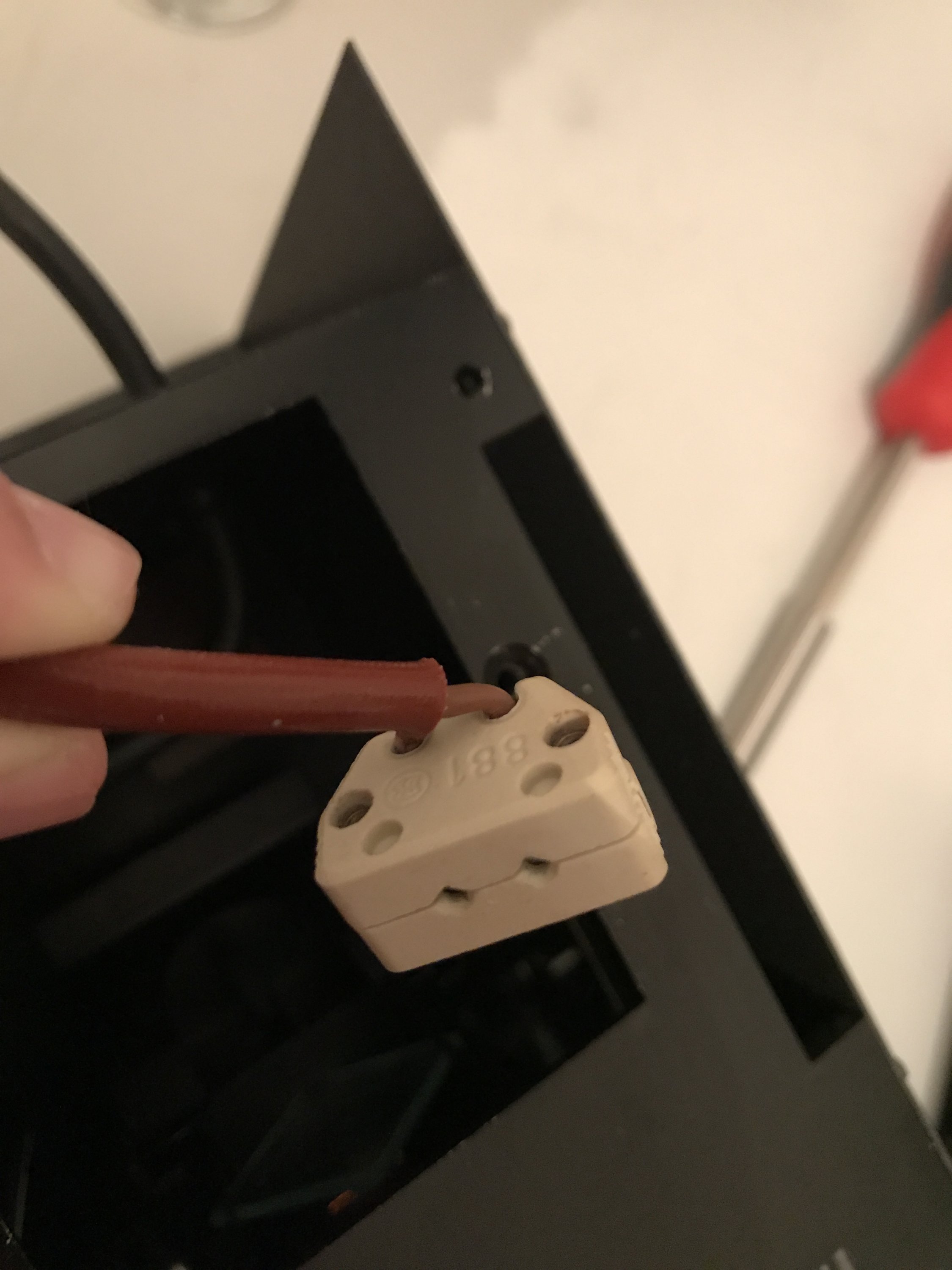

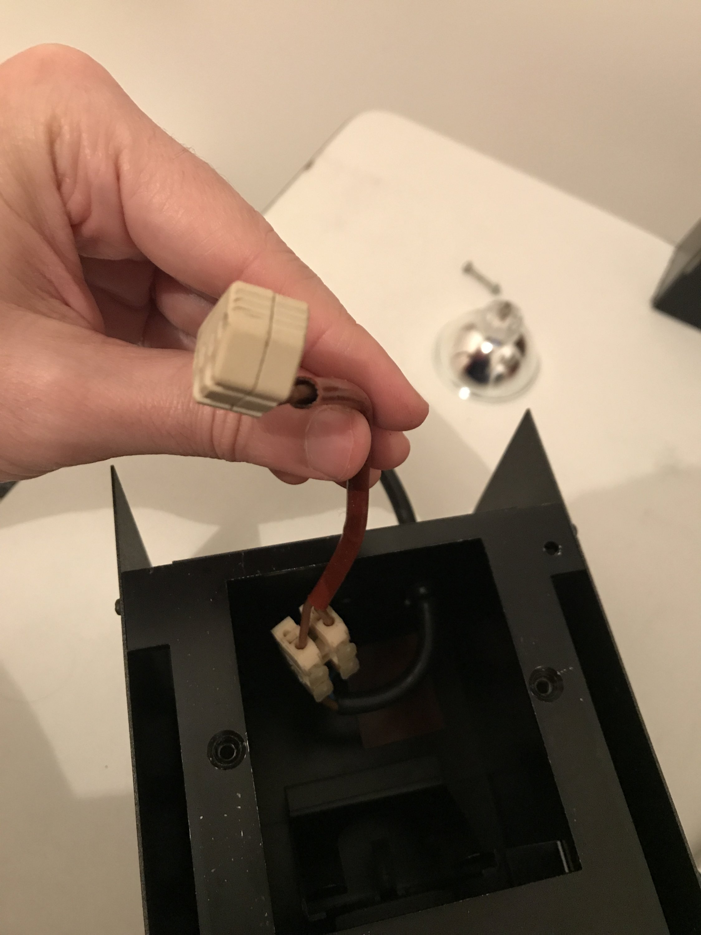

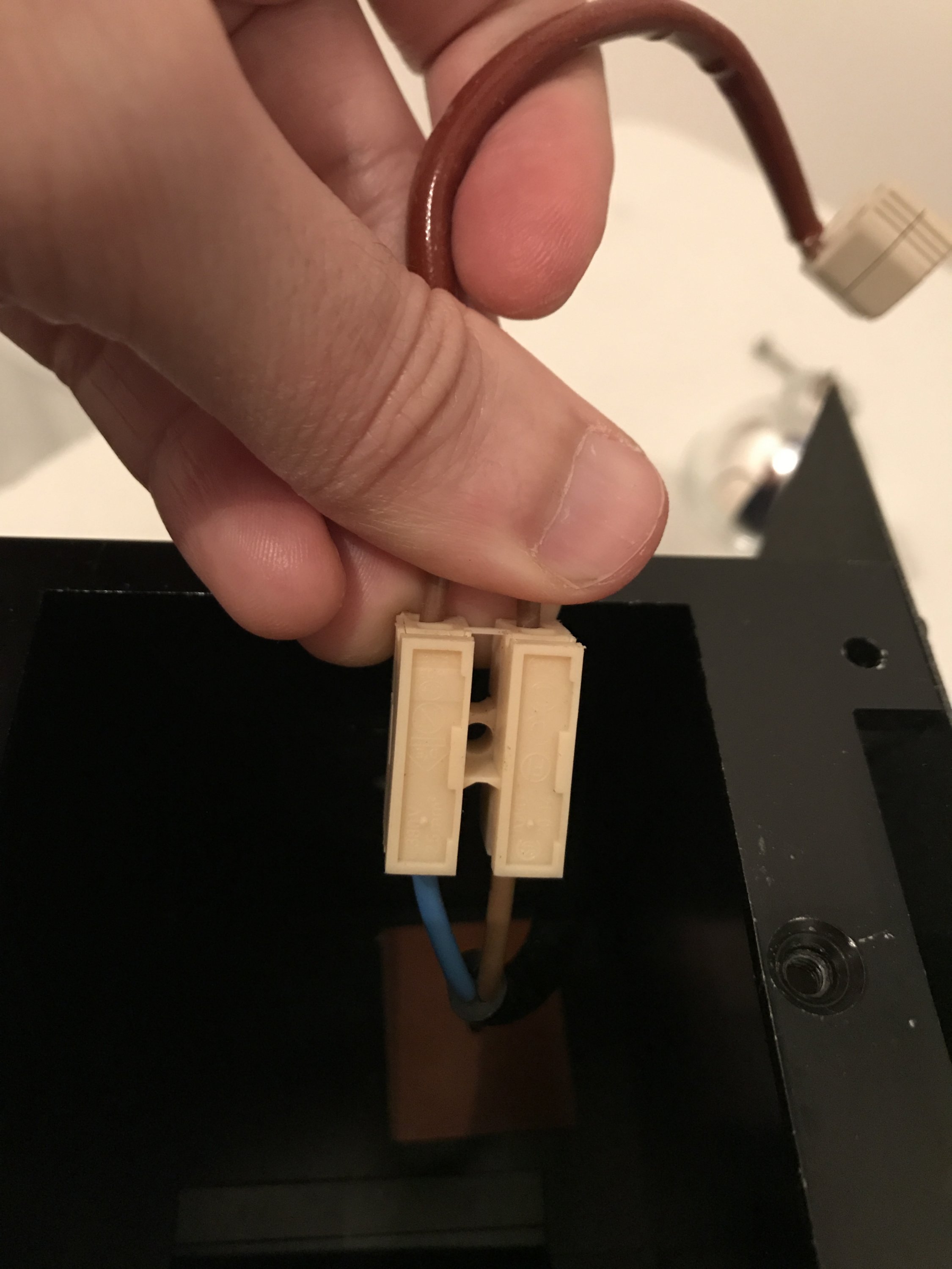

I took some more pictures of the socket:
This has happened to me as well. One solution is the one mentioned which is cleaning out the female part of the socket with a needle or very small file and it might be worthwhile to clean the male ends on the bulb but as has been said I'd try and replace the female socket. It is sensible to keep a spare bulb. The bulb may be on its way out anyway so I'd also replace the bulb

It is one of the most common lamp sockets world-wide. Used in billions of applications. They fail frequently, so replacement is in order.
