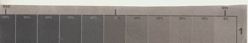

Due to the pandemic my provider of chemicals for Pt/Pd, DISACTIS PHOTOCHIMIE, temporary doesn't ship to my location. I still have some Ferric Oxalate powder and I tried to make the solution myself, but without success. I tried 3 times with the same result (Bergger COT 320 paper).
I've tried progressively to add some Oxalic Acid to the solution but the result remained the same. I still have some 30ml of 1 year old Ferric Oxalate solution and it proved to be much better than the new one.
However, the black zones are not as black as they should be and I wouldn't trust it for new prints (...or should I trust it? What's your advice?)
Is there a way to make the new Ferric Oxalate solution work properly? I should mention that my Ferric Oxalate powder has a yellow-brown color.

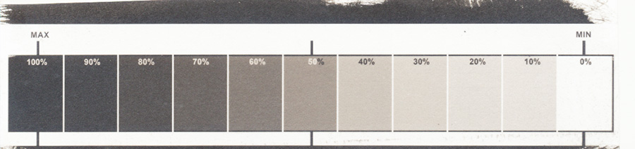

Thanks again Niranjan. Adding 7 ml of Hydrogen Peroxide to 30 ml of solution really solved the problem!
I increased the exposure time from 3 min. to 5 min. and now the test print looks as it should, with clear whites and deep blacks (deeper than they appear in the scan). From now on I'll make adding Hydrogen Peroxide to the Ferric Oxalate solution a standard procedure.
