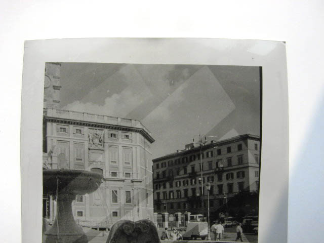

I am having a problem with my b/w prints, where taking them from the fixer, within a few seconds a stain appears mostly around the edges. I have attached pictures of three prints to explain.
Print AAA, is what first happened to a Jessop's 7" x 5" RC paper print = a grey veil over all the print, including the borders, after removing it from the fixer. If I remember correctly, it happened to prints with and without the white light on, so I'm presuming something is happening when the prints are exposed to air after the fixer? I immediately thought that the fixer was exhausted, fogging the print, but that shouldn't happen in the dark!? I did a fixer exhaustion test anyway and I was correct at it being past its best, despite me being quite strict with how many prints go through it before replacing. It should have been still of a working condition. Just to be safe, I emptied and cleaned out all three slots of my Nova processor and refilled with fresh chemicals.

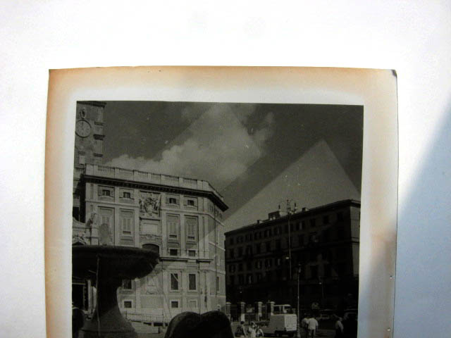

Print BBB, is what happened next = instead of the grey veil, an orange brown stain all around the borders appeared. The borders are 1/2" wide, and the stains don't go into the print. There still seems to be a light grey veil over the exposed part of the paper, but part of the borders that aren't stained have remained white. The stain itself is about 8mm wide from the edge (sorry about the use of two sizing ways but it's the only way I can think of doing it).

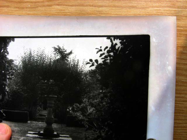

For print CCC, I decided to change paper from Jessops to a fresh box of Kentmere 10" x 8". The chemicals were all fresh, as above and I double checked the fixer with a test, just to make sure, as it was the last from the bottle. It checked out fine after three tests that I did to really confirm to myself that the fixer was okay.
This print, again when lifted out of the fixer, produced a wider coloured border, with the stain noticeable in the top part of the print as well, where a blank sky should be, although this doesn't show well on the attached print, but it is definitely there. This time it is purplish, with a yellow tone in parts of it. I have just done another fixer test, the day after the printing session, and the test comes back clear, so the fixer is fine.

Looks like a fixing problem to me, likely either bad fix, or inadequate fixing time, or contaminated fix, or some combination.
Are you using an acid stop bath? How long are you fixing? What is your fixer test procedure?
