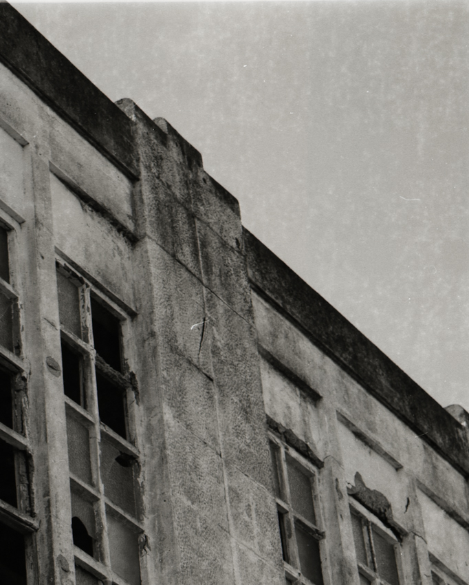

Hi all,
I read with great interest the other threads about Foma quality problems in 120 !
I found something very worrying with a 120 roll of SuperPan 200 from Rollei I just bought for testing.
You can see in attachment a scan of a "zone of interest" from the film, freshly processed this week.
Obviously, there is a "transfer" from the ink of backing paper onto film !!! You can see the numbers of backing paper (in reverse, upside-down), and alignement square dots as ghosts images ! Worse, the whole zone of highlight is motled, likes something in the backing paper get sticky to film.
Actually, I have already see these kind of quirks with a bundle of ten Fomapan 200 in 120, several years ago. I thought then that something get wrong because of my storing condition, as it happens only with the last rolls of batch, more than a year after buying it.
In this case, for the Rollei Superpan 200, I bought it only a few month ago, and it was always stored in his original thight container, in a rather cool place (lower than 17/18°C). All the other B&W and even color film I store in the same place are Ok, including all the Fomapan rolls I bought since the "defective" batch.
So, what do you think of this ? Storing problem (or other (?)) ? Rare "Bad lemon" Or defective production ?
In the last case, I will be rather disappointed by this first experience with Superpan, I am usually confident with Rollei brandname for film until now.
Regards,
Raphael

a storing problem might occur in a very, very extreme case :confused: You mentioned lower than 17/18°C, I guess the humidity was in a reasonable limits? Would You share the batch number of Your roll?
I shoot a lot of the Rollei films, mainly those manufactured by Agfa and so far, after hundreds of rolls its been all excellent.

Superpan 200 is sensitve to infrared light too. It may be that the backing paper lets paass some of the light, especially if you have a camera wit ah red window.
I used much of SP 200 with my Rolleiflex without any problems.

Dear Raphael,
This is called 'wrapper offset' : Where the printed information on the backing strip transfers to the film. Georg and Piu58 are correct, high humidity can affect the wrapper but its the red view window that is the usual cause...ensure it is covered.
I have seen more than a few posts where people 'complain' that the printing on our ILFORD wrapper is too feint.....its like that for a purpose it makes 'wrapper offset' a lot less likely.

@georg16nik : It's a good point, humidity, here, is somewhat high in open air, during all the year. I'm living almost in seaside, it's an oceanic climate, after all ! In my basement, where I store the films I need in a short time, humidity oscillate between 60% and 80%. It's rather high, but I try to limit it with an electric deshumidifier appliance, and films are often stored in metal box with a small bag of dessicant. I think to this too, but my whole other 120 and 220 films, branded Fuji, Foma and Adox, never (in the exceptions of one "old" batch of Fomapan) showed these marks, in despite they are not all in an airtight plastic container likes the Rollei.
For the batch number, I can of course share it, on the container, it shows : Batch #670378 exp 03/2014. BTW, I am not new to the Rollei film range, I had already used Retro 100 film in 120, and found it very nice.
@piu58 : I discover this extended sensitivity in IR, on the net, after exposing this film, maybe I should have been more careful when loading this film !
@Mr Galley : thanks you for giving me a name to this phenomenon :smile:
In fact, I have no red window on my camera, it's a standard 120 removable back for a Bronica SQ. One in one, I think my problem came from IR, but how ? I don't recall precisely how I loaded the back, it was certainly under attenuated light (not total darkness).
Should I know something about these backs and IR ?
I already used 120 IR film several times, like Ilford SFX200, Efke 820Ir, or Konica 750, with good success but it wasn't with this camera.
