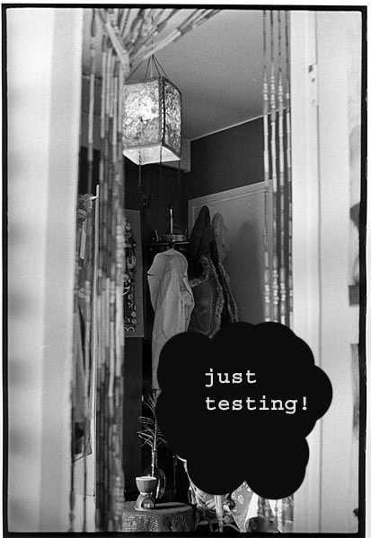

Ok... here is one example of the problem. Those sprocket hole "stripes" that is.
In every other way these negatives are the best I have ever done -- printing was very easy and I really love the tones on the prints! But those stripes.... Is the problem in my agitation cycle 10 sec / 3 minutes or in my agitation technique (=should turn/twist the tank differently)?

MMfoto
Sep 11, 2004
447
Super8
Are you sure your darkroom is 100% light tight? Is that frame from near the beginning of the roll? It looks to me like the projected sprocket hole patterns you see when a small amount of light exposes the film through the sprocket holes of the leader-that mostly protects the rest of the roll-when loading film reels.
pmu
Apr 18, 2005
112
home
Yes, darkroom is light tight. That frame is almost in the middle of the roll. As I mentioned before, I can't see those "stripes" on the negatives -- I had to give about 40% more exposure to those sides in the image to get the tones I wanted and only then those stripes appeared.
MMfoto
Sep 11, 2004
447
Super8
Than it sounds these are sprocket hole flow patterns from uneven or inadequate agitation.
Hi,
Are you sure that the nega doesn't have stripes ? Is it seen only on prints ?
If so, what type of negacarrier are you using ? Are sproket holes projected on the easel or easel blades ?
I see the strong lights come through the sproket holes are reflected on the easel and cause stripes in a print just like yours.
pmu
Apr 18, 2005
112
home
kunihiko said:
...what type of negacarrier are you using ? Are sproket holes projected on the easel or easel blades ?
Oh man, that could be it! I just got a new enlarger with glass negacarrier and I remember that I could see those sprocket holes on the easel blades -- and that particular blade side where those stripes appeared is in that kind of angle that the light possibly could reflect to the paper...

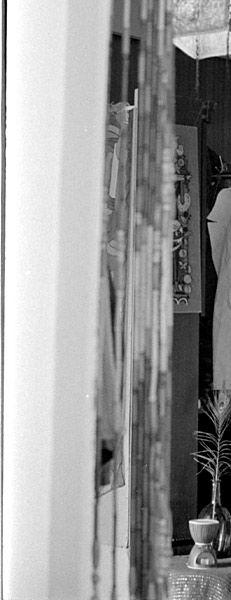

kunihiko said:
Hi,
Kunihiko, you were right :smile: I looked at the negatives -- looked normal. Scanned the negative (2400dpi) and it looked normal... Oh man, I'm so pleased that I don't have to change anything in my film developments! :smile:
