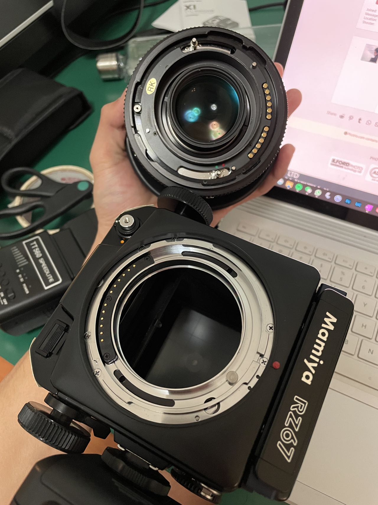

Thank you for all your valuable knowledge, it was indeed the cheap trigger, I tried a slightly more expensive one from b&h and it's working now, although I ran into a new problem where modern speedlight that recycles fast will fire twice when I press the shutter (once when opening and once when closing), even up to 1/250s, this issue occurs with 2 godox models and one neewer speedlight, not with old vivitar 285 that recycles slow, it happens with just the PC sync too, though it doesn't happen when I use the generic trigger and receiver. It still happens when i use godox trigger and the speedlight with built in receiver. Trying to find a flash set up for this rz67 is quite a difficult journey....

Sounds like contact bounce in your flash contact. Still needs to be cleaned...
Could you let me know where to clean? the gold colored contact? rubber eraser or
cotton swab with alcohol?
Thank you I have no idea
Depends on the camera, but it's usually a contact located inside the camera body or (with leaf shutter lenses like yours) the lens, close to or as part of the shutter mechanism. It's not something you can reach without taking apart either lens or camera. I don't know if the RZ67 body takes the flash sync signal from the lens shutter or if it generates its own sync inside the body.
