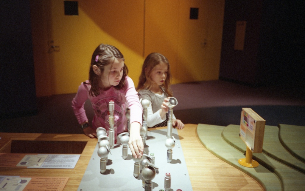

I have an Olympus XA that I puchased a few years back.
I went through the process of cleaning it thouroughly and replacing the light seals.
My first roll I was very very unhappy with.
I thought that maybe the rangefinder was out of alignment. Nothing seemed to be in focus.
But I was looking the camera today, and it appears that the meter is about 3 stops off! Could that account for the general fuzzyness of the photos? An under-exposed negative would certainly be grainy washed-out. I have attached the example.
So, I could just adjust the ISO to compensate. But will the exposure compensation be consistant across varying lighting conditions?
Is there anything I can adjust to fix the problem?
( I allready tried fresh batteries)

The meter is a problem, but not the kind of problem that could give unsharp images.
The picture you posted is not awfully out of focus, and if am not wrong it looks a bit blurry as well.
What exposure time did you use?
The box to the right seems to be in focus if it wasn't for the light blur.

I get the sense that a 1/10 of a second exposure may have been required by the lighting in the room. I'd wager it was iso 400 film with an exposure of f/2.8 at 1/10th of a second or so.
Maybe I'm just biased as my first experience with an XA involved a bunch of low light shooting which didn't work out too well for me due to exposure length.

Unsharp: I think the example shows that the shutter speed was slow enough to be affected by camera shake. F2.8 and 1/10th sounds about right

"three stops off" so your negatives are three stops OVER or UNDER exposed?
Try compensating the ISO by 3 stops and shoot some images in dark and daylight conditions. If the exposure is OK on both you are set. I'd not get too upset about the shutter speed readout in the window as it will be quit difficult to correlate that to an actual shutter speed without a shutter speed tester.
The picture posted is severely affected by camera motion artifact.

If XA is calibrated in the proper order, with the proper batteries (silver oxide only), the shutter speed will be very close to the indicated speed. Wrong batteries alone can give incorrect needle position but still give correct shutter speed. 1/10th shutter speed could easily allow camera shake. Electromagnets don't wear out, but they do get oil on them which will cause wildly erratic overexposure. John
