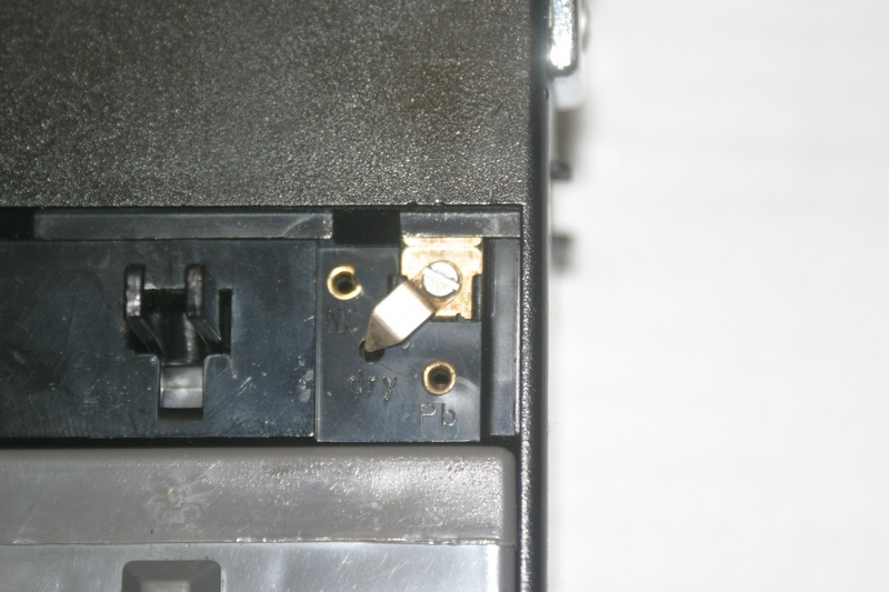

The switch lug looks like this on each of my two power packs.
Don't switch it away from the Dryfit setting, because you will lose the circuitry that protects against over-charging.
