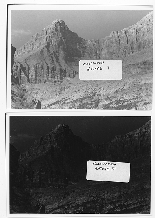

I have had a problem with Kentmere VC Select Fine Lustre (7x5)
Equipment used
Meopta Magnifax 4 with multigrade head
Ilford multigrade developer
Fotospeed stop bath and fixer
Nikon 63mm enlarger lens
I have been doing some test prints to find the correct exposure time for the kentmere paper. After a few tests I got a decent grade 2 print at f11 and time of 20 seconds.
As the multgrade head has a neutral density filter built into the colour filters for the different grades there should be no (significant) difference in the exposure time when printing with harder grades. However when I tried printing the same image at grades 3 -5 all that happened was that the images did get a bit more contrasty but also got significantly darker as the grade increased. I made no changes to the aperture or exposure time. I even used an Ilford EM10 meter to check the exposure and it actually showed a slight reduction in image brightness as the grade increased (which should have priduce a lighter print!!).
I then used Ilford MGIV pearl to produce a grade 1 and grade 5 print with the same exposure settings. This did exactly what it should have done - significant increase in contrast with a very small change in the brightness of the print.
As a final check I went back to the Kentmere and did another grade 2 and 5 with the same settings and the original darkening of image occurred again.
The Kentmere paper was purchased Nov 2023 and the MGIV purchased in 2009 and kept in a freezer, so I would have expected problems with the MGIV rather than the Kentmere(!)
Has anyone else experienced this problem or similar?
An explanation would be gratefully received.
Thanks
Attached a couple of images from each paper. Hope that helps. Yesterday I produced a great split grade print of my granddaughter on MGIV so doesn't seem to any problems with the multigrade enlarger head or the MGIV paper..

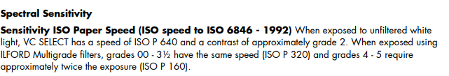

FWIW, here is what the datasheets show:
Kentmere:
Ilford MGIV and "V":
If nothing else, you will note that there is considerably more of a difference in sensitivity (4x vs. 2x) between the 00 filter and 5 filter for the Ilford paper than there is for the Kentmere.
And of course, the Kentmere paper itself is twice as sensitive as the Ilford.

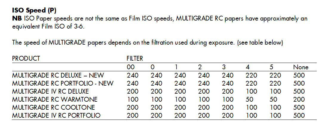

I believe you are a bit mistaken here - look at the ISO Speed (P) chart in the Ilford datasheet, that is what should be considered in comparison to Kentmere paper properties.
Fascinating - my table also came from a datasheet posted on the Ilford Photo website. I wonder which is right.
IIRC, Ilford originally designed its multigrade filters and paper so that grades 0-3 would require the same exposure and grades 4-5 would require twice as much. Look at the speeds listed in the line for "MG IV DELUXE RC" in the table bedrof posted (look at any of the not-"NEW" lines in that table, and note they are different from the table MattKing posted). IIRC this was a slight advance over Kodak Polycontrast filters and paper where there was no speed equivalence.

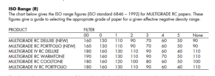

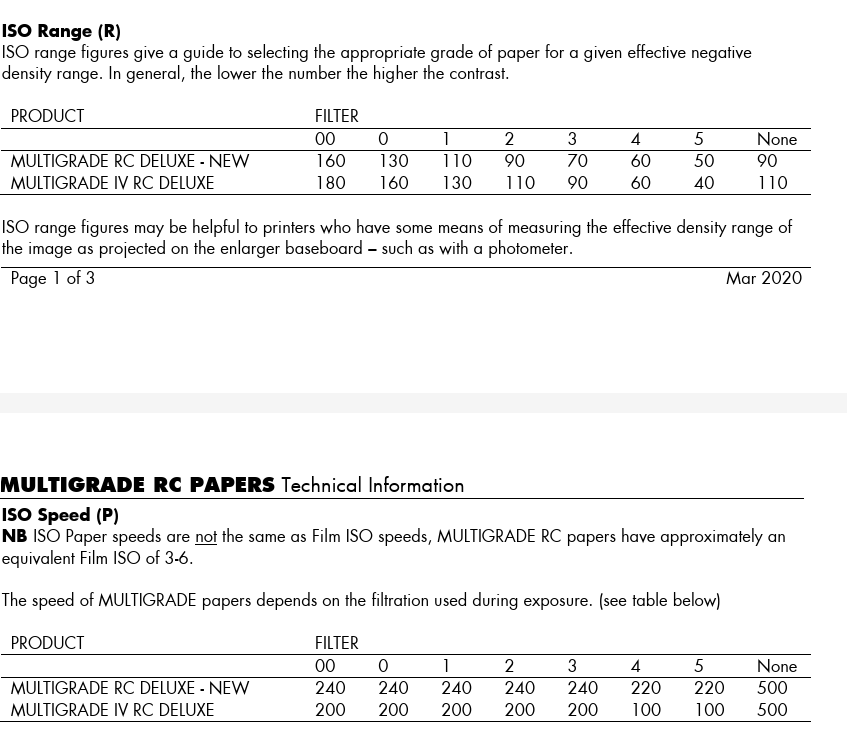

My apologies - I incorrectly shared the ISO range numbers, rather than the ISO speed numbers, for the Ilford papers.
Here is both sets of information from the comparison datasheet issued in 2020:

Ilford Multigrade IV: grades 0-3 ISO P 200, grades 4-5 ISO P 100 (warmtone 1 stop slower)
Kentmere VC select: grades 0-3 ISO P 320, grades 4-5 ISO P 160
So the Kentmere paper is significantly faster than the Ilford brand product. The Ilford RC Deluxe papers are 240/120, so in-between the ones mentioned above.

What none of this explains is why the Ilford MGIV grade 5 print came out so much lighter than the Kentmere # 5 print. That the Kentmere #5 print is several stops too dark compared to the Kentmere #1 print is perfectly sensible in my view. It's conceivable that the Ilford #5 print came out relatively light due to a loss of speed of the faster emulsion in the 16 years since it expired. If that's the case, I would expect that this paper's intermediate grades (e.g. 2 & 3) will have a lower effective ISO-R than fresh paper. A fresh pack of paper and some quality time with a Stouffer tablet could be enlightening.
