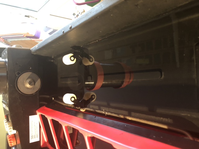

I have tightened the screw up and the magnet is firmly attached to the motor shaft. However, the problem won’t go away. What the tank rotates there is do much lateral movement that the whole thing wobbled and judders. I can sometimes get it to estate more smoothly, but this is by trial and error rather than method, and the wobble returns if I detach the tank and replace it which, obviously, I would when processing for real. Even if the rotation starts smoothly, after a few minutes it is usually wobbling so much that the magnet detached itself from the bottom of the tank...
There is a little movement in the motor shaft, but it doesn’t seem excessive to me. The real problem seems to be that the tank is not sitting properly on the roller supports. This little unit isn’t really attached to the ridge of the bottom of the water bath but seems to move about, rocking with the rotating tank. In fact the ridge that it is supposed to be attached to doesn’t seem to line up with the motor shaft at all, and do the whole thing seems impossible to align correctly. I guess I must be doing something wrong, but I can’t think what it is.

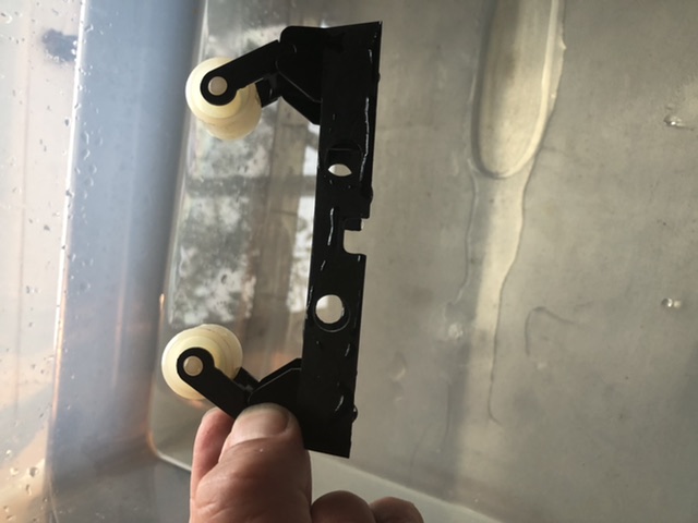

I have tried to show the alignment (or lack thereof) of the motor and roller supports, and the roller support unit on its own, because I am not convinced that this is the whole unit at it should’ve assembled. Thanks

Are you placing the rollers at the extreme end of the tank?
I see the misalignment you speak of... I wonder if it has been assembled from differing generations of the same unit and the shaft spacing was different? It might be a roller assembly from another model Jobo...

I am now running it with water just in the heated trough, not touching the rollers, and it is rotating much more evenly. I think part of the problem is that once in the water the rollers float and so become unstable. They can’t be fixed to the bottom of the unit at all. Is this normal?

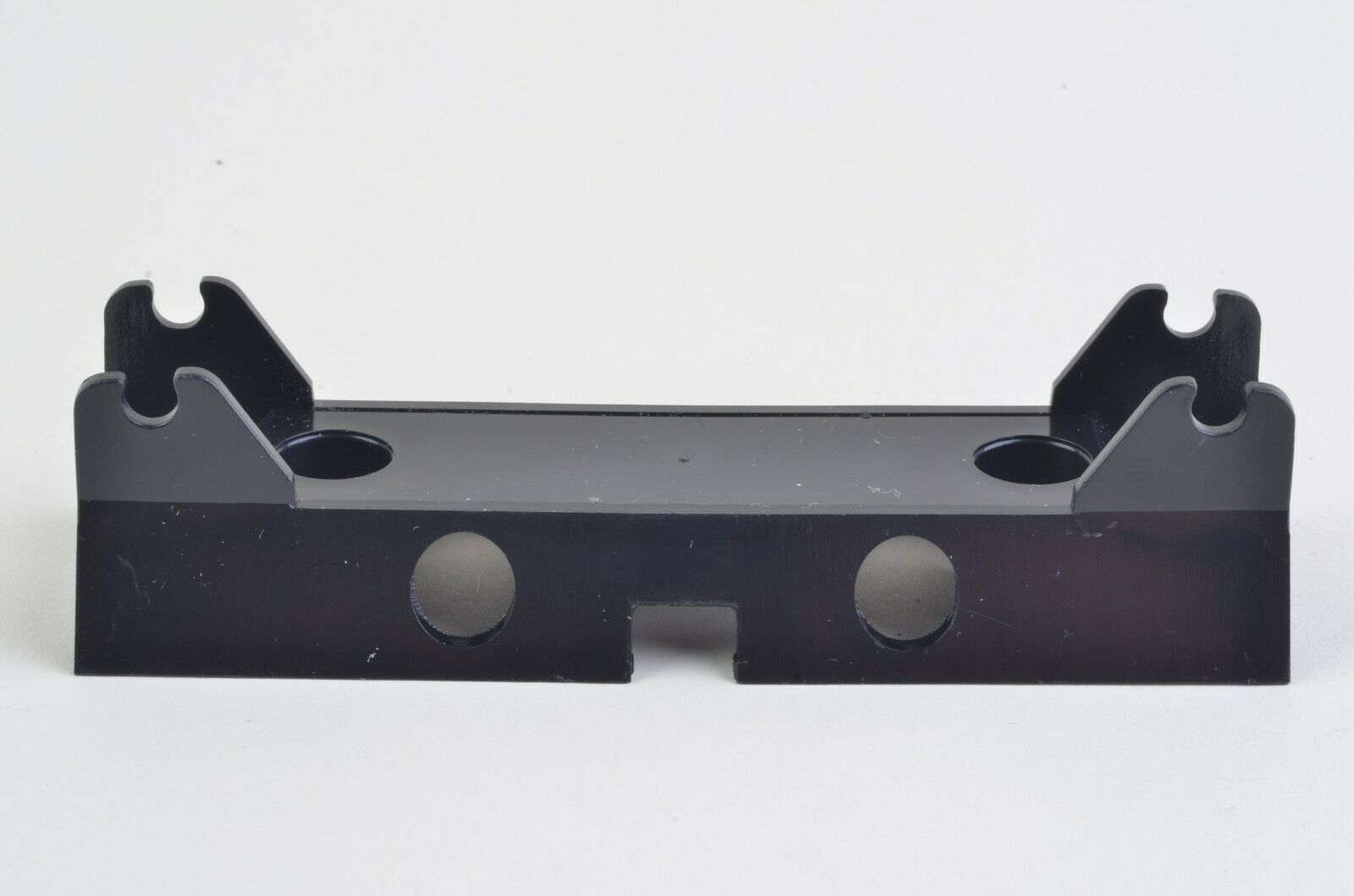

No. That is why I think you might have an incorrect roller assembly. This is what it should look like. You might have an assembly for a lift head model.
Although I have owned both types in the past, i cannot remember if they are interchangeable, but I don't think they are...
This photo is from a US auction on Ebay and is going off soon for about $26USD. Might be able to switch out the rollers and make it work.

The donut magnet on the machine can come loose from the plastic she'll and may need repair/replaced. The roller carrier should snap fit to the ridge of the trough. If the roller carrier is worn or cracked it won't stay firmly affixed.

There is a central ridge running down the center of the shelf in the water bath that should line up with the motor shaft. The roller mount actually clips onto that ridge.

I do not see a misalignement. We should not overlook the position of the camera and its optical axis.
Much better would be a position with the optical axis
-) parallel to the center ridge
-) right above the ridge
