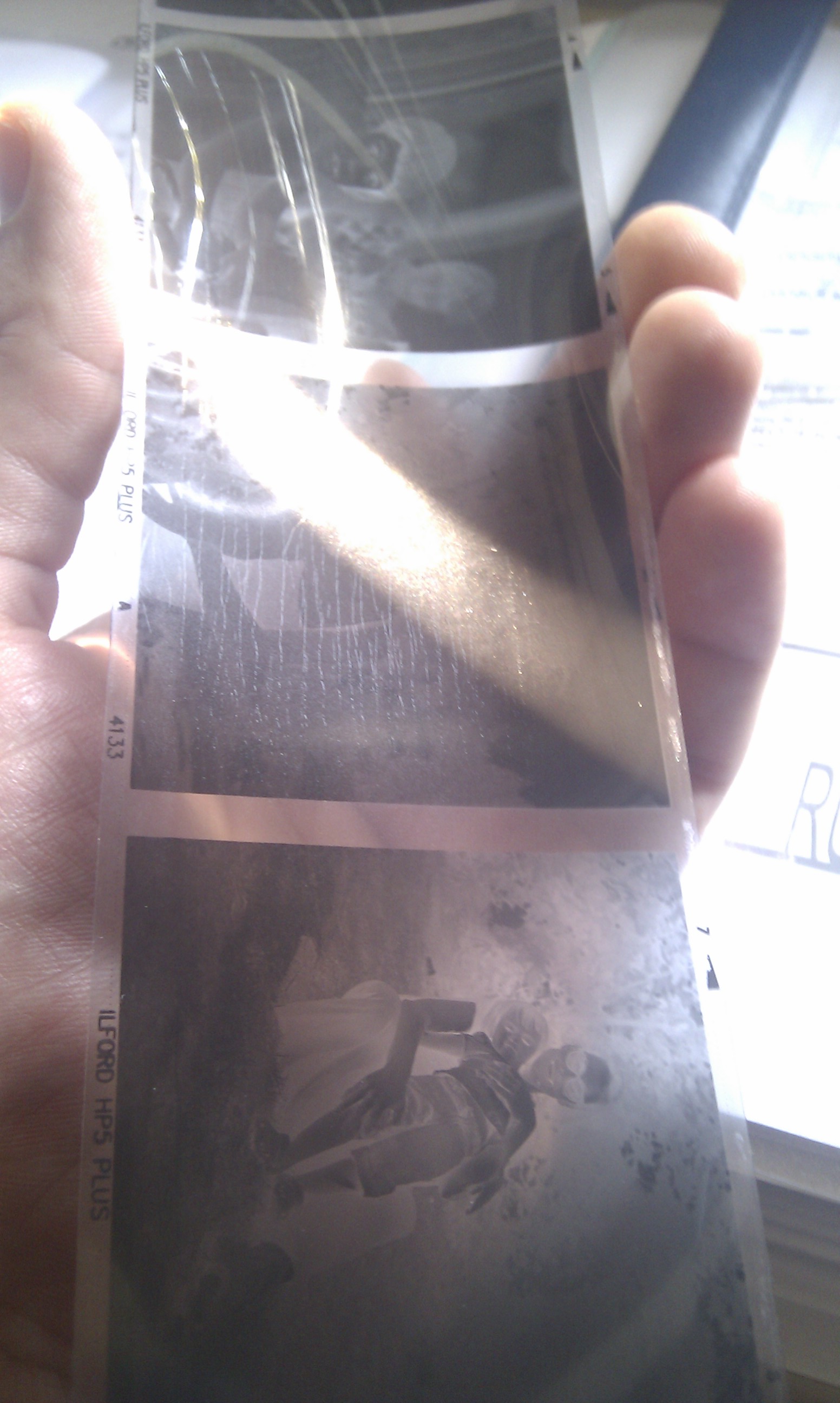

I posted this on the large format photography forum and they suggested that I post it here as somebody from Ilford visits here.
I have a problem that I thought was me at first but now I am thinking it is something wrong with Ilford film. I shoot HP5 across all formats, and recently in the last few rolls of 120 I have gotten wavy lines that run across the non emulsion side of the film. At first I thought it might have been the camera that I was using, but then I developed another roll that I had put through a different camera. The lines looked the same. Then I thought it might have been from me squeegeeing the film so I stopped doing it and the lines were still there. So I figured it was something with the medium format film I had. But then I just developed 2 sheets of 4x5 HP5 and the same lines were there. The lines ran straight across the whole sheet on the non emulsion side. With my sheet film nothing touched the film at all except for liquid and its time in the film holder. I didn't squeegee the film nor did I touch it with anything and the lines are almost the same. I have attached three photos that you can see the lines in on a sheet of film as well as from a roll of 120. Has anyone ever seen anything like this and what could be causing it? For the record both films were stand developed in Rodinal for 1 hour with minimal inversions at the beginning and 2 inversions at the half way point. Dilution was 1:100.
http://www.flickr.com/photos/alex1345/9522582212/
http://www.flickr.com/photos/alex1345/9522582882/
http://www.flickr.com/photos/alex1345/9522582806/

Are we talking about the white marks in the pictures? They really do look like some form of deposit rather than scratches, which would presumably be some kind of deposit from water and/or drying agent, or some external deposit onto the film while wet. Does a rewash have any effect? And can you identify anything more with a strong magnifier (or even access to a simple microscope)?
Other than that, I don't think anything more can be deduced from the samples as shown here without examining the actual film, and Ilford themselves would seem to be the best people to do this.

From the pictures I see faults presented different. Photo 2 and Photo + Photo 1.
In Photo 2, if you look (reflected light ) you see scratch on the surface of emulsion or support?
Or failure seems to be in depth of film?
Examine negatives in reflected light (the emulsion and support).
Watch the light shine emulsion and support. If everything appears continuously without failure, then the problem is inside the movie. Is not a sratche surface that shines in the film depth.
I saw some problems that seem to me somewhat similar, the other negative (cine).
In the form of points with a small tail. We have told comets.
After my appreciation the depth were in the film.
These problems we saw and on virgin film. Veiled negative after development where these issues were is not black but bright white.
An correct evaluation can only be made having the film in hand.

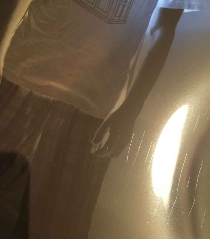

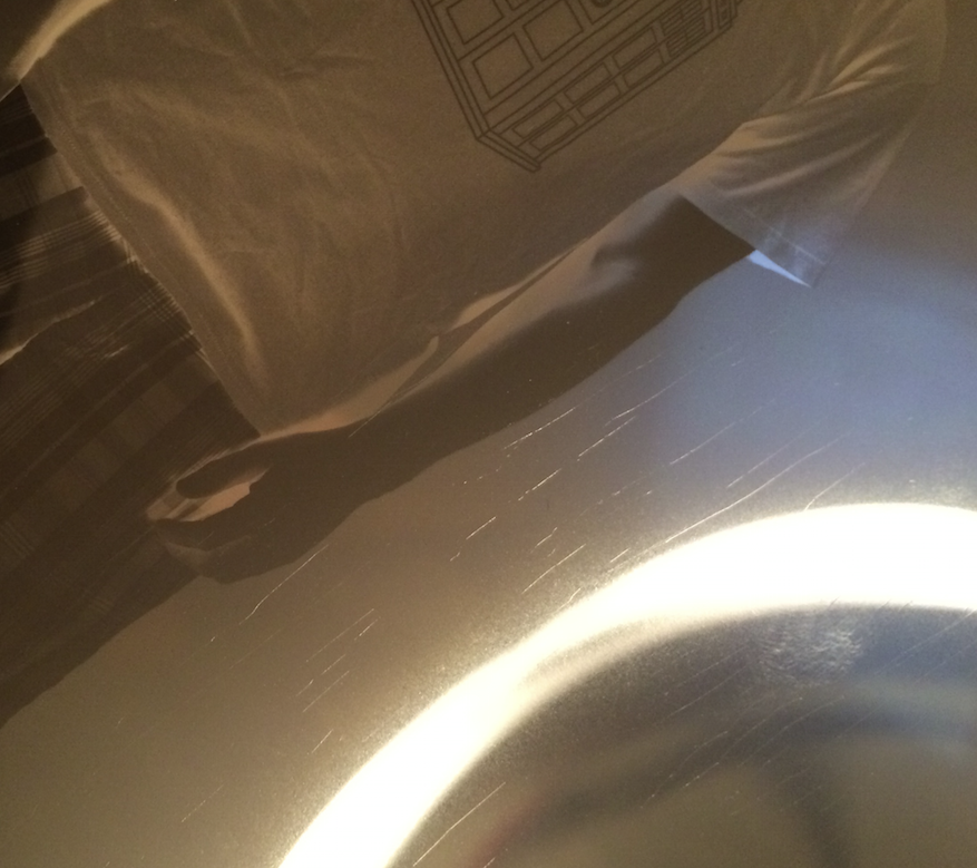

Hello,
I just ran into the same issue with an 8x10 sheet of HP5+. The wavy lines/striations DO NOT seem to have any negative impact (they don't appear on the scanned version, or in optical printing). I don't think it's a manufacturing issue, however I'm wondering if anyone had sent their negatives in for inspection to find out what the cause was (chemical residue, type of water (hard/soft), or user error)? I've never had any issues with Ilford products, and even though these lines don't seem to have an impact on the final image, I'm curious if there's a way to prevent them? I'm attaching some images of the neg with the light reflecting off the lines for examples. ...All that being said, I still love Ilford film, and always hope that one day there might be a sheet version of the SFX200 in 4x5 or 8x10..... (wishful thinking!).
