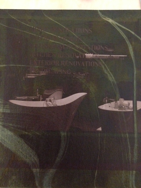

I've kept on experimenting with my process over the past few weeks. Turns out I had beginner's luck—I've been battling several new quirks.
Overall I'm getting good density and even coating, except a large number of my images exhibit weird iridescent streaks, sort of blue/green in tone. (picture attached). The marks appear with exposure of the paper—with washing/fixing they dissipate, but are still noticeable. Any ideas what might be causing this? Contaminated silver nitrate? Or possibly uneven coating of albumen?

I also should add that (in regards to the streaking) I recently purchased some kaolin and added that to the silver nitrate. It has turned a medium yellow colour in the past week due to the floatation method I've used for coating. Hopefully that helps.
pschwart
Jul 15, 2005
1,148
San Francisco, CA
Try sensitizing with a rod -- it's easier, yields more consistent results, it's more economical, and it doesn't degrade your silver nitrate since it's one shot. I think there are other things going on, too, but I can't tell what I am looking at when viewing the uploaded image. I'd suggest eliminating toning from your workflow until you can get a perfect fixed image. That should help you zero in on the problems.
