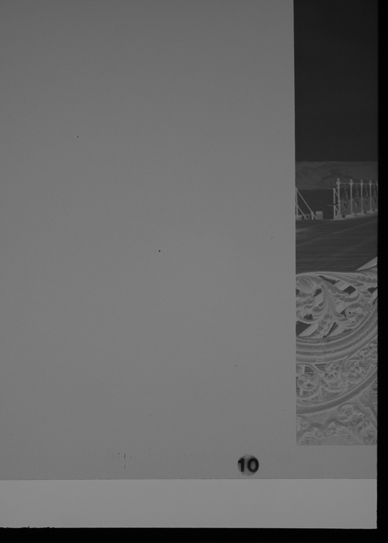

I just developed a roll of Fomapan 200 (120) from a recent purchase.
Although it came from a Fomapan box, the edge markings say Ultra 200 0107. Batch number on the box is 0107561, expiry 5/2015. I am presuming this was intended to be Arista.EDU for the US market but was reboxed for whatever reason.
Looking closely at the negatives I notice a pale line each side of the roll extending the full length of the roll. This does not form part of the normal rebate.
Haven't seen this with other rolls of other film types I have used (Ilford HP5, Shanghai GP3) in the same camera, however, and this is the first roll of Foma 200 in 120 I've ever used.
It was shot in a Fuji GS645S with a red 25A filter, underexposed by a stop or two because I didn't allow enough for the filter factor.
Developed in CaffenolCH(rs) for 15M@20C, 30 seconds initial inversions then 3x inversions at 60s intervals.
Water stop, then Ilford Rapid Fix (1+4) 4mins, and Ilford wash regime.
I have included a link to a photograph of the negative (on Flickr)to illustrate the issue.
Note that the lines are slightly inboard of the mask, and it is visible evenly along the entire length of the roll. I have slightly boosted contrast so that it's clear in the photograph, but it is easily visible to the naked eye. The example shows an "accidental" frame that happens to illustrate the issue clearly

You seem to have 3 different minimum densities there. One is the edge, which should be base + fog only, one is the center unexposed area which also should be base + fog, and the third is the pair of lines which are in question.
So, how come the b+f is so high, and has 2 values, one on the edge and one in the unexposed center area? If we can explain that, maybe the two edge lines can become more understandable.
Can you shed some light on this?

You seem to have 3 different minimum densities there ... If we can explain that, maybe the two edge lines can become more understandable.
That's a very acute observation.
It had not occurred to me to consider it in this way, but I'm sorry to say I have no light to shed - hence my posting!
It looks like agitation problems to me. Quite apart from the 3 bands, there's a cirrus-like streaking effect across the middle of that unexposed frame that speaks of either chemistry contamination or weird fluid-flow issues during development.
Are you doing inversions or the twirly-stick? How fast? How often? I would suggest testing in a commercial developer too in case your caffenol is causing problems.

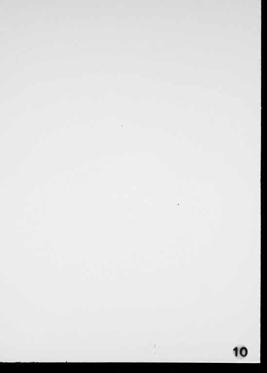

How viscous is this caffenol stuff? The film certainly doesn't look even in the middle of the blank frame - and that should be a completely smooth tone. Possibly that central variation comes from the piece of paper (or whatever) which you were using behind the negs?
Martin, I can't guarantee that that was a completely unexposed frame, plus the negative was indeed photographed against a sheet of paper.
I can't re-examine or re-photograph the negative on a lightbox as it is part of one of the strips I sent to Foma at their request.

in the meantime, I have another roll in my Fuji 645, and I have deliberately left an unexposed frame on that roll for comparison. It will go through D76 1:1 which should at least establish if it is a developer &/or technique problem, or an emulsion problem. I'm expecting the former rather than the latter.

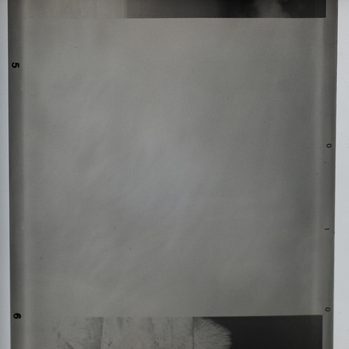

I've now run another roll through in D76 1:1, 8:30@20C, 30s inversions + 5s inversions every 30s. Same Paterson Universal Tank.
As we can see from the attached negatives (shot on a lightbox with macro lens), the apparent uneven density is no longer apparent, and the "edge lines" are entirely absent.
So, it looks like it was Caffenol what done it, in the kitchen, with the tank ...
Pity, as I have had excellent results with Caffenol previously and found I prefer it to D76 (Caffenol's a bit "sharper" to my eye); however, this is the penalty of using non-standard developers. I still remain curious how such a uniform effect along the entire length of the rolls could have been formed in the first place.
It'll still be interesting to see what Foma's engineers have to say, but I shall drop them a note anyway with this finding.

The problem with Caffenol is that there is a fair list of films that do not really like it. Caffenol is still in the "alchemy" realm, meaning that no thorough scientific work has been published on it to date, and no company is backing it either. You are left to internet fora and own experimentation for information that is often contradictory and/or incomplete. Not that it is a reason not to use Caffenol, but you should do so with care, and for every new film be sure to test thoroughly. One thing to never do, is develop an important film roll in a developer previously untested for that film. That goes triply for Caffenol, because the guidelines are somewhat vague, to be honest, and much of the info is scattered all over the place instead of a comprehensive fact sheet. I made the mistake of developing TMax400 in Caffenol according to the general instructions, and overcooked it by at least two stops. It took me a while to find out that TMax400 is one of those films not to develop in Caffenol. In fact the inconsistency and unpredictability have put me off caffenol for a while. Not to mention the smell.
Yes, I researched Caffenol thoroughly before starting using it, and as I said, this sort of result is the penalty for using non-standard (by which I meant non-commercial) developers.
So long as one goes into it with one's eyes open, and one doesn't expect perfect and consistent results across all films, it's good fun.
I've stuck to Reinhold's blog for my source data, and the information he presents there is clear and consistent. There's certainly a lot of "just throwing in a spoonful of this and that" sort of information floating about elsewhere, which doesn't help the easily confused, of course. I'm quite surprised to find a problem with Fomapan 200 as many others are using it with Caffenol without problems. However, who knows what's in my coffee ?
Another one to avoid with Caffenol is Rollei Retro 400S, by the way
I have to say, I simply don't notice the smell as being any more noxious than other photochemicals, or indeed many household cleaners.
Caffenol is a bit "sharper" because it's not got much in way of silver solvents (sulfite). You can make D76 look more like that by using higher dilutions (and correspondingly longer times) to reduce the solvent effect. Or you can use Rodinal which has no solvent action at all.
