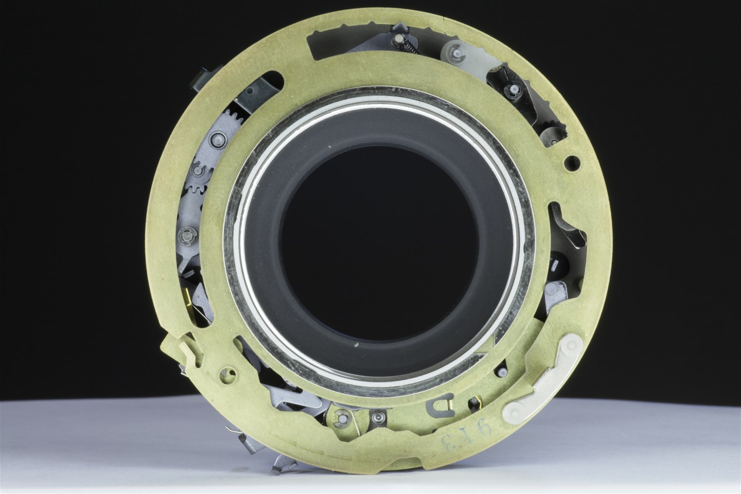

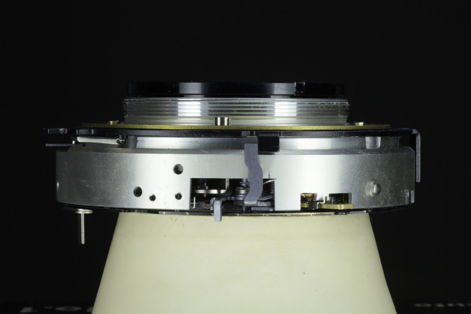

This is what is located behind the lens body flash-PC terminal, this is the shutter from an RB67 150mm lens, I believe the same shutter is found in the 65.
The small round stubby terminal about 3/4 the way between the center and the right hand edge is the connection between the internal shutter flash actuator and the external terminal. The design is a sliding contact that is necessary to permit dismantling of the shutter.
Slightly to the left and lower down can be seen the tip of the yellow brass lever that operates the selection between M and X sync.
For those curious here is the face-on view
The brass face rotates for shutter speed selection, around the rim the V notches between 11 o'clock and 2 o'clock are the detents for the speed settings. (this shutter died from failure of the three slow speeds).
The lever referred to above for MX flash selection is at 8 o'clock.
