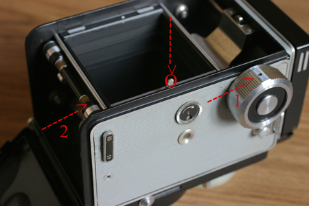

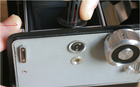

I have made 2 pictures (of a Flexaret VII) to see if there is a problem on film advance-counter.
The counter works when roll "2" turns (clockwise) with button "0" firmly pushed.
Try it as you see on second pic; number 1 is longer to see on counter window.
When this camera has not worked for years, this roll may get jammed; turn and turn again to unjam.

Thanks for the pics, they really helped. I tried doing what you suggested in the second photo. The counter turns for three clicks before the "1" shows up, "2" through "12" show up normally after that. I tried this three times with the same results.
It also seems a little stiff, but I don't know what it's supposed to feel like.
Of course once I put film in, the "0" leaves the window but nothing else comes in
