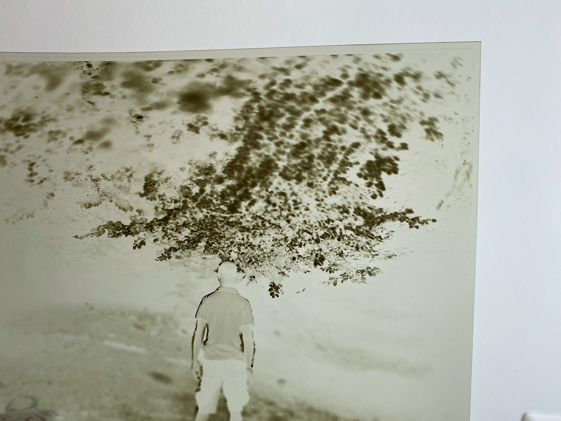

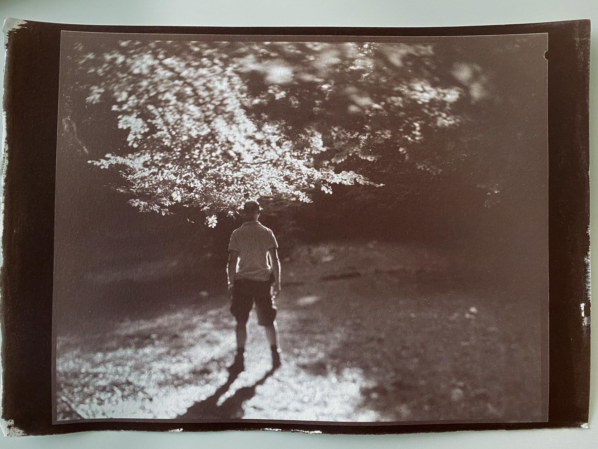

I recently started printing Kallitypes after having had little satisfaction with the Van Dyke, and Ziatype
I would like to find out if someone can help me solve a problem on the quality of the result.
About my prints I am not satisfied is the not deep tones in the shadows and especially where the film is transparent.
I also tried to add 3ml /l dichromate in developer and I started developing films, Foma 100 8x10, in Pyro PMK because someone told me it increases the contrast in general, but it seems that the staining does not pass UV well and gives me this problem. Maybe it's also the not transparency of this kind of film? As a development of Kallitype I use Sodium Citrate + Ammonium Citrate 8min, citric acid 5 min, EDTA 5 min and finally fix 1 min.
I attached two photos of one negative and its relative print on Arches.
Anyone have any idea how I can improve the result?
Thank you so much!

Have you tried increasing the exposure time? Looking at the print, the darkest part of the image, the shorts, are not as dark as the border where there is no film - but the difference is not that great. Whites are not at their limit so increasing the exposure time should boost the Dmax without staining the highlights - I would think.
:Niranjan.
thank you Niranjan!
I think I would lose mid-tone brightness and risk losing the overall brightness of the print.
But I have just read in a text by Moersch that the clarification he advises only by 5min with citric acid in order not to fade it too much. I make it with both citric acid and EDTA 5 + 5 minutes, can that also be the reason for the fading?

Generally for neg/pos processes: If the border, which received more exposure, is dark enough, just the image isn't, then the solution is more exposure. If that would make the light tones too dark, you need to increase contrast; I don't know if there's a variable in the Kallitype process or if you need harder negatives.

Hi, Stefan:
You can do a test print with half with citric + edta and half without edta and see if that makes a difference. Fixer can reduce the density too. What fixer are you using...alkaline? I have not seen folks using dichromate in the sensitizer in any literature - wonder why that is. In general, dichromates in the sensitizer increase contrast in siderotypes so that might one variable that can be explored.

Hi, Stefan:
:Niranjan.
Hi Niranjan!
I put the dichromate in the developer not in sensitizer. For contrast control in Kallitype you can do only this thing.
So I tested other two prints without EDTA and only 4 minutes of clarification with distilled water and 3% citric acid finally I think is much improved! As in the Christopher James book I read, EDTA bath is not required with the developer Ammonium Citrate. In fact, after the development bath, the paper already seems enough clean of iron residues.
For those who want to see the result I have published it here:
www.instagram.com/stefano.bernardoni/
Unlike the previous one, I also slightly increased the contrast and consequently also the exposure.

That's a great improvement....I am glad it worked out. It is much harder to have a negative and make the process work for it than fix the process and adapt the negative for it (which is what I do.) so I am always impressed by people who do all analog alternative processes.
