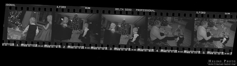

Ok,
So I did a test run, by clipping off the first 5 frames and ran that for 11 minutes at 1+20, 3 slow agitations each minute.
These came out fair, a little thin, but printable I think, certainly scannable, good to see that I wasn't way off though.

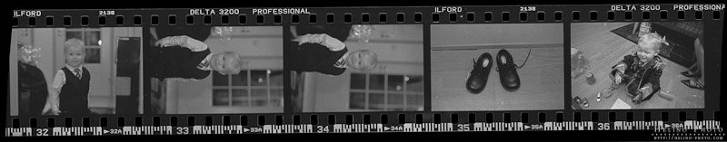

Delta 3200 @ 1000 for 11 minutes Tetenal Ultrafin 1+20.
The rest of the roll was developed for 13 minutes 15 seconds in a 1+20 dilution and these came out very nicely infact, the negatives look thicker with better highlights, but not overly done. \o/
So, from the test today, I'd say that Delta 3200 @ EI1000, developed in Tetenal ultrafin 1+20 for 13 minutes 15 seconds, 3 slow agitations each minute works! :cool:

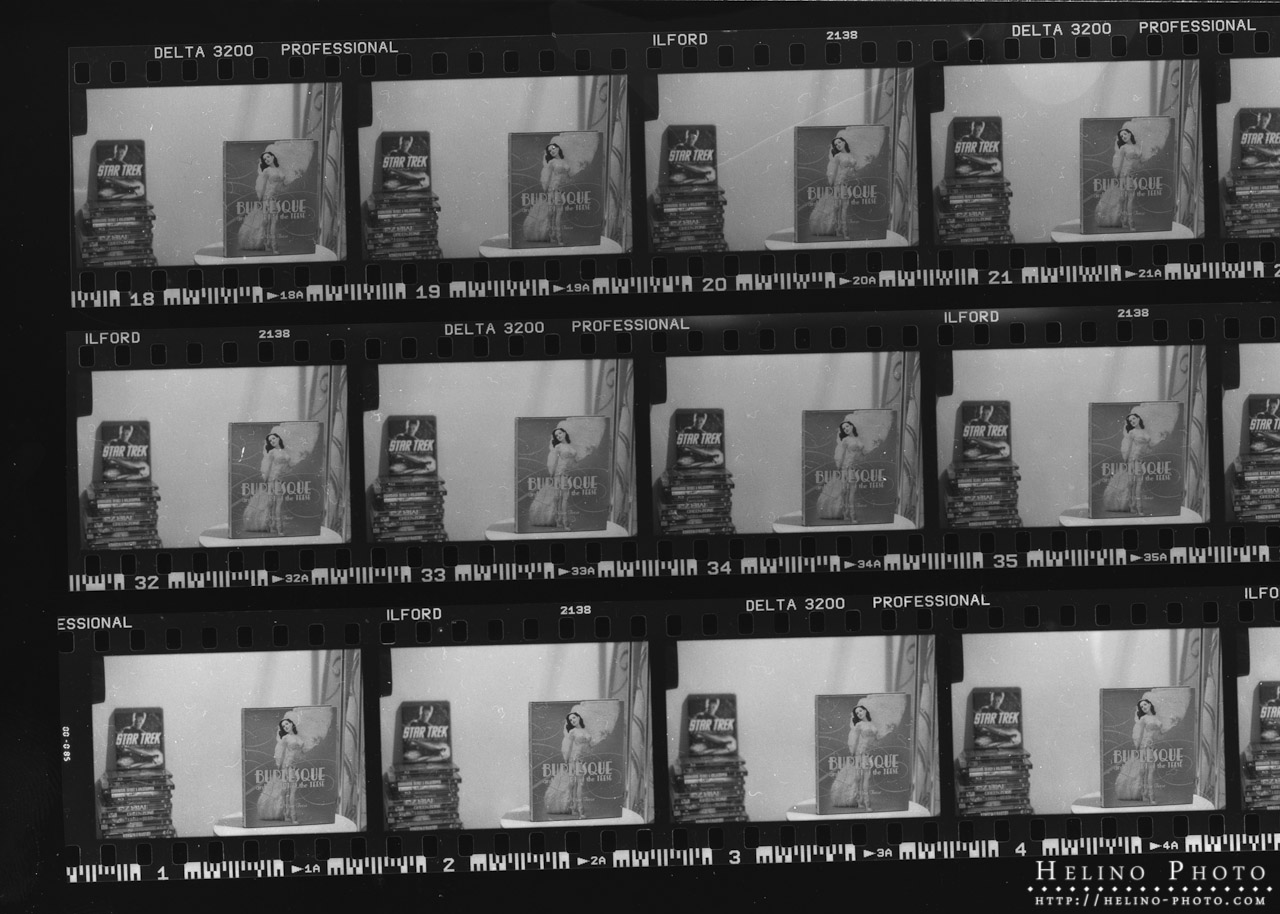

Here is a sample scan from a test-strip I did in the dark-room, 13 minutes at the top, 15 in the middle and 17 minutes at the bottom strip.
The camera was set to ISO 1000 and the wall metered one stop above Dita Von Teese at the front cover (great book to steal poses from btw =) ).
- First time I used the motor drive and "H" on my 1v, the whole film took about 3.5 seconds to burn, haha =)
It actually seems like you could develop the film even longer than 17 minutes for some real highlight zing.
