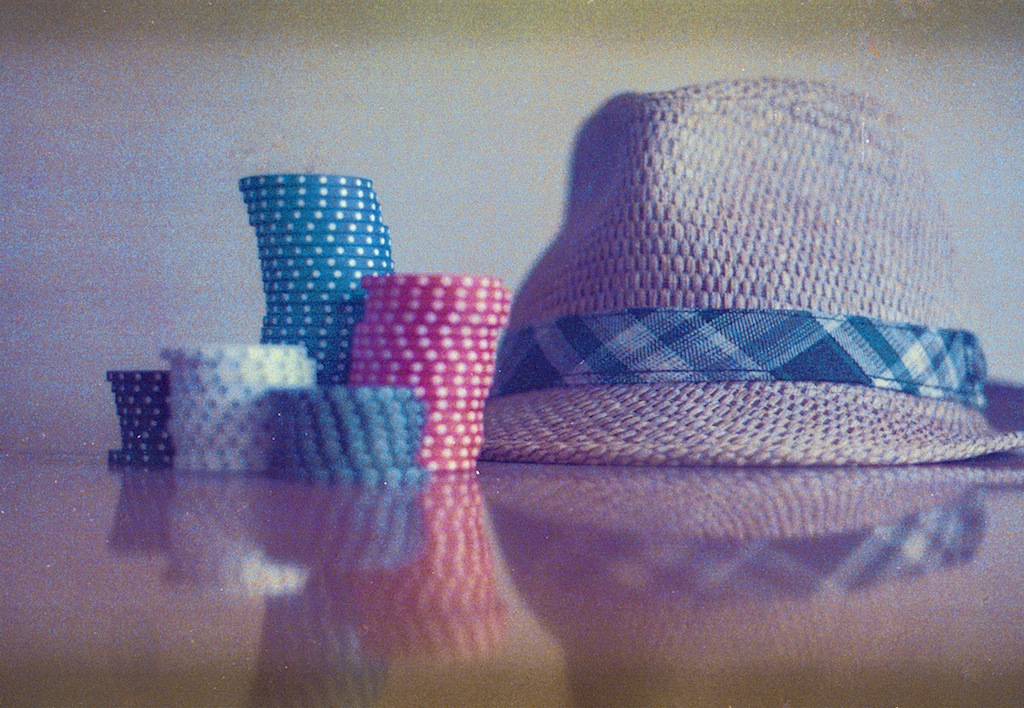

I recently got a roll of Kodak Vision 2 500T film. I've tried a few test rolls developing in both C-41 and B&W. The results I've gotten have not been good. I understand that ideally this should be developed in true ECN-II chemistry, and I have found the homebrew recipe here on APUG which I plan to try when I can buy the chemicals and once i know the film is good. I also know that good results can be had in C-41 (http://www.flickr.com/groups/diy_color/discuss/72157629804159613/). The results on this link look better than I had expected was possible doing this in C-41 and he claims it is without color correction.
I shot 5 identical pics metering as 100, 200, 500 (500 is the native ISO), 800, and 1600. I have read tests that show this film can be used from 200 - 1600 without any push/pull. (Dead Link Removed). I developed the test roll in fresh Rollei/Comprard C-41 chemicals. I removed the rem-jet with a washing soda presoak and an appropriate cloth before drying. Of the shots I took only the 100 was even scannable, but was still way under exposed. The first is the standard JPEG scan from VueSCAN. The second was the best i could get from a raw DNG with color correction in PS.
So where did I go wrong? Why do my pics look like crap? By the way, i also shot some outside. They looked worse.

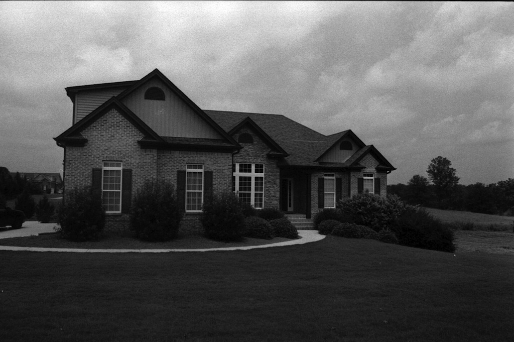

Just tried another roll as B&W, stand developed in Rodinal 1+100 for an hour (ok, 55 minutes. I'm I was feeling impatient). These results turned out as well as I could expect for B&W xpro. The frame I posted was metered at 500. I think 400 might be a sweet spot for this film. I tried some illfosol 3 following dev times for Tri-X with bad results the other day. So far I like these and at least have a good use for this film now if I cant get good color results.

Here's one from c-41 stand develop. The chemicals may be getting to old, and I had to do a good bit of color correction to the DNG, but it looks like the potential is there. I think i'll try standard (and fresh) C-41 again with longer dev times.
