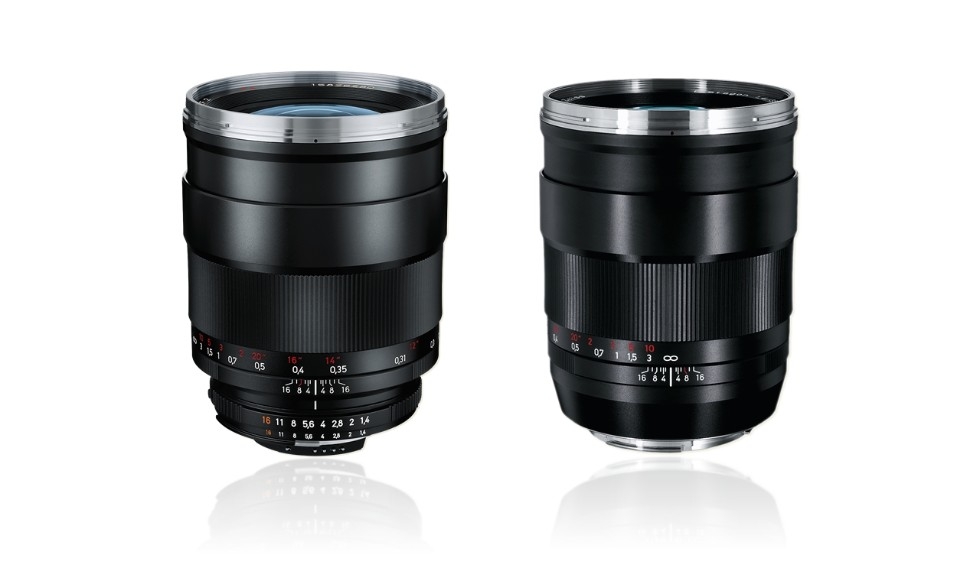

By the way : If you shot Rollei ATO 2.1 "supergraphic" 25 with EI. ISO 6 at f5,6/f developed in special developer with this lens :
Zeiss Distagon T 1,4 35mm
And your extravagant ambition is to 1.00 x 1.40 (in Meter) with 120film
It would make much sense to use enlager lenses with characteristics not below this one here :
Rodenstock Rodagan at F/8 is a need for then :wink:.

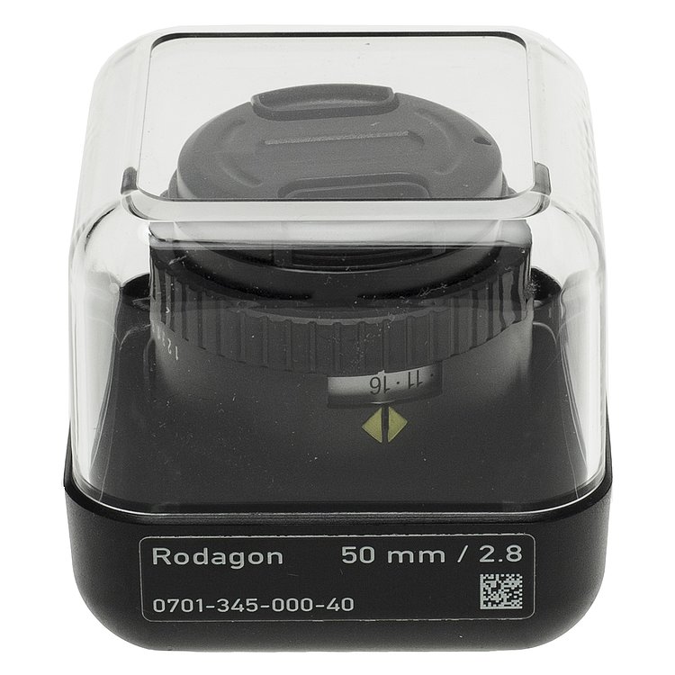

One is a 105mm Rodenstock Rodagon f5.6 (I use that for my medium format stuff)
The other is a 50mm Vivitar VHE f2.8 (From what i gather from the net, this is an American brand with Schneider or something other German glass?)
I suppose the first is rather nice, at least it cost a bit on b&h
The 50 is cheaper, 75$ on eBay
Can easily spot and focus grain with both, no complaints and I am not a Feinschmecker at all, as long as I get sharp results.
