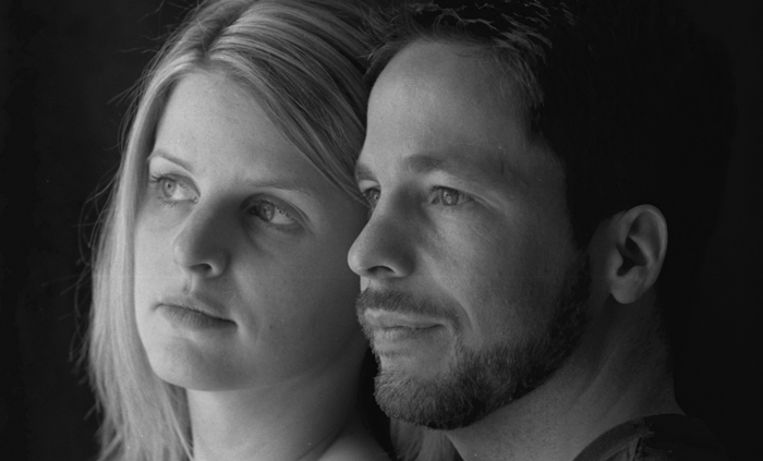

I took some engagement photos last weekend for friends, using some of my frozen TXP 220; I normally use the 120 and never had scratches but all 3 rolls of the 220 have a scratch at the same level including some of the better images; a long-horizontal scratch through some faces, just visible under their noses. It is very fine but still noticeable on the print at 8x10; not noticeable on 5x7 but they would like some 11x14's for parents. I probably have some dirt or plastic stuck in the back of my RZ 6x6 back, which I can use for 120 and 220 film.
How does one deal with this? They live in a different city so I can't reshoot, spotting a line seems impractical and can one really fill in a scratch without it being noticeable? I would love to give a nice handmade FB silver print instead of a scan/commercial print.
Thanks for advice.

wow that bites cuz that's a nice shot.
I know you can sometimes fill smaller scratches with "nose grease".
Really, you take your finger and rub side of your nose (keep you fingers clear of your nostrils :wink: )
and use the facial grease/skin cells to fill the scratch on the neg.
I swear this is an old trick I cannot take credit for.

One trick a knowledgeable person told me about but which I haven't tried is nose grease... taken from the outside of the nose with a finger and applied to the film.
Disclaimer: I don't know if it works.

Nose grease works on the non-emulsion side of the negative, and that's good, because of the fact that the scratch in your example shows on the print as a white or a lighter area.
If the scratch was on the emulsion side, it would most likely have printed dark.
You can spot out a scratch with care; it just takes a while. :smile:
Mike
Thanks everyone for your replies; the nose-grease idea was my first thought but I was unsure if you can apply it so easily. As for spotting it out, will I not have the exact opposite problem, of a dark line across their faces? As well, do you use the same Marshall oils as print spotting or is there a different material?

It looks to me that it is not a scratch. A scratch in the emulsion would cause a dark line. On my monitor it looks like a lighter line than the skin tone. I couldn't say what caused that but if that is the case and you don't want to do anything to the negative careful spotting of the print would fix it.

I don't think anyone suggested spotting the negative, it would be near impossible. Oils shouldn't be used for any retouching as they don't absorb into the emulsion, but i thought Marshals made a retouching dyes.

Spotting the print but not with oils. Spotone if still available is what I use to spot B&W prints. There is enough in each bottle to last for years.
Jeffrey
As others have guessed, the scratch might be in the base.
Have you tried printing through an enlarger with a diffusion-source?
You might not have to touch the negative.
nose grease, works
but try it on a negative to the right or left of the hero image, If it solves your problem you win.
