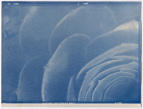

I have used cyanotype chemistry on developed and fixed x-ray film successfully - adding a bit of photoflo to the chemistry before applying definitely helped.

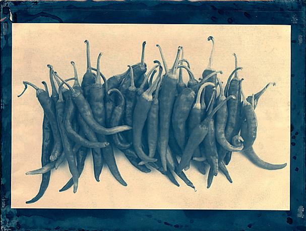

A while ago I tried using fixed, expired, FB paper for cyanotypes and would say that it was very successful. Coating the paper is a nightmare as the sensitiser solution 'beads up'. I overcame this by repeatedly brushing until the solution had dried enough. It also needed at leat two coats.
Soaking the paper before hand definitely helped and I'll have to give the photo-flo trick a go as I've recently got a new split back frame I want to try out with something.
Here's some examples. The traditional cyan image is 100% APUG friendly, you don't want to know where the source image of the coffee stained chilies came from but I'm showing it here as the resultant cyanotype is a good example of what can be acheived on old FB paper.:wink:
