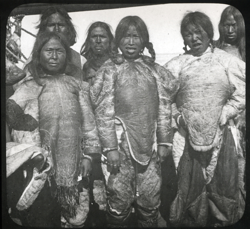

Here's my first effort. I've posted in the gallery, but thought I'd stick it here too, for members who can't acess the gallery.

The first effort looks damn fine to me. Reminds me of the sort of print that Herbert Ponting or Frank Hurley might have produced on the Scott and Shackleton expeditions. It has that look about it. Very well done
