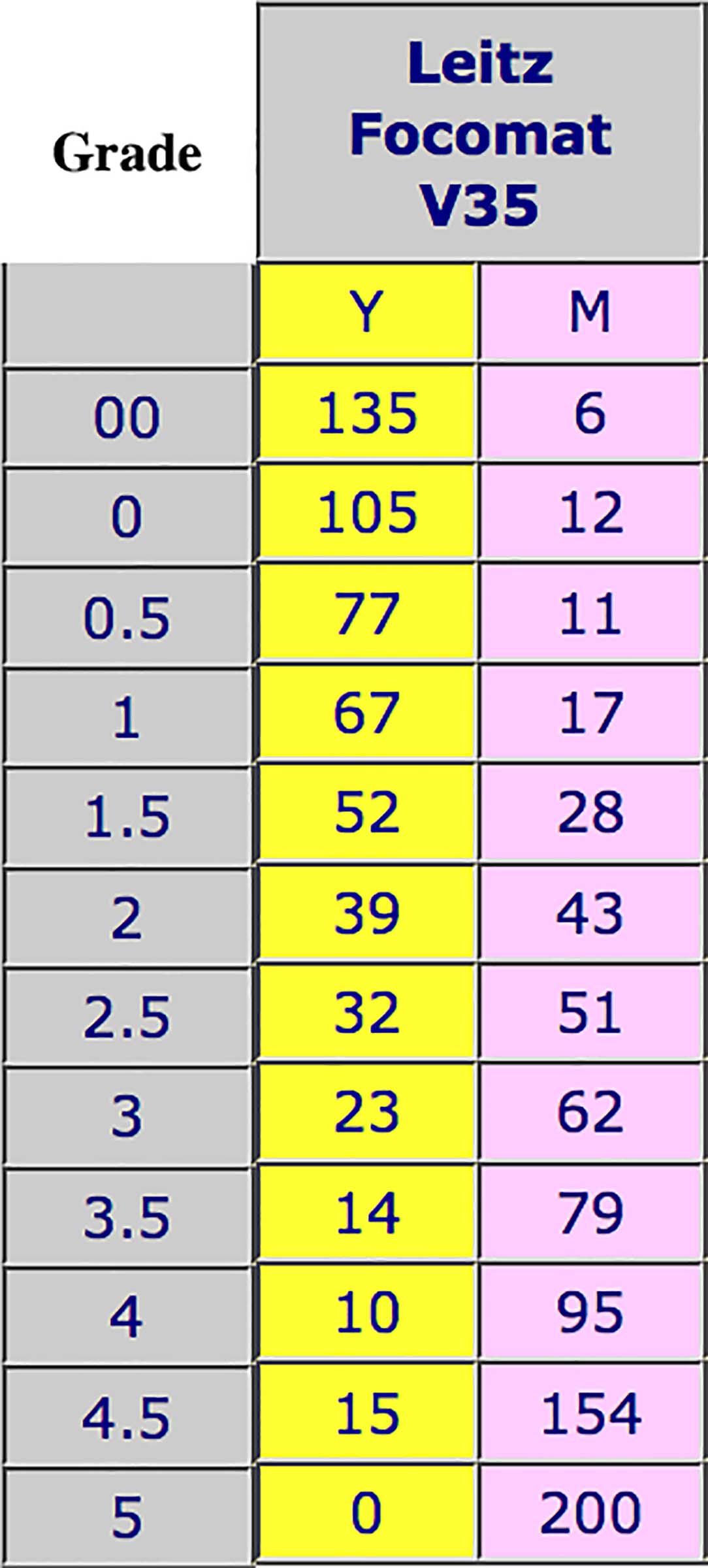

The Leica Focomat V35 came with only the color module. Sadly, I will only be printing black and white with it. I was curious if anyone has had success dialing in filter grades with this specific model enlarger's color head? And if there is a chart of settings that I can match up to filters.

Might have answered my own questions, found this chart. Think this is in the right ballpark?
Many thanks again.

There are 2 approaches to using your dichro filtration for multigrade papers. One is to use Yellow and Magenta as the chart you posted indicates. The other approach uses just one filter (yellow I believe). If I recall correctly, the advantage of using both yellow and magenta is to keep the exposure relatively constant across the contrast range. So that approach is generally recommended.

speed match works for grey, not white or black. I use white to adjust exposure and then add yellow or magenta to adjust contrast.
The advantage is just a small amount of filtration is used and little light loss. If you try to speed match, lots of neutral density is added to all grades and lots of light is adsorbed.
I use my color module and the VC module lives in a cabinet except for when I do split grade when 1 and 5 extremes only are used USUALLY.

Printed my first batch of prints last night, all went well. The chart of values worked mostly ok, exposure time was consistent across it, but contast overall felt a little low overall. I was working at higher grades than what I recall being normal in the past. Maybe a full grade overall.
Split grade printing was a breeze, results were great, I'll probably just stick with that.
