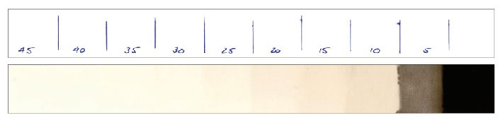

Separate opinions from facts. There is well documented research available on this, but rather than reading for days you can conduct a simple test with your materials and be done with it.
1. Cut a 1x10-inch test strip from the paper to be tested. Turn on the room lights, fully exposing the test strip for a minute. Avoid excessive exposure or daylight, as this will leave a permanent stain.
2. Dim the lights, and divide the test strip on the back into patches, drawing a line every inch. Mark the patches with fixing times from ‘45 s’ down to ‘5 s’ in 5s increments. Leave the last patch blank to use as a ‘handle’.
3. Place the whole strip into water for 3 minutes and then into a stop bath for 1 minute to simulate actual print processing conditions.
4. Immerse the strip into a fresh fixing bath, starting with the 45s patch, and continue to immerse an additional patch every 5 seconds, while agitating constantly.
5. Turn the lights on again, and thoroughly wash the test strip for 1 hour under running water to remove all traces of fixer, and tone in working-strength sulfide toner for 4 minutes. Alternatively, you can develop the strip in working strength paper developer. Then, wash again for 10 minutes and evaluate.
If the entire test strip is paper-white, all fixing times were too long. If all patches develop some density in form of a yellow or brown tone, all fixing times were too short. Adjust the fixing times if necessary and retest. A useful test strip has two or three indistinguishable paper-white patches towards the longer fixing times. The first of these patches indicates the minimum ‘clearing’ time. Double this time to include a safety factor, allowing for variations in agitation, fixer strength and temperature, and the result is the optimum fixing time. Be careful, however, not to use a fixing time of less than 1 minute, as it is difficult to ensure proper print agitation in less time, and patches of incomplete fixing might be the result. Use the optimum fixing time, but at least 1 minute for each bath, allowing the first bath to be used until archival exhaustion. After all, incomplete fixing is the most common cause for image deterioration.

So 2 x 1,5 minutes sounds like a good rule of thumb. I will conduct this test. Sounds interesting.
I did a similar test for minimum developing time. Was fun. Came to about 2,5 minutes for Ilford MGIV FB with the developer i used. Diluted 1+14.

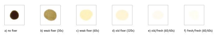

Fixing is a rather complex issue. Countless byproducts form and continue to form during the process, which is even more critical with almost exhausted fixer. Hence the recommendation to use two-bath fixing with a fresh second bath. Doubling the clearing time with film or doubling the cannot-develop time with paper provides enough safety margin with fresh fixers. In fact, fixing in ammonium thiosulfate (rapid fixer) is very rapid, usually not longer than 30 s. With a minimum fixing time of 1 min in each bath, one normally have a safety margin of 4x.
As you said, HT2 tests for residual fixer after washing. The issue here is to test for residual silver halide. This test will help to determine the optimum fixing time. You can extend the test by using a drop of sulfide toner on the apparently 'fixed' white patches and see if they 'develop' anything more than a slight stain. If they do, fixing is not complete, but this would point more to exhausted fixer than too short of a fix.
