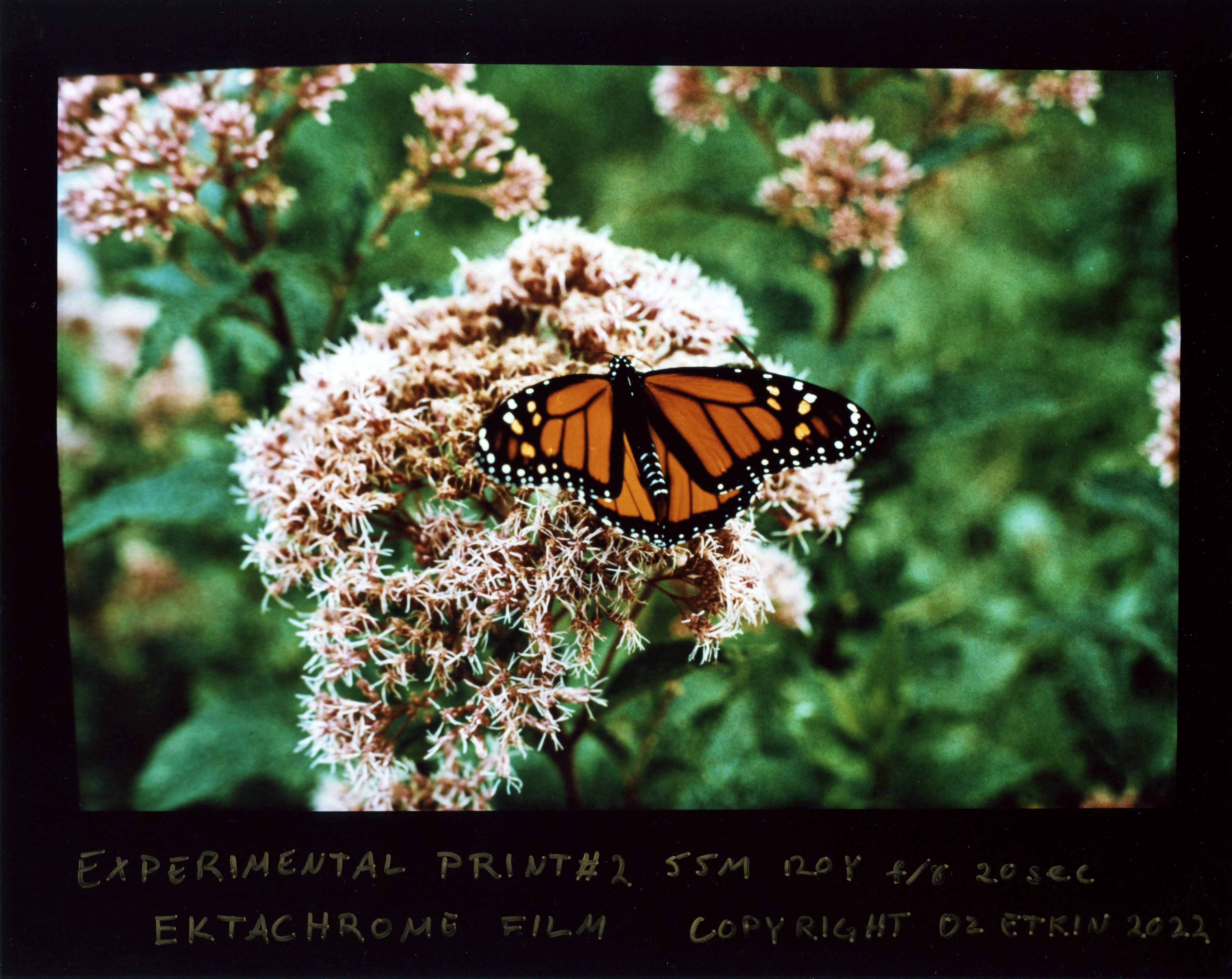

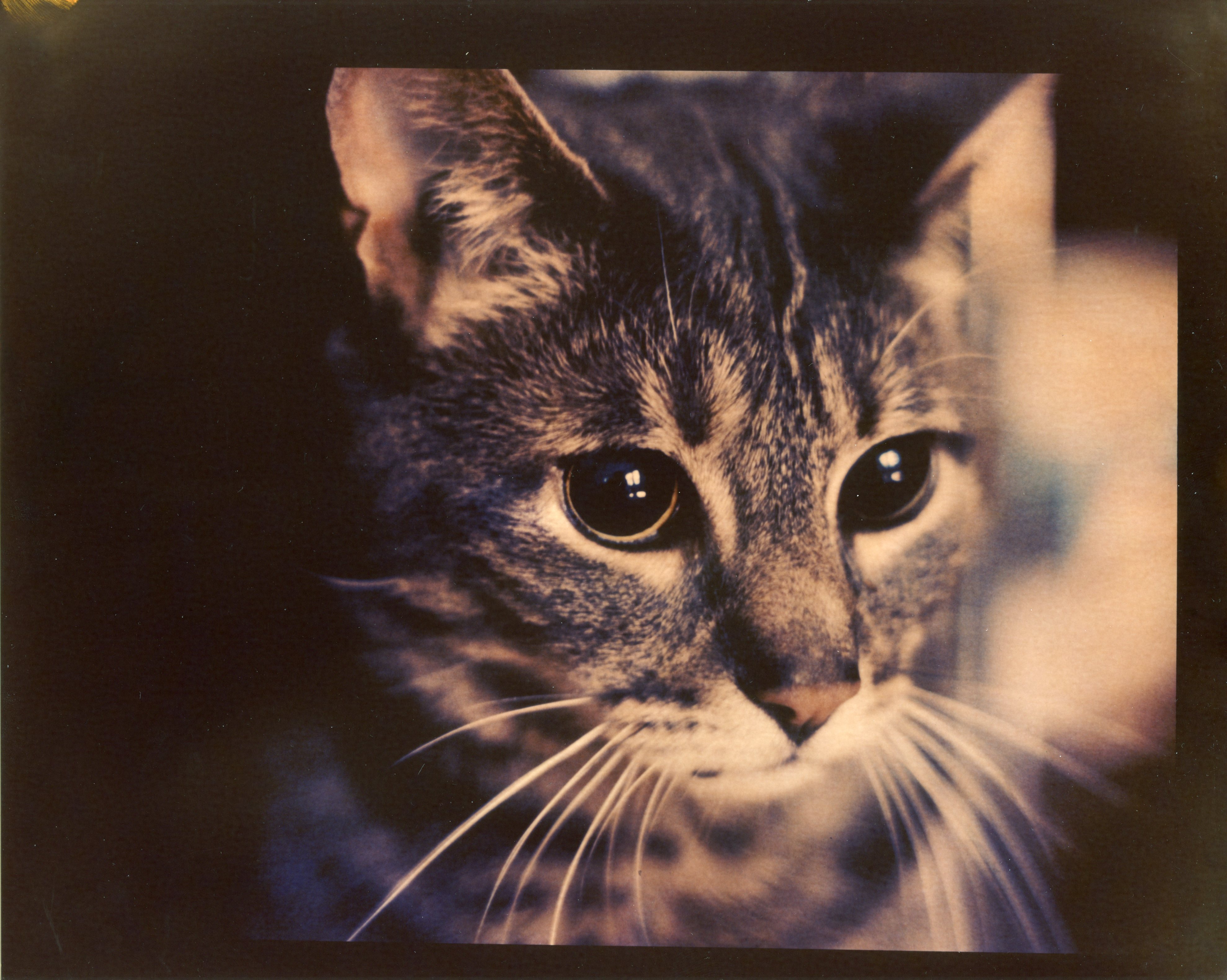

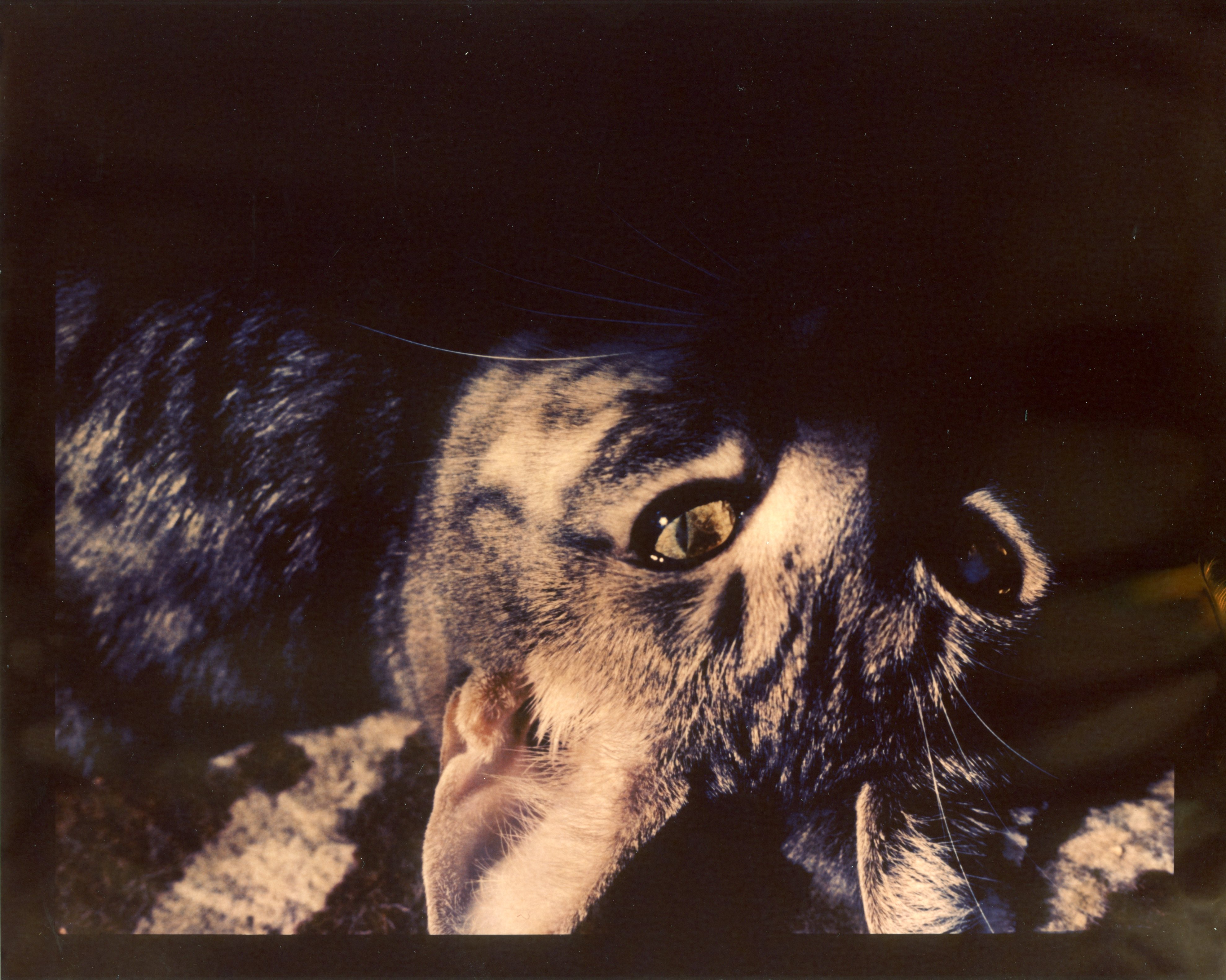

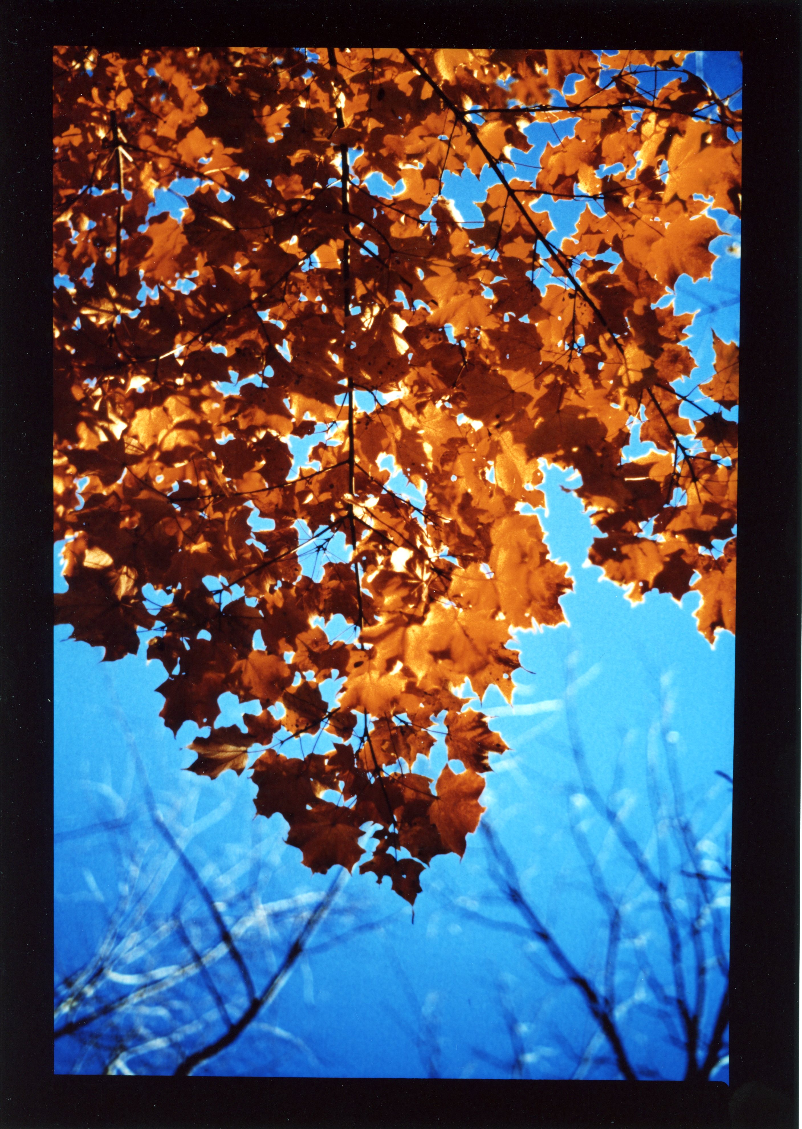

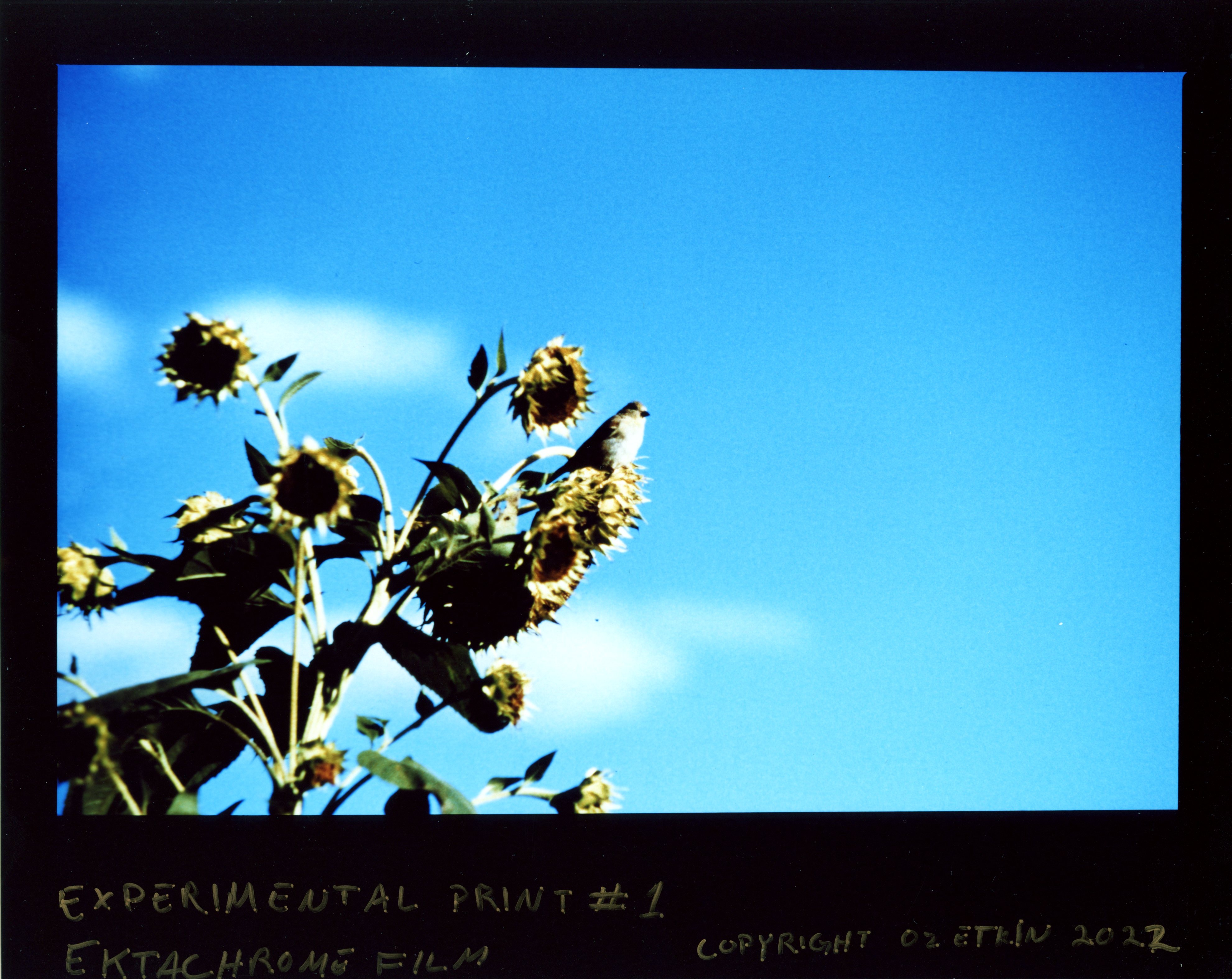

That's correct. I've done a little bit of RA-4 reversal (90 sec Sprint print dev & stop, RA4 processing in room lights), and it's not that difficult to get good looking colors, but the process produces extremely high contrast images. With Ektachrome already being a pretty high contrast film, I've found it pretty difficult to get useable results. The processing solutions also seem to become exhausted quite quickly.
Here are some of my better prints:
... and some of the not good prints:
You can see that even the better prints have issues with extreme contrast, and as the developers become exhausted there are issued with color balance.
