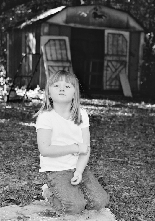

Just my 2 cents worth....I printed this last night. The film is Fuji Superia 200 iso color film. I printed it on Arista Matte black and white paper and developed it in Arista Ultra cold tone developer. No contrast filter was used at all. Exposure time was 40 seconds. I print color film on black and white paper all the time.. So far I have never had a problem.

Looks pretty good to me. Nothing funny about the person shot which seems to be different from the experience of one of the contributors. I use Fuji Superia also - usually 100- but this shouldn't make a difference. That leaves the paper and developer. Hopefully Ilford Multigrade and Nova developer should perform similarly.
If not, is Arista Matte black( presumably this is Fibre?) and Arista developer a U.S. product only available in the U.S.
I know I have come across those occasions when using colour that I have thought a B&W print would be interesting. Your print suggests that carrying two cameras may not be the only solution left.

Yes Arista is fiber based paper. I get all my Arista supplies from Freestyle in Los Angeles California www.freestylephoto.biz. And, yes it always struck me as funny that you can't print from a color negative onto black and white paper. But, I do. Now, granted, it might not have all the tonality when printing from a bw neg, but it gets very close.
