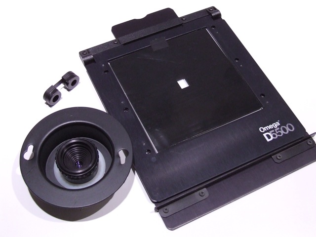

This is my Minox setup for the Omega D5500. It is a 25mm lens which will focus on the Omega D5500. I suspect there is a lensboard for your enlarger that is similar. I'm not sure about the D5, but these lensboards for the D5500 are reversible. So this one can be mounted the other way around for a long lens if needed.

This is my Minox setup for the Omega D5500. It is a 25mm lens which will focus on the Omega D5500. I suspect there is a lensboard for your enlarger that is similar. I'm not sure about the D5, but these lensboards for the D5500 are reversible. So this one can be mounted the other way around for a long lens if needed. View attachment 359157
This is very cleaver will give this a go today and report back

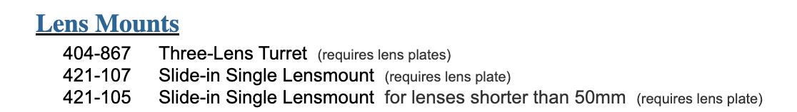

unfortunately with my 3 lens turret system i cannot inverse the direction of the lens / mount further into the enlarger / bellow
Yes, and on the Omega D5500 short lenses also are not able to be focused with the turret. You will need to remove the turret and fit the holder for the individual plates. Reads like you don't have the D5 manual? It is available on the internet.
You need what is called the Slide In Single Lensmount.
You need what is called the Slide In Single Lensmount. View attachment 359206
great ill be getting one of these then !
