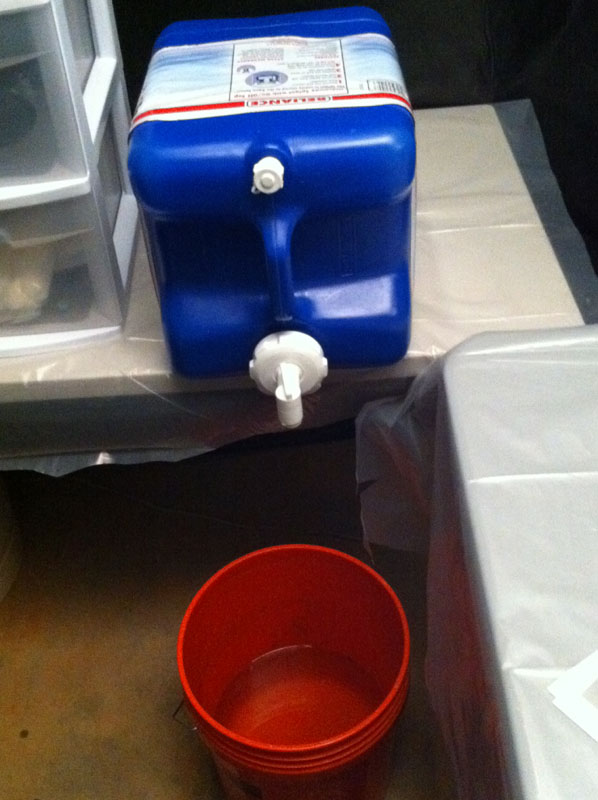

You don't need running water, even for FB. You can use successive soaks in changes of still water. This is a bit of a PITA but works well and doesn't use as much water. I don't have running water in my darkroom yet either. For 8x10 and smaller prints I can bring them upstairs and wash in the sink. For larger prints I don't have a large enough sink to wash them anyway (I suppose I could use the bathtub but that's too big.)
For FB I suggest the modified Ilford fix/wash sequence. Fix for one minute in film strength rapid fixer with no hardner. Wash for ten minutes - two soaks of at least 5 minutes each in fresh water will do. Follow this by 10 minutes with continuous agitation in a washing aid (like hypo clearing agent) then Ilford recommends a 10 minute running water wash. I err on the side of caution and do a final wash of six, ten minute soaks in trays of fresh water. It's a lot more trouble than just putting them in an archival washer and going away, but you can get a good wash, and save water too. You can learn a ton about washing prints from this article:
Part 1:
http://www.film-and-darkroom-user.org.uk/forum/showthread.php?t=296
Part 2:
http://www.film-and-darkroom-user.org.uk/forum/showthread.php?t=344
What I do have in my darkroom is a 7 gallon water jug with a spigot, that I can fill from the water hose just outside the basement door. It isn't ideal, but it works much better than you might think.

Here's what I have. The 7 gallon container is also a tremendous improvement over carrying a bucket at a time, and has a dispenser. 7 gallons can last for several sessions or only one, depending on what I'm doing. I just fill it up right outside the basement back door as needed. The 5 gallon bucket under it is for waste water (only) and positioned there to catch any drips as well. I just take it upstairs to empty as needed.
