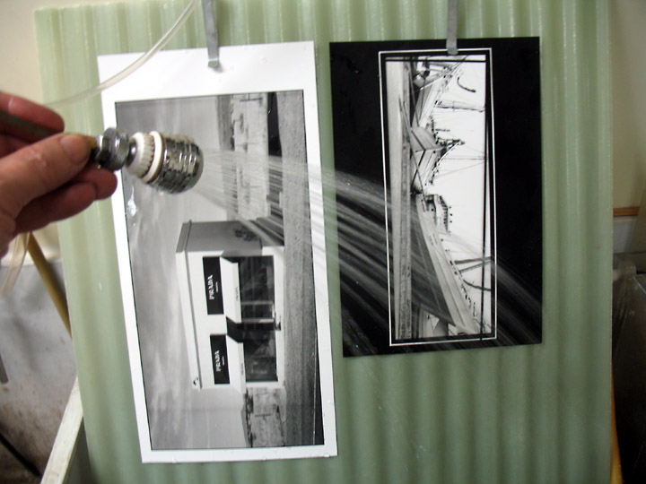

Here are two washers I use when processing 8x20 films and prints.
My first step is a one minute rinse against a corrugated backdrop.
Then into a "holding" washer, until all negatives (or prints) are done.
Then into the vertical slot washer for the final "archival" wash.

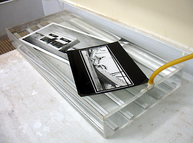

The flat (horizontal) intermediate "hold" washer: (made from 4mm acrylic sheet).
700 x 310 x 76 mm deep (27-1/2 x 12-1/4 x 3 inches deep)
This washer has a series of ridges on the bottom to prevent the film from laying directly on the bottom.
In the photo, the ridges are some aluminum strips, you could use acrylic rods, for example
A double end directs slowly running water under the inner end, and spills out over the outer end.
Shuffle the sheets occasionally to keep them separated.
This design maintains a constant water depth, and ensures water flow at all depths.

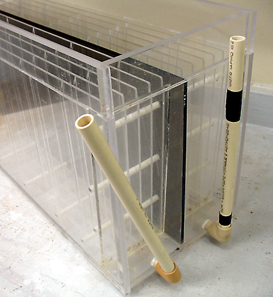

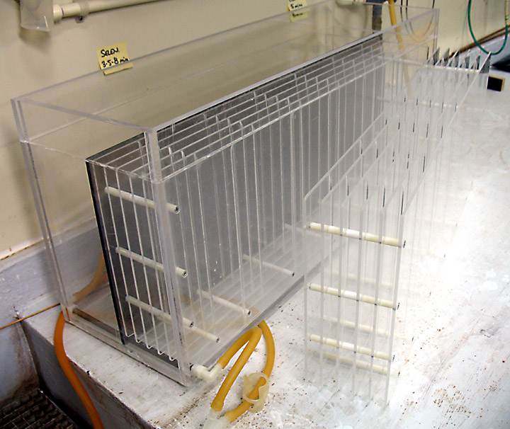

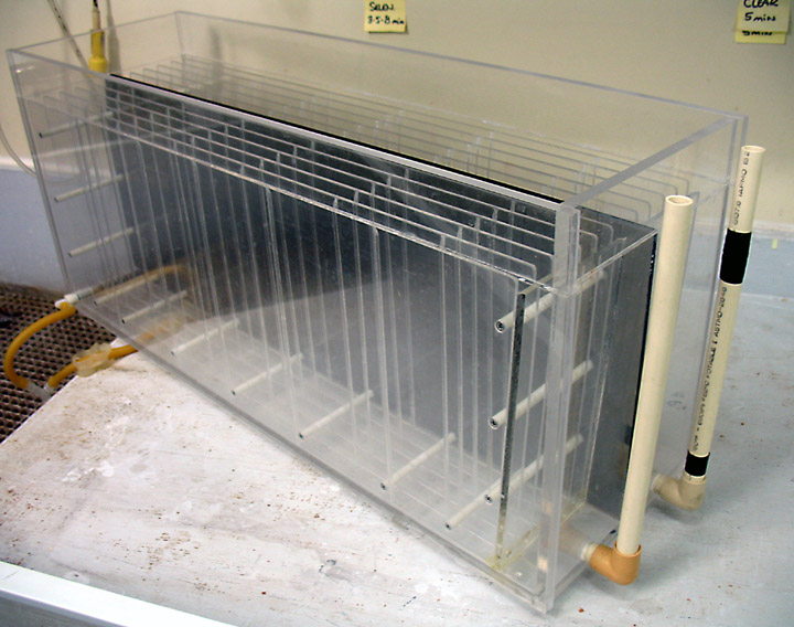

The vertical "archival" washer: (walls are made from 10mm (3/8") acrylic sheet).
The overall dimensions are:
710 long x 310 high x 220 mm wide (28 long x 12-1/2 high x 9 inches wide)
This washer has a central divider, permitting partial operation if only a few sheets are to be washed.
Water can be directed to only one or both sides.
Each side is:
600 long x 100 wide x 250 mm water depth (as determined by the height of the central divider)
Each side has a "basket" holding 5 sheets in individual slots.
The manifolds direct a gentle stream of water into each individual slot.
Double ends, similar to the holding washer as described above, drain from the bottom as described earlier.
Water depth is regulated by rotating the drain pipes.
The baskets are 1.5 mm thick acrylic, separated by acetal tubes and stainless steel screws.
The prints or negatives rest on the bottom spacers, not on the washer floor.
The baskets may be lifted occasionally for agitation.

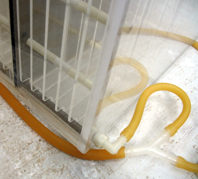

Stefano,
Here are some fuzzy pictures showing details on the washers:
Photo 1 shows the double end arrangement.
The inner wall has some gaps between the wall and the bottom,
The water flows out of the main compartment through the gaps.
Since the incoming water is at the top of the opposite end, there is "cross-flow".
Shallow notches in the top of the outer wall height determines water depth.
This unit will not self-drain if the water is turned off.

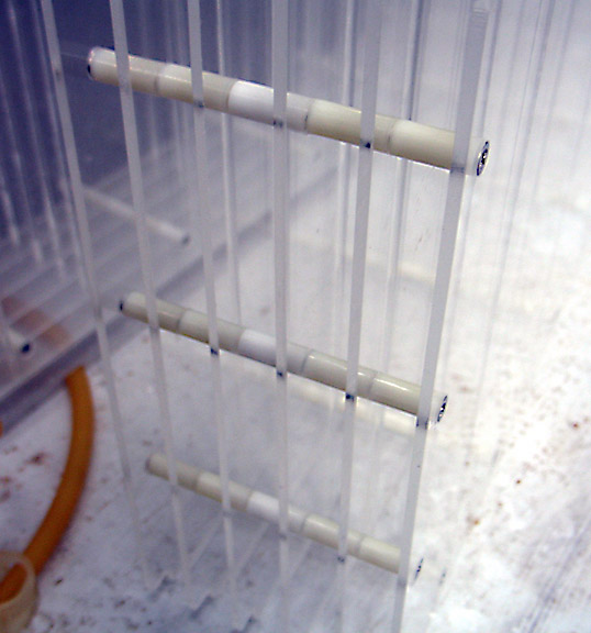

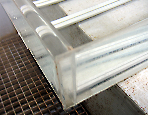

Photos 2 & 3 show the vertical washers print basket assembly details.
The nylon/acetal tubes are "standoffs" (spacers) used in the electronics industry.
The screws are standard US #6-32 size flat head machine screws.
A metric equivalent would be an m3 size.
Instead of the removable basket arrangement, you could create a series of slots at both ends of the main compartment and insert the acrylic sheets directly.
Make the slots so that the sheets can be easily removed if necessary.
Sawed slots are simple, but the end wall plastic must be thick enough.
Alternately, you can use a series of plastic strips to form the slots.
